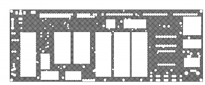

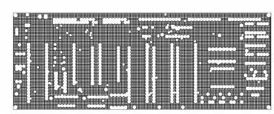

Hi again :)
I've been reeding the "Techniques for reliable high-speed digital circuits" sticky. There is a ton in there and I'm trying to grasp at least some of it. I also learn a lot by doing and getting feedback, so this is my current PCB setup. I split each layer out. Have I made any glaring mistakes?

Posts: 8544
Run the planes between each pair of pads, for much better AC performance, so signals' ground return current doesn't have to veer away from the signal line and go clear around the end of the IC. There's plenty of room to get it between pads.

Joined: Sun Nov 29, 2015 11:19 pm
Posts: 18
I'll set the GND plane clearance to 0.254mm so it goes between all the pads.
