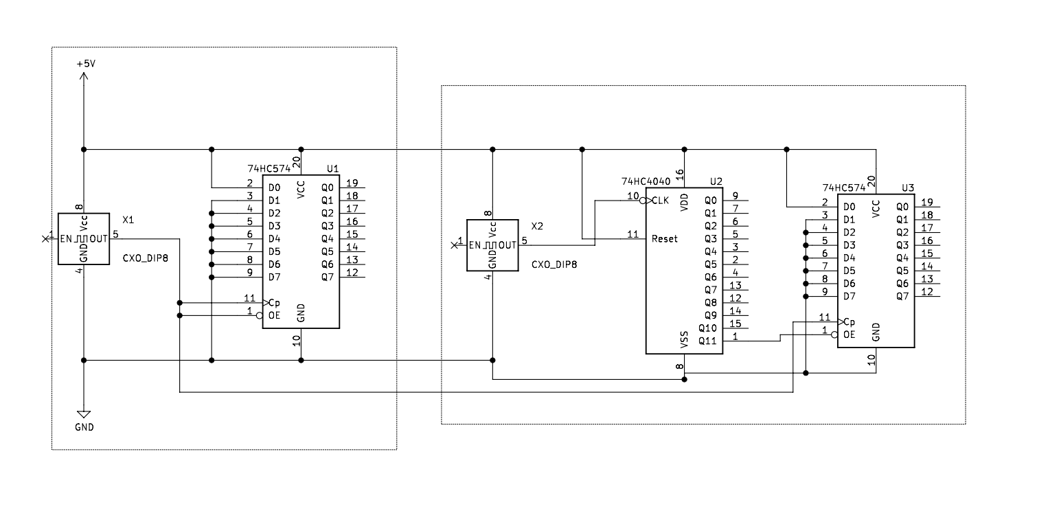

Howdy! I'm trying to use a 74HC574 to hold on to some data bits that should only be visible when the clock is on the low part of the duty cycle (because something else will be on the bus during the high part). I thought I could use the O̅E̅ line for this purpose and simply connect it to the clock line, so that, when the clock is high, the '574 simply disconnects itself from the bus, but somehow I can't get the chip to behave the way I want… when an input is high, the output just stays high all the time.
With an input set high, if I manually connect O̅E̅ to either VCC or ground, I can see the output change, but if I attach any kind of clock signal, no matter how slow (I went all the way down to ~10kHz), the output is always high, rather than following the clock.
I've wired things like this—the diagram on the left is just the oscillator and the '574, while the one on the right includes a 4040 to divide the clock down to slower speeds:
Not quite sure where I'm going wrong… I tried looking at the signal with my 'scope, and everything looks reasonable to me; if anyone has any suggestions, I'd welcome them. Cheers!

Might I be the first to reply? I'm still a newbie, but I've used the '4040 before.
MR (master reset) on the '4040 is high enabled. On your diagram, you have it connected to +5V, thus it's ALWAYS in reset mode, thus the output of the '4040 is always a low.
https://assets.nexperia.com/documents/d ... CT4040.pdf
At least that's my guess?

Thanks Chad—that's a mistake in a hastily-assembled diagram, but good catch. The same problem happens on the left side, where there is no divider anyway, unfortunately.

With CMOS circuits, when you disable the outputs and nothing else is driving those lines from another source, the capacitance in the board, sockets, 'scope probe, etc. will hold the last value for a long time, even milliseconds (not just microseconds or nanoseconds), according to something I observed by accident when I was developing the test for my 4Mx8 SRAM modules. (This is why you don't have to worry about violating the 65c02's hold times on a read operation after phase 2 falls. The data will be held until something else drives the bus.) I did not try to see how much longer I could go. It was just an interesting observation that was not really related to what I was working on.
Thanks, Garth. I actually observed something similar when experimenting—the line would decay very slowly while the bus wasn't being driven, and then get picked up again to 5V when the next cycle came along. I think I'm just using the wrong tool for the job—perhaps, the right way to go about it is to use the '574 as a latch, ignoring the OE line, and then put a bus transceiver like a '245 between it and the bus… I was hoping for once the solution wasn't going to be “more ICs” :-)
CountChocula, is it the data bus of a microprocessor that you intend to connect to? Please explain what it is you're up to.
In case it helps, this diagram shows the internals of a '574. Notice that storing a value is a separate, independent function from turning on and off the output. I don't think you will need more ICs (but I'm not entirely clear on what it is you're up to).

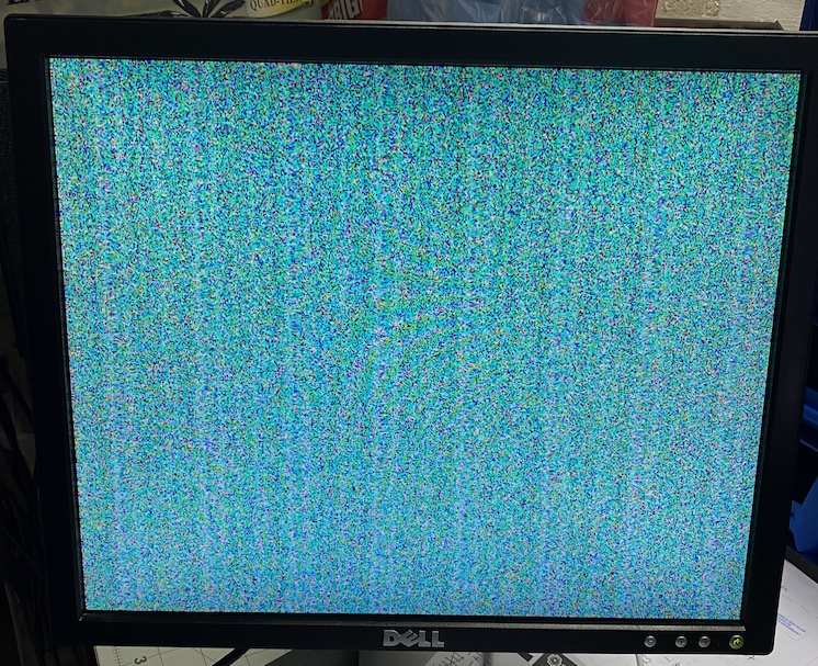

Hey Jeff—I am trying to build a VGA interface for my SBC. So far, I have built the “video” side of the interface, which has its own memory chip and seems to work (at least in the sense that I see a stable image on my monitor—it shows garbage, and I'm hoping it's the garbage that's in the RAM :-) ).

That diagram makes sense to me; if I'm reading it correctly, it implies that the OE line is asynchronous, which means that things should work, but… they don't. No matter how simple or slow I make the circuit (at least down to a few kHz), the output of the '574 seems to ignore the OE line altogether—though I will say that it works if I connect it by hand to ground or 5V. Maybe it's just really slow, like Garth was suggesting, because I have wired things too naïvely?

Let's see if I can clarify this. I was not suggesting the circuit is slow. It's just that when you turn off the output and nothing else is driving the line, the capacitance, even if only 10pF, acts as a sample-and-hold circuit. In fact, that's how sample-and-hold circuits work for analog-to-digital converters. See https://en.wikipedia.org/wiki/Sample_and_hold . The gate is held open while you're tracking an analog input voltage, and when you want to covert it to a digital number, you freeze it at the instant you want, so that that value is held while the analog-to-digital converter is working on the conversion, since it needs that input to be stable until it's done.

A misunderstanding, perhaps. Things may "click" for you if you try the following. Choose one of the '574 outputs and connect it to two resistors, one going to ground and one to Vcc. Value not critical -- 2K to 100K, say (but both resistors the same). Nothing else (except your meter/scope) connected.
You'll see either a high or a low (depending what's stored in the FF) when the output is enabled (/OE low). But when the output is disabled the chip will cease to drive, and the resistors will bring the voltage to one-half of Vcc (overcoming whatever capacitance is present).

Thanks! As I told my friend a couple days ago, I've never been happier to see garbage on a screen :-)

Thanks Jeff—it did click… after sending my last message, I re-read Garth's and had the intuition to add a pull-down resistor to the output, and sure enough things started working the way I expected. This makes complete sense, of course; not sure what I was thinking! I'm going to try wiring a couple '574s to see if I can at least write to the first few rows of pixels.

Very good news! And I love that pic of "garbage", beautiful indeed :) I went back and looked at why you'd want a pull-down resistor, and I also now see why that's important. I need to learn too! Thanks.
