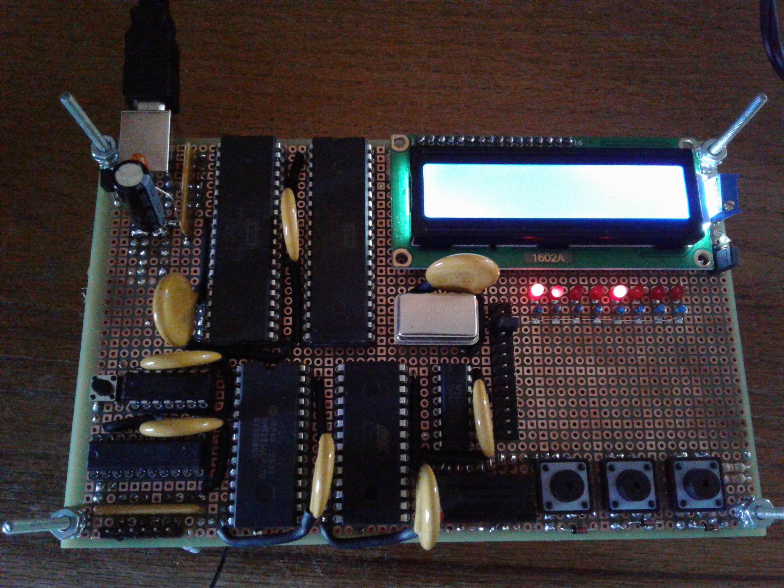

I don't have a lot of extra parts on hand (I'm still new to all of this), and I don't have a ton of money for good testing equipment. But I do have this LM1117 at home from another project, and I have a bit of time until some more capacitors come in.
I think I read that the 28c256 will not WRITE at 3.7V less (or some such), but I heard someone online powering it with a Raspberry Pi's 3.3V so that the output doesn't blow up the GPIO pins when you READ it. Idk.
As with any human, I will only have so much patience with "trying stuff" before I move on entirely, i.e. a printed board.

When you have an unreliable self-built computer, there are several possibilities
- error in the circuit design (glue logic or clock logic is not safe)
*** If it works sometimes, but not every time, it could still be this, but I wouldn't know why. ***
- error in the construction of the circuit (you built something different than you intended to)
*** Again, if it works sometimes, I don't know what could be "wrong" in any logic sense. Maybe I just don't understand. ***
- poor quality in the construction of the circuit (dry joints, bad connectors)
*** Definitely. Tons of grime and whatnot, and I cannot reach anything. ***
- poor power supply quality (not enough bypass capacitors, too much resistance)
*** Capacitors could be the issue, I'm working on that. The USB charger pumps 1.5A and that LCD screen LIGHTS up (when it was still plugged in). ***
- bad component (perhaps damaged by static, or not the component it's labelled as)
*** Yes again. As I was messing around, I saw sparks a couple of times. I theorize my DS1813 might have got the bad end of that deal, as my reset button just WON'T work sometimes. ***
Thank you for reminding me.

When I bring up a new design for the first time, I reach for two things: my clock single-stepper and an EPROM that is nothing but a bunch of NOP instructions. I install the EPROM and a 1 MHz clock oscillator and using a logic probe, watch the address and data lines for signs of life. If I see activity on the buses, it means the MPU is alive and apparently well.
Next, I use a ROM that can do minimal I/O, just enough to blink some LEDs hooked up to various circuit points, or enough to drive a serial I/O connection to which I can attach some sort of display device. If that works, then I can move on to a more elaborate ROM—at that point, it becomes a programming project.
If the beast isn't doing what I expect it to do, I replace the oscillator with the single-stepper and "walk" the MPU through the reset cycle, while observing the address bus and then the data bus for the correct bit patterns. This is practical with the WDC MPUs because they have static cores and thus may be halted without detriment by stopping the clock in either phase. The single-stepping process will almost always identify any problems in the design, such a glue logic error or burning code into the wrong part of ROM. :oops:
It takes a certain amount of practice and experience to get the hang of it, but once you have, it'll become second nature and each build will get easier.

An update on this board:
Bill (plasmo) asked if he could look over the board and test it. I sent it to him, and he found that I had flipped A4 and A11 on the RAM and ROM. If you look at the datasheet, they are right across from one another. I was not careful enough when moving wires from the 6502 downwards.
When Bill flipped those, it worked! That was literally the only thing wrong with it! So why was it only working... sometimes? I don't know, but it works now thanks to Bill. Thank you so much Bill!
Attached are some pictures and a short GIF video. Bill added some LED's to the front, you can see his thin blue wires compared to the fat wires I used.
Well, I learned a LOT from this. Even though my solder work was ok, my wires were crossed! I will be extra careful next time, as well as knowing more how to debug.
As you might know I already have a 4-layer board coming in (eventually), but in the meantime I will be coding this guy. It'd be cool if it can calculate "pi". [ That was going to be my first demo software. ] I'm likewise going to showcase this at the upcoming Math Appreciation Day at the college in the Spring.
Thank you all for your help on this, and thank you again Bill for your kindness to me.
