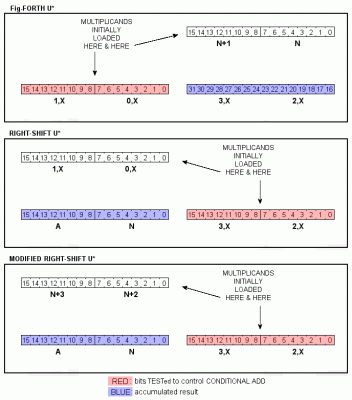

... and a good place to focus attention is the rotates (which happen unconditionally for every iteration of the loop):
.0000010 ror faca+s_long+s_word
         ror faca+s_long
         ror faca+s_word
         ror faca
What's being shifted is a 64-bit value that'll become the result of the 32- by 32-bit multiply. The '816 can manage this 64-bit value with four consecutive R-M-W instructions operating on memory. But R-M-W instructions operating on memory tend to eat a lot of cycles.
In 2005, Bruce Clark aka dclxvi presented a partial remedy, and, inspired by him, I kicked the ball even further. The context was an '02/'C02 routine that multiplied two 16-bit values to yield a 32-bit result, but the same principles would apply for an '816 version that multiplies two 32-bit values to yield a 64-bit result. Just remember that (as with BDD's code) the result gets shifted in four pieces (four quarters).
Bruce's main loop keeps the most-significant quarter in the Accumulator, which is a lot speedier to shift. The other three quarters still reside in memory, but nevertheless it's a significant improvement. Instead of having each iteration of the loop shift...
    Mem3 -> Mem2 -> Mem1 -> Mem0... he shifted...
    Accum -> Mem2 -> Mem1 -> Mem0
My variation uses two successive loops. The first half of the multiply shifts...
    Accum -> Mem2 -> Mem0... and the second half of the multiply shifts...
I know that looks broken. But 25% of the shifting gets eliminated altogether, and all the bits do end up in the right place! (In fact, I ran an exhaustive test to verify this and another optimization. Using the Kowalksi simulator running on Windoze box I verified the result for all 2^32 possible combinations of input values.)
Back in 2005 I made an animation to illustrate (below). What's shown are the shift patterns for...
  • a somewhat clunky left-shift multiply from FIG Forth (intended to sidestep the famous ROR bug?)
  • Bruce's right-shift multiply, and
  • my modified right-shift multiply.
The code and further commentary can be found in the thread UM* (multiplication) bug in common 6502 Forths.
So I see...although I can't see all of it. :D

Based on random input values, it looks as if my modified right-shift algorithm can produce a full 64-bit result in roughly the same time as your routine takes to produce a 32-bit result. I realize Gordon only requires 32 bits, but it'll be interesting to compare the two routines just the same.
Actually, I need the full 64-bits for another operation, MULDIV where the result is
r := muldiv (x, y, z)
with x * y being computed to the full 64-bit value before the divide by (32-bit) z takes place. This is designed to better handle scaled integers amongst other things. However since this isn't a common operation I'm using my original long multiplication for that with a modified divide and it's not changed for some time. It's slow but works fine.
The code below is an 816-ified upscale of the modified-shift '02/'C02 approach I mentioned earlier. Today I opted to present a "plain-vanilla" version because I wanted something that was clear and easy to read. The original version is smaller because it reuses a single loop, but this new version is simpler and bulkier. Also there's no early-exit logic, and my comments don't have the laconic elegance that Mike's do!
I'll have a look and better improve my code to swap between algorithms which is by conditional compilation of my BCPL/Cintcode VM, as well as the benchmark program to use a range of random numbers for a possibly better representation.
