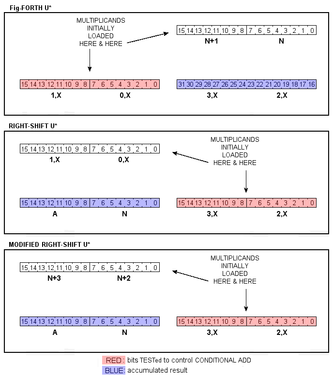

What's being shifted is a 64-bit value that'll become the result of the 32- by 32-bit multiply. The '816 can manage this 64-bit value with four consecutive R-M-W instructions operating on memory. But R-M-W instructions operating on memory tend to eat a lot of cycles.
In 2005, Bruce Clark aka dclxvi presented a partial remedy, and, inspired by him, I kicked the ball even further. The context was an '02/'C02 routine that multiplied two 16-bit values to yield a 32-bit result, but the same principles would apply for an '816 version that multiplies two 32-bit values to yield a 64-bit result. Just remember that (as with BDD's code) the result gets shifted in four pieces (four quarters).
Bruce's main loop keeps the most-significant quarter in the Accumulator, which is a lot speedier to shift. The other three quarters still reside in memory, but nevertheless it's a significant improvement. Instead of having each iteration of the loop shift...
    Mem3 -> Mem2 -> Mem1 -> Mem0... he shifted...
    Accum -> Mem2 -> Mem1 -> Mem0
My variation uses two successive loops. The first half of the multiply shifts...
    Accum -> Mem2 -> Mem0... and the second half of the multiply shifts...
I know that looks broken. But 25% of the shifting gets eliminated altogether, and all the bits do end up in the right place! (In fact, I ran an exhaustive test to verify this and another optimization. Using the Kowalksi simulator running on Windoze box I verified the result for all 2^32 possible combinations of input values.)
Back in 2005 I made an animation to illustrate (below). What's shown are the shift patterns for...
  • a somewhat clunky left-shift multiply from FIG Forth (intended to sidestep the famous ROR bug?)
  • Bruce's right-shift multiply, and
  • my modified right-shift multiply.
The code and further commentary can be found in the thread UM* (multiplication) bug in common 6502 Forths.
So I see...although I can't see all of it. :D

Based on random input values, it looks as if my modified right-shift algorithm can produce a full 64-bit result in roughly the same time as your routine takes to produce a 32-bit result. I realize Gordon only requires 32 bits, but it'll be interesting to compare the two routines just the same.
Actually, I need the full 64-bits for another operation, MULDIV where the result is
r := muldiv (x, y, z)
with x * y being computed to the full 64-bit value before the divide by (32-bit) z takes place. This is designed to better handle scaled integers amongst other things. However since this isn't a common operation I'm using my original long multiplication for that with a modified divide and it's not changed for some time. It's slow but works fine.
The code below is an 816-ified upscale of the modified-shift '02/'C02 approach I mentioned earlier. Today I opted to present a "plain-vanilla" version because I wanted something that was clear and easy to read. The original version is smaller because it reuses a single loop, but this new version is simpler and bulkier. Also there's no early-exit logic, and my comments don't have the laconic elegance that Mike's do!
I'll have a look and better improve my code to swap between algorithms which is by conditional compilation of my BCPL/Cintcode VM, as well as the benchmark program to use a range of random numbers for a possibly better representation.

Hm, here's another possible issue. Might it be that the high 4 bytes of FACA need to be initially cleared to zero? I'm looking at the line that says...
        lda faca+s_long
...and, the first time that instruction executes, it's not clear what's being loaded into A. Still a solid and straight-ahead approach, however.
The note near the top of the code about maximum operand magnitude implies that FACA needs to be zeroed prior to loading it with an operand. Otherwise, as you noted, the high DWORD of FACA would be undefined content and if non-zero, would bugger up the result. The file that contains that code, along with other math functions, has general notes at the beginning about clearing FACA before loading it, as well as a sub that when called, zeroes FACA and then loads it with an operand pointed to by the .X and .Y registers.

This is virtually identical to 1200, which is about what I take Mike's average performance to be. (Correct me if I'm wrong, Mike. I admit I'm confused by the "79 or 104 ticks for i * 0" among your best-case figures.)
I think 1200 might be a bit optimistic for mine. The performance drop as the number of binary ones increases is probably the steepest of the group. The "79" comes from a zero in bit zero of i, and the "104" comes from a one in bit zero of i.
