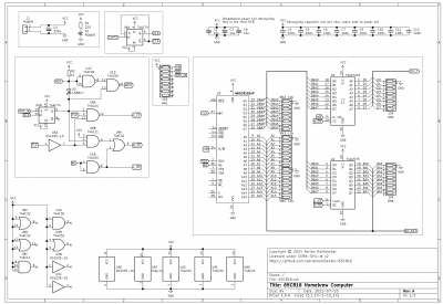

The latest episode is #5, and discusses how to transform the RDY pin into two uni-directional signals, RDY_IN and WAITN. Hope you find it interesting!
This is the current schematic:
BB816 Computer YouTube series

The latest episode is #6 (released a couple weeks ago but forgot to post here!).
In that episode, I add support for RDY in my databus demultiplexing circuit. After decoding it into RDY_IN and WAITN in the previous episode, I can now use this signal to determine if I should open the latch and enable the buffer or not. Had to add a flip flop to register the RDY input so that the glue logic and the CPU are kept in sync, as well as a clock flip flop to make the timings work. I'm pretty happy with the results, but I'm now working on the next episode which will go back on the timings, and (spoiler alert), use a DS1035 delay line to make them work even better.
This is the new logic:
And of course this is the whole new schematic:
Hope you find this interesting!

You should know that the use of the 65C816's RDY input to wait-state a 65C816 with extended RAM presents some not-insignificant problems. While said problems aren't intractable and can be solved if you throw enough silicon at them (and are willing to put up with the resulting propagation delay), they are sufficiently onerous that alternate wait-state methods using clock stretching have been developed and tested. See here for some theory and practical application. Also, see here for a one-chip solution for the 65C02 or a 65C816 without extended RAM.

I'm curious to hear what the problems are with using RDY for wait states?

I believe it's all about latching the upper address bits correctly: hence the pointer to a simple recipe if you don't need to do that.
