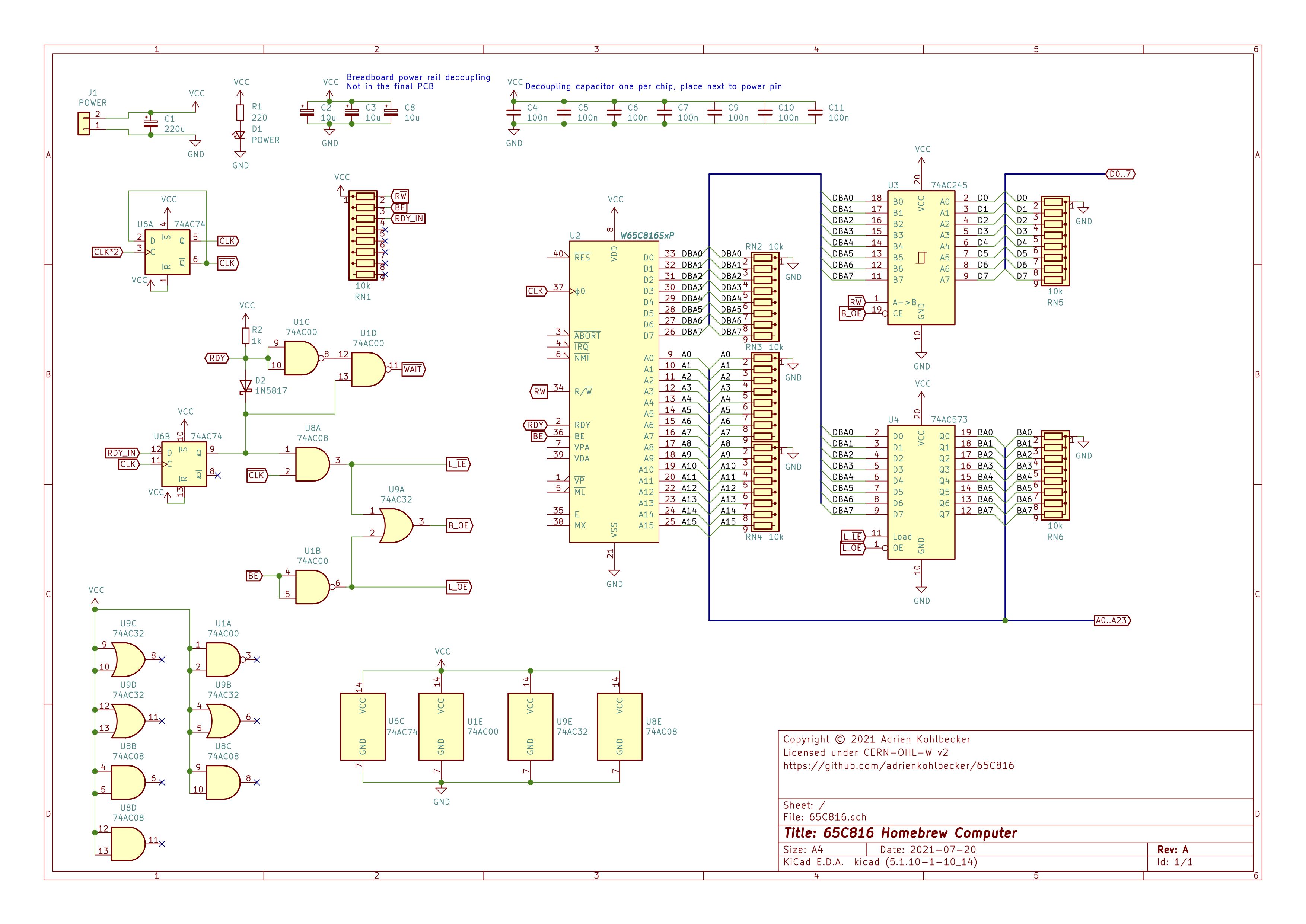

The latest episode is #5, and discusses how to transform the RDY pin into two uni-directional signals, RDY_IN and WAITN. Hope you find it interesting!
This is the current schematic:

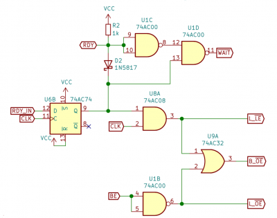

The latest episode is #6 (released a couple weeks ago but forgot to post here!).
In that episode, I add support for RDY in my databus demultiplexing circuit. After decoding it into RDY_IN and WAITN in the previous episode, I can now use this signal to determine if I should open the latch and enable the buffer or not. Had to add a flip flop to register the RDY input so that the glue logic and the CPU are kept in sync, as well as a clock flip flop to make the timings work. I'm pretty happy with the results, but I'm now working on the next episode which will go back on the timings, and (spoiler alert), use a DS1035 delay line to make them work even better.
This is the new logic:

And of course this is the whole new schematic:

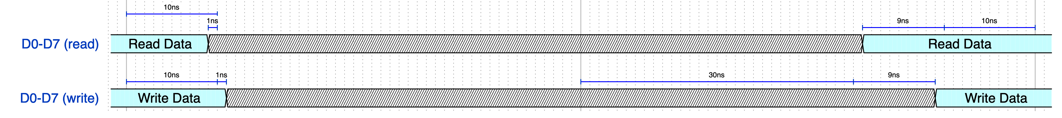

I'm also just done watching episode 7 which reminded me I have a question about read/write timing.
If you take a look at tDSR does that mean that READ DATA must be valid (at 5V) 10ns before the clock falls? If so I assume that means that the 65C816 is constantly latching that READ data internally and needs it to be latched before the clock fall?
Also as tDHR is 10ns does that mean READ DATA actually needs to be valid for at leas 20ns in total (the green line)?

Yes, that is my understanding as well. You need to present the data at the CPU pins 10ns before and 10ns after the falling edge of the clock. Note that the buffer that you add in front of the CPU impacts those timings: in my build using the 74ACT245, I need to present the data to the buffer 19ns before and 9ns after the falling edge of the clock. See this section of my timing diagram

And the whole schematic
