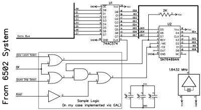

This is how I implemented it.
/QW is a Phi2 qualified write.

The READY signal goes low while the chip is loading in the data. The /CE and /WE pins need to be held low for that period of time too. That's why I used the READY pin to keep them low until it has loaded the data.
