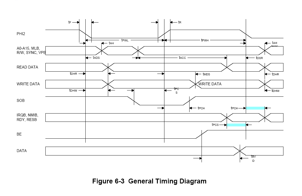

I'm pretty sure you'll find RDY has both a setup and a hold constraint: you won't get away with changing it any time. A flipflop, or two, will easily sync the control signal with the clock.
PostPosted: Fri Sep 17, 2021 1:08 pm
The WDC timing diagram shows that the state of RDY can be changed at any time
(Edit: I see Ed has posted, and he's right to question BDD's statement.) As shown below, tPCS and tPCH apply to RDY, which means there's a brief period in every cycle during which RDY is required to be stable -- ie, either high or low but not in transition. Violations of tPCS or tPCH can cause the processor to go off into lah-lah land.

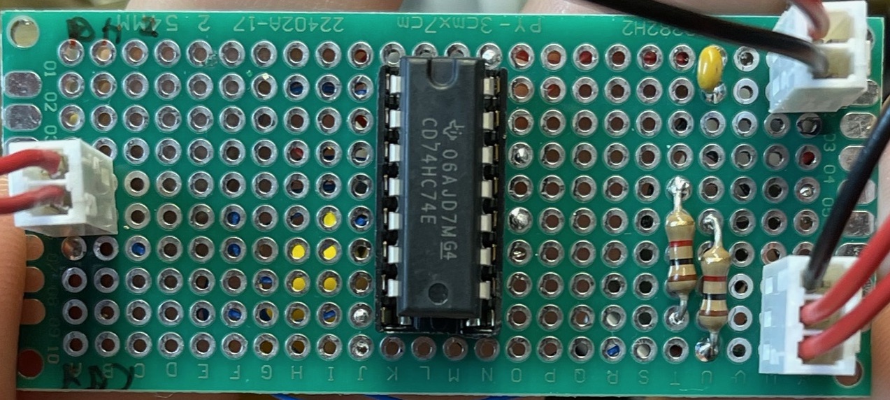

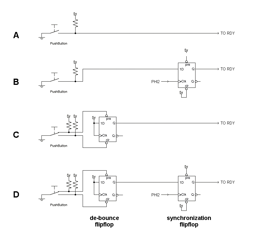

Having said that, if it's just a human activating a pushbutton once or twice then odds are good that the transitions on RDY won't occur during the critical time. So, it's a reasonable gamble to hope the CPU doesn't crash. And perhaps a crash would be tolerable anyway, in the context of Photoman's experiment. You can always run the experiment again, hoping as you say that the CPU will successfully pick up where it left off.
For the record, here's how a 74HC74 can be used both for debouncing the pushbutton -- to prevent multiple responses to a single button push -- and for synchronizing the signal sent to RDY -- in order to ensure that the response(s) respect tPCS and tPCH. You have the option of addressing the debounce issue or the synchronization issue or neither or both.
PS- Photoman, I'm curious about your remark here. Can you elaborate?

Also: BDD may have a point in regard to the following. For example, interrupts generated by the 6522 VIAs won't get serviced promptly.
One possible concern with using RDY to halt the MPU is other parts of the system that are clocked by Ø2 might behave strangely with the MPU stopped but the clock still running.

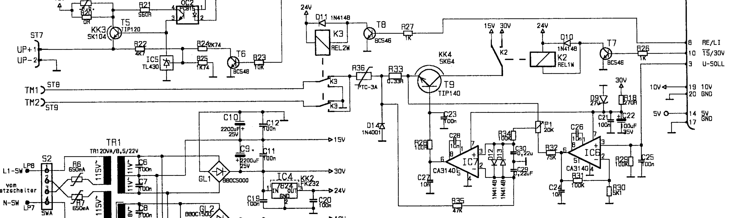

PostPosted: Fri Sep 17, 2021 4:28 pm
Photoman wrote:
Its simple, just a TIP140, couple of op amps and a relay to select from a 3 different voltages for the speed.
I think you can expect the relay status to remain unchanged when the CPU is stopped. Thus, an experiment seems unnecessary. But by all means go ahead if that's your inclination!

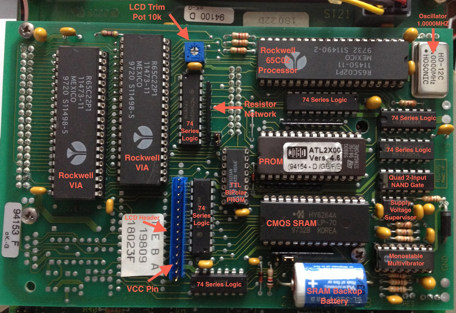

I want to stop the motor and the timer (MPU) so I can take the drum with the film off the machine.
For a process like B&W reversal where you need to take the film out, shine it under light for a prescribed amount of time.
Then put it back in the processor to continue with other steps like bleaching, fixing and washing.
The other options are less interesting. Just shutting the machine off, run the off line processes and then starting a different program for the rest of the steps.
It would work but they only give you a set number of programs (12) that the processor can run. All are customizable but ive run out of them.
You can set times but no stops or pauses. A much older model did have pauses but they omitted that in the programing for the later ones.
The user programs are stored in a HY6264A 8Kx8bit SRAM. Im guessing space was limited to store more programs.
I will definitely test for problems with the Ø2 and 6522s. Hopefully not going to be an issue...famous last words I know!

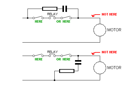

PostPosted: Fri Sep 17, 2021 7:06 pm
Photoman wrote:
I could add a switch to interrupt power to the motor.
Yup. Just be aware that interrupting power to an inductive load results in voltage spikes that can be large enough to be destructive. Because the relay interrupts power the machine probably has some sort of protection network to deal with this -- a MOV or TVS or an RC snubber circuit.
As shown below, this will be either in parallel with the motor or in parallel with the relay contacts. If you add another switch, put it in one of the indicated spots in the circuit, immediately adjacent and in series with the relay contacts.
Or, instead you may find it easier to interrupt the 5 volt signal from the 6522 VIA to the transistor/whatever that drives the relay coil. This sidesteps the snubber issue, and also you'll be able to use just an inexpensive, low-current switch.

PostPosted: Sun Sep 19, 2021 2:28 pm
Photoman wrote:
The rotation motor is fed from the power supply board and not marked in a way that would make sense to me.
I suspect the parts that look like op amps are actually optocouplers, used to isolate the 5 volt logic circuitry from the AC mains. Do you have any schematics you can share? Remember, on this forum you're allowed to include attachments with your posts. Also, if you have any photos of the film processor and its electronics I'd be curious to see them.

I bet it'd possible to add another memory chip to augment the first. The idea is you'd have a switch, and by flipping it you'd have available either the 12 programs in one chip or 12 more in the other. It'd be a finicky job to accomplish this, but not very complex.
Though non-trivial, it'd probably be doable to alter the programming and add that feature to your machine. How much "fun" do you think you could survive? :)
That was the first idea that jumped to my mind as well. Stacked memories with the chip select pins bent out and wired to a small add-on circuit or just a simple SPDT switch.

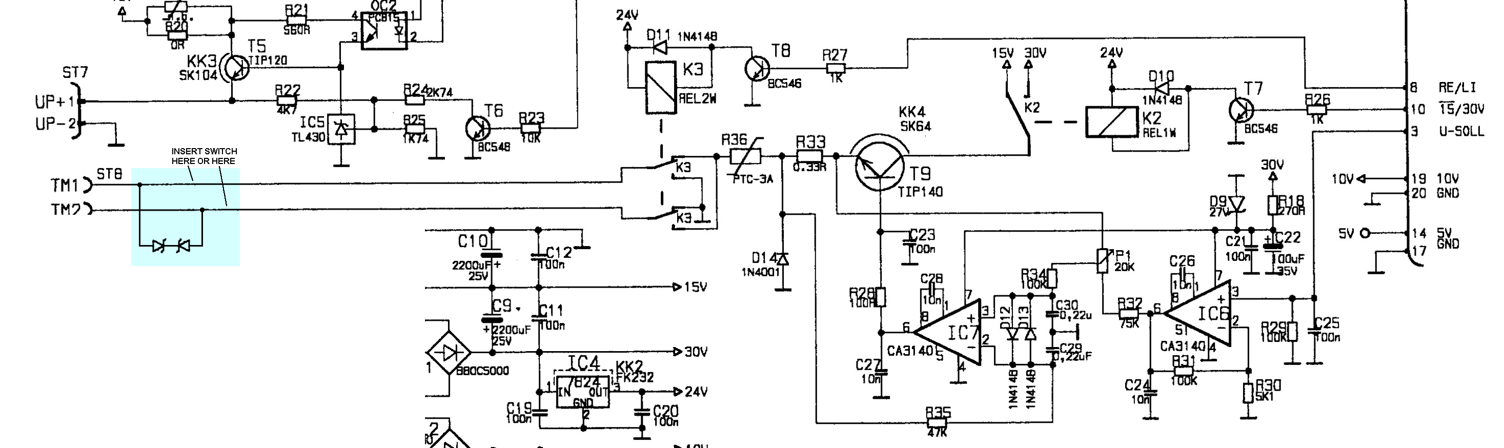

Hi Jeff,
Thanks for the tip. Not going to be easy to break in anywhere other than the motor wires.
Couldn’t I stick a 1N004 or 7 between the motor wires and break both the + and - ?
Shouldn’t that act as a freewheeling diode and dissipate the energy?
Or would the motor current be an issue. It has a 3A PTC protecting it. I do have some 6A diodes in stock.

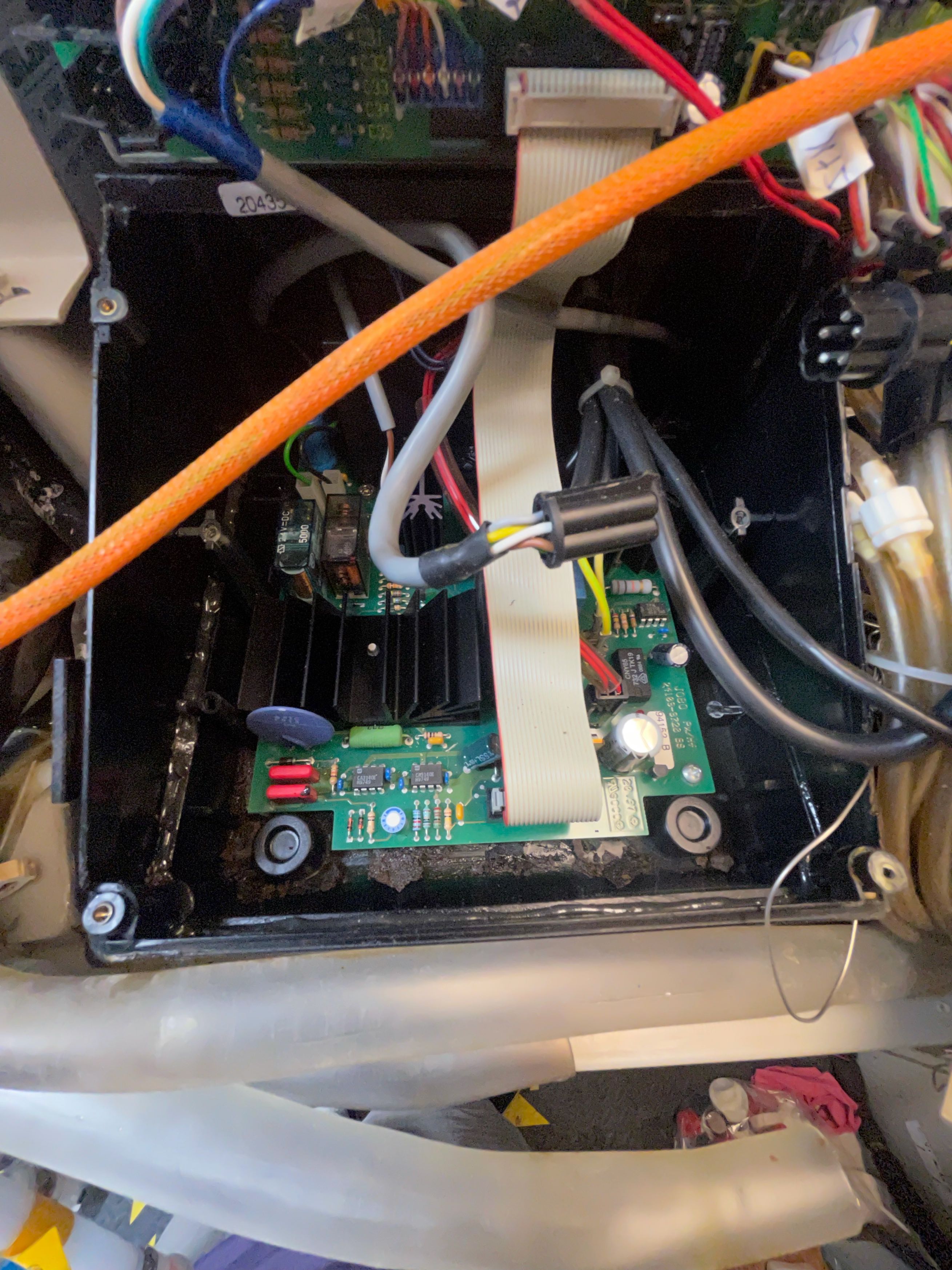

I did try to break in to the control but of course its not that simple. I have attached a pic of the schematic for the driver.
TM1 and TM2 are the motor wires. On the right is the input connector and pin 3 is speed control. Tried to break that (before I knew what it did), didn’t work.
Re/Li I Pin 8 I believe is the left right rotation selector for the reversion relay. That just leaves pin 10 which comes from another board.
Its fed from a 74HC574 octal d type flip flop. The cable between the boards is a 20 some odd pin ribbon cable.
Unfortunately no resistor to pull on that board to make it easier. Im trying to avoid removing the power supply module.

Hi Jeff,

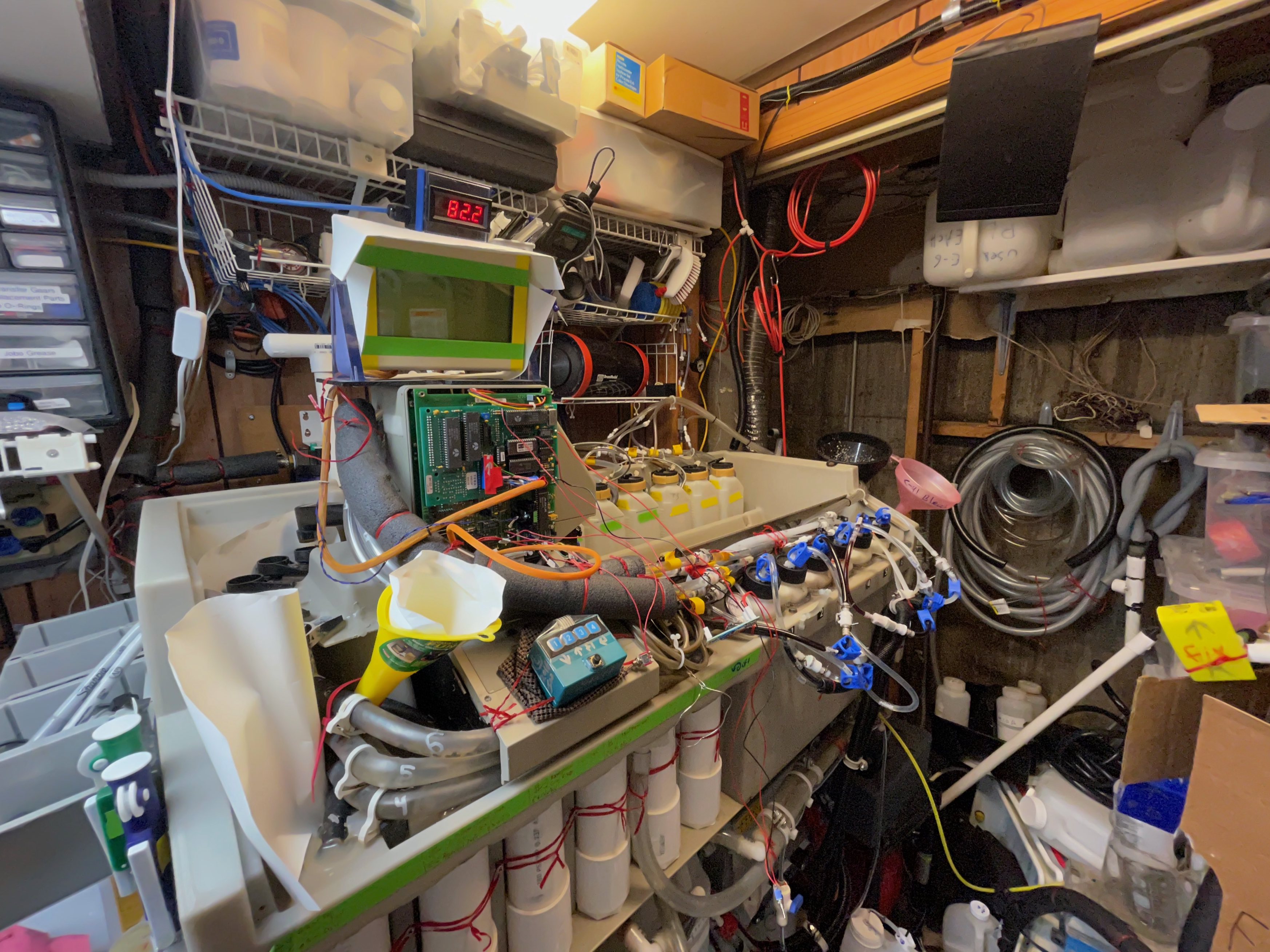

Pictures of my labor of love attached. She started life out as a stock Jobo ATL 2200 then I got to her!
Id estimate only 50% is original now. I ungraded her to a 2300. Built my own replenishment system out of peristaltic pumps and an Arduino.
Added the giant display, because of the height the machine needs to be at to drain and me being on the vertically challenged end of things, this display is worth it.
Also made my own keyboard with a reset button. The OEM failed, probably in the laminations or the carbon tracks.

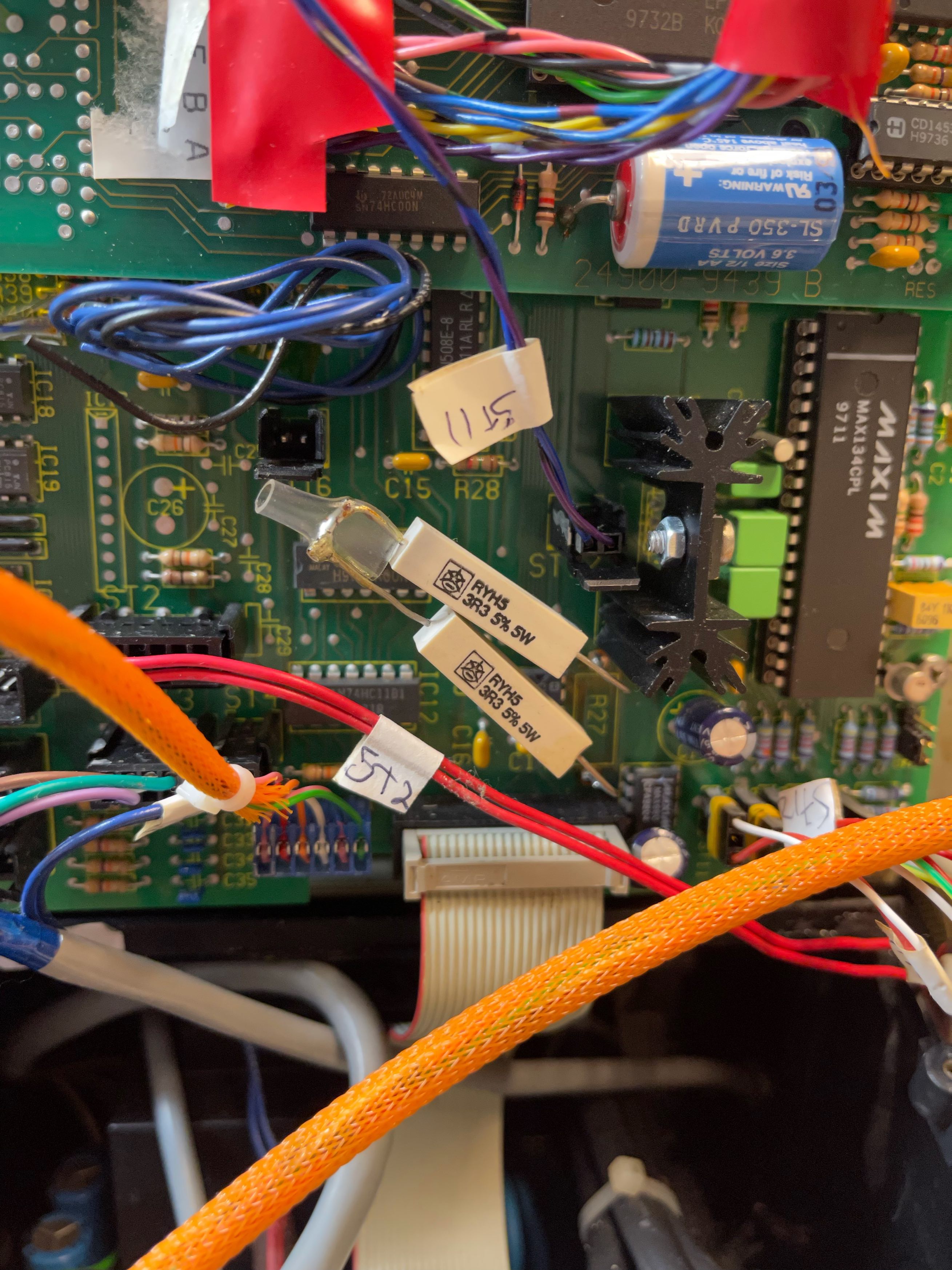

Oh I had to add those 5W resistors to the board because the original couldn’t handle the voltage drop of the bigger screen. It looked pretty fast so I replaced them for safety.
The op amps are CA3140's. No opto's on the driving side. They have optos for other inputs and outputs but not the motor.
I guess they just assume the PTC will handle it and they're separated by relays.
I had thought of piggybacking another SRAM but never got around to it. Re entering everything is a massive pain with only 4 buttons and twice!
I know if I want to add back in the pauses or anything else, its decompiling the binary. That’s out of the wheelhouse for now.
That was a really neat solution to an interesting problem. Most of the processors ive used have either thermistors, PT100s or the dreaded all in one break mains modules.
Ive done hot swaps and its not fun. If you're fast, you can unscrew it, put your hand over the now gushing chemistry then quickly slide a new sensor in.
Most of the chemistry is no worse than the stuff under your sink, don't get in your mouth or eyes, wash after.
Last explosion I had was a few years ago, the bleach line ruptured and I had a fountain cover me. E-6 is more or less not very toxic, just sticky and stains.
Wasn’t the first time and im sure wont be the last!

Here is the flip flop with debounce that Jeff showed me how to make.
It works! And depending on when you activate it, very interesting things happen.
As surmised it doesn’t turn the motor off but it does stop the clock...sort of.
When you resume, it resets to the stating point of that particular step.
Im guessing that maybe it does a write to the SRAM per step but not the exact timing or whatever was stored in the register was lost.
Either way its good like this. I can just set it up as a wash step and once I get the motor to stop, this should work.
Thanks again for the help!
Yes, I was afraid of that. But the good news is, I was mistakenly assuming the motor was powered by the AC Mains -- 115VAC or whatever. Hence my remark about opto-couplers. Low voltage DC will be a lot easier to deal with -- we can easily concoct our own protection and locate it further downstream.
I see there's a reversing relay ( K3 ), which means we need to accommodate either polarity. Here's what I suggest:
At a guess, I'd say 2 watt zeners should be comfortably adequate, given the transient nature of the surge. The zener voltage needs to be well above the 30 volts seen in normal operation, so you could choose zeners rated at 40 or 50 volts, say. I wouldn't exactly call these freewheeling diodes, although they do serve to dissipate the energy.
Looking at the rest of the circuit, it seems IC7 is sensing and limiting motor current, as reflected by the voltage drop across R33. Further upstream, IC6 accepts a signal from pin 3 on the connector. Am I right in saying that's a 5V logic signal? Here a possible explanation. I suspect the current limit is there to protect your film and the gears in case of a jam-up. Limited current means limited torque. But the motor won't start reliably when the current limit is enforced; the motor needs extra current to get going from a stop. The logic signal gives it a temporary increase in the limit.
Edit: Hm, if indeed the current limit needs to be suspended for starting, then you may encounter difficulty when using the new manual switch. Opening the switch will surely stop the motor, but closing it again perhaps won't be enough for the motor to restart.
