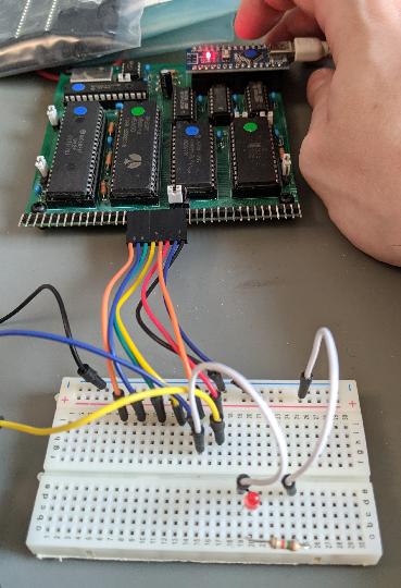

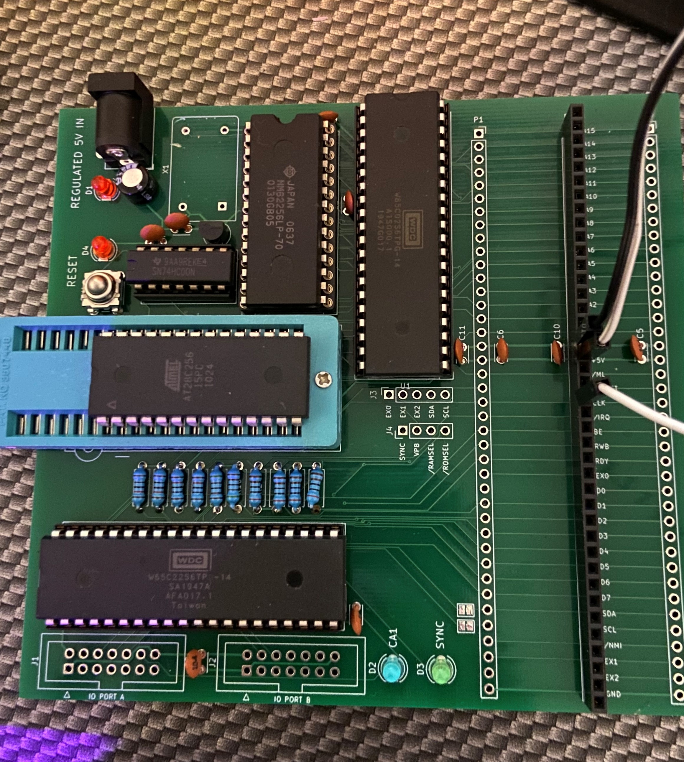

Back to the main board -- It arrived, and it works!
I got the onboard CA1 LED blinking within a day. I initially soldered a can osc directly to the board and it was not clocking the CPU (no action on Sync or anything else). Once I pulled the can up and pushed a clock signal down the bus, we were in business. I'm not sure if the can was bad, or if I have a mistaken footprint for it. I'll further troubleshoot if it was the part or my design.
My 14-pin IDC sockets all went missing, so new ones are ordered and that will fill out the obvious missing bits of the board.
I do have a long list of minor layout adjustments to make before I spin a final "Version 1" but hopefully can draft that all up this week. I still need to dedicate the time to putting all the kicad files and their outputs on the web. I generated an interactive HTML BOM that makes assembly much easier.

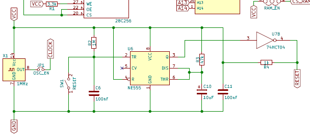

Ah! I think I'll call it the A1SBC. Close enough, even if it kinda skips over it being both a clone (rather than a replica, despite the name) and an RC6502 system.
Anyway, it uses a standard 555 monostable multivibrator, or one-shot. (Schematic attached.) I was confused earlier about how it held reset low as long as you held the button (i.e., it has a minimum but not a maximum pulse width), but of course that's how a debouncer has to work, doh, as the switch may be bouncing as you hold it.

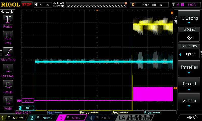

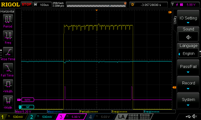

I'm attaching some photos from an oscope trace of turning the board on. Due to the layout, it's not very easy for me to probe the pins directly on the DS1813. So, acknowledging that the SYNC will lag a few cycles behind leaving reset. On the trace, blue is the 5v supply, pink is SYNC, and yellow is RESET. This is all from the same power on, I've just zoomed a bit to show interesting things on the main trace.
At a high level. You can see 5v applied, a bunch of noise around the reset coming up, and then finally it makes it and we start syncing.
RESET starts to rise a few times but never makes it.
Actually, it makes it once...
This is a DS1813+10 so the typical trip point is 4.35V. It looks like the power source gets up to 5V pretty quickly, and doesn't dip back down.
https://github.com/Individual-Solid/
