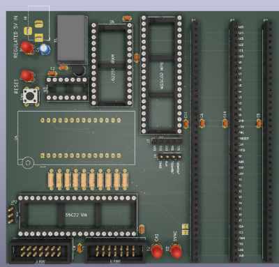

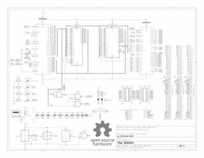

Using the lessons from my first 6502 PCB, the F-1 and my ongoing discussion of the RC6502 bus, I put together a design for an SBC with a modified "RC6502" expansion bus. I'll continue to work on revising the F-1 as a board with only 6522 driven expansion, but I wanted to also design a board that offered up the signals for experimentation and even expansion at the CPU-bus-level. This will limit the clock speed, but even 4MHz would make me happy.
The design goals for the system are as follows:
  • Allow folks who have purchased the Ben Eater breadboard kit move their software (and even the ICs) to a more durable PCB.
  • Still leave access to all address, data, and meaningful control lines for "newbie experimentation" (I can imagine an Arduino Mega based "Monitor" expansion card)
  • I would love to sell this as a kit on Tindie (not for meaningful profit, but there's a dearth of modern 65c02 kits available, and this is a hobby I'd love to share). I mention this up front, your knowledge may be productized but in the hopes of teaching to even more people.
Much like the F-1, the design is primarily the Garth "Potpourri" circuit, with the following choices selected from the circuit options:
  • Clock option chosen is the Can Oscillator. Reset circuit chosen is DS1813.
  • Because of these choices, an 74HC00 can be used for address decoding instead of the '132 (chip included in BE kit)
  • Permanently configured for the WDC65c02 processor, 28C256 EEPROM.
  • Simplified IRQ/NMI selector for the onboard 6522 VIA, since both processor lines are always tied up.
Additionally, we've got a Power LED, Reset LED, Sync LED, and CA1 of the 65c22 VIA is connected to an LED. Pull ups on the "Tx/Rx" make them ideal for I2C lines (but there's a pad you can cut to disable). For the CPU signals not on the bus, there is a male pin header to test them or jump them to unassigned bus lines. There's a female pin header for the unassigned bus lines.

Definitely still working on the silkscreen (I'd like to make it rather informative), and I'm fine tuning the layout, but I do think that this is approximately the layout I'm hoping for.
Any feedback on the board, design, idea, etc, is very welcome!

PostPosted: Sat Aug 14, 2021 8:50 am
Joined: Sun Dec 27, 2020 11:12 pm
Posts: 94
Location: France
Looks great, but If the female headers on the right hand side are your expansion connectors, they seem very close together. It doesn’t look like the boards could have high components like DIN or audio plugs. Even socketed chips would seem like a tight fit.

PostPosted: Sat Aug 14, 2021 5:21 pm
Joined: Fri Jun 25, 2021 5:38 am
Posts: 72
Well, that's a very good point, jfoucher! I was trying to smoosh the board down and went too hard. I'll spread those out. I have an Stephen Cousins RC2014 modular backplane and I can steal dimensions from that.
Garth mentioned in a PM that I should probably switch the RESET LED to be illuminated when RESET is low, not when it's high. I definitely agree.
Thinking about adding another set of pads at the RAM chip to allow for skinny ram without making a converter.
One version of the layout had all the resistors underneath the socketed 65c22 and 65c02s, but the width of the 40-pin connector left plenty of room to put the resistors in their own courtyard.

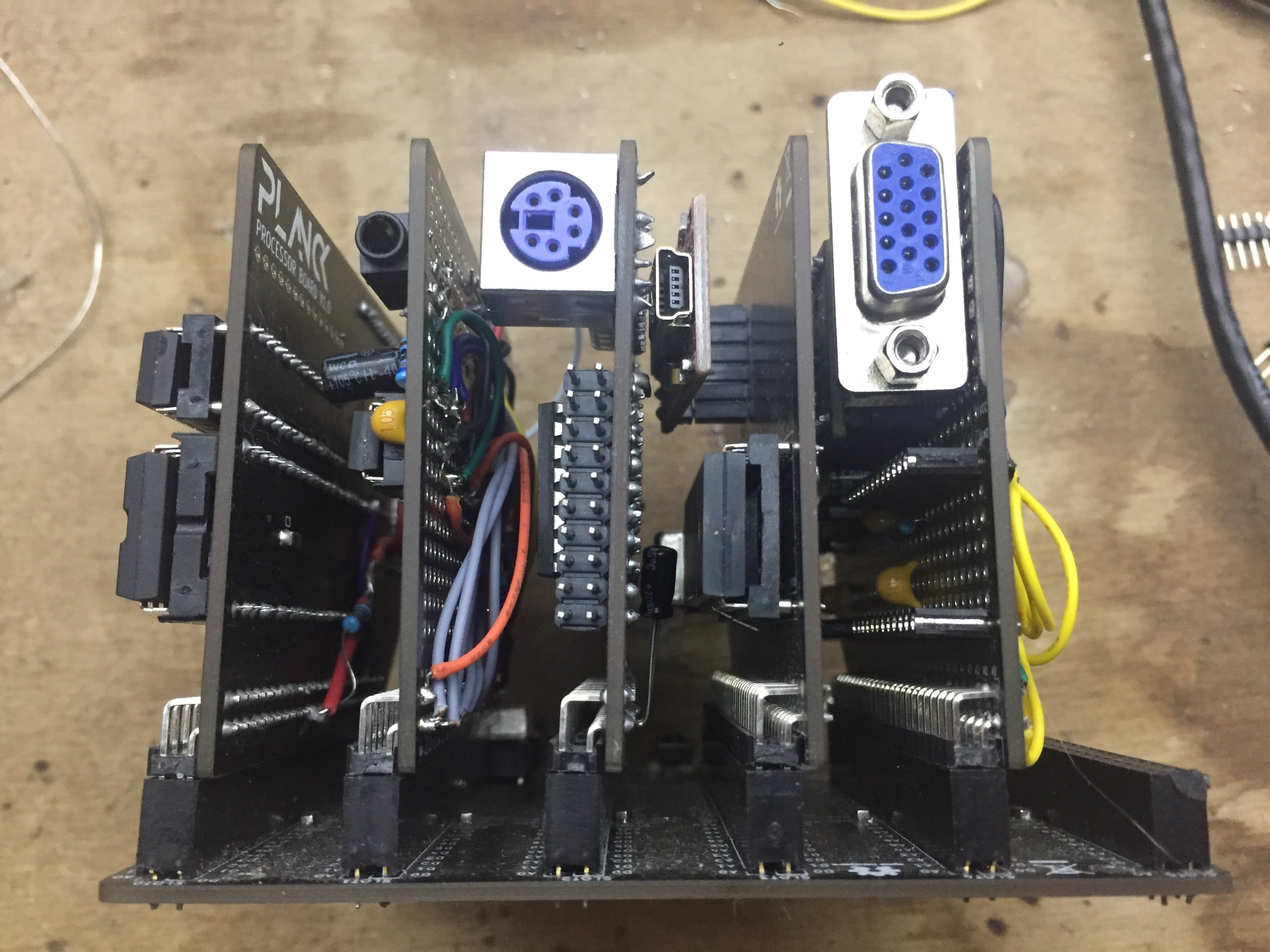

PostPosted: Sat Aug 14, 2021 5:36 pm
Posts: 197
On the spacing, here's a side on view of one of my projects, the 0.9" spacing between the boards os just about enough to fit an IDC header and leave room for the cable.
The chips in sockets its just under the half inch from the top of the chip to the very end of the leg on the other side of the board.
Possibly a little over 0.6" for the VGA socket.

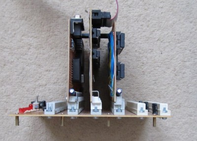

PostPosted: Sat Aug 14, 2021 6:40 pm
Posts: 94
Location: France
And here's mine, about 19mm on centers. Most things fit, but sometimes a bit tighter than I'd like. I've actually shorted the back of one board a few times.

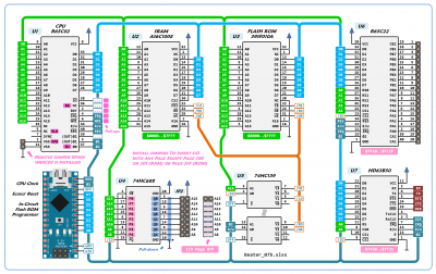

PostPosted: Sun Aug 15, 2021 8:25 am
Posts: 588
May I mention the SST 39SFxxx series Parallel FLASH ROMs in PDIP package as an alternative to the AT28C256 EEPROM? The 128-KiB 39SF010A is $1.47 at Mouser or $1.52 at Digikey while the AT28C256-15PU EEPROM is $10.75 at Mouser or $10.66 at Digikey (15-Aug-2021). Example (untested) designs below.
Cheerful regards, Mike
