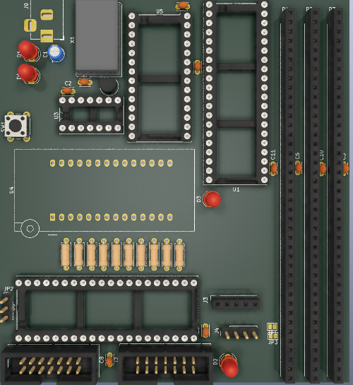

Using the lessons from my first 6502 PCB, the F-1 and my ongoing discussion of the RC6502 bus, I put together a design for an SBC with a modified "RC6502" expansion bus. I'll continue to work on revising the F-1 as a board with only 6522 driven expansion, but I wanted to also design a board that offered up the signals for experimentation and even expansion at the CPU-bus-level. This will limit the clock speed, but even 4MHz would make me happy.
The design goals for the system are as follows:
  • Allow folks who have purchased the Ben Eater breadboard kit move their software (and even the ICs) to a more durable PCB.
  • Still leave access to all address, data, and meaningful control lines for "newbie experimentation" (I can imagine an Arduino Mega based "Monitor" expansion card)
  • I would love to sell this as a kit on Tindie (not for meaningful profit, but there's a dearth of modern 65c02 kits available, and this is a hobby I'd love to share). I mention this up front, your knowledge may be productized but in the hopes of teaching to even more people.
Much like the F-1, the design is primarily the Garth "Potpourri" circuit, with the following choices selected from the circuit options:
  • Clock option chosen is the Can Oscillator. Reset circuit chosen is DS1813.
  • Because of these choices, an 74HC00 can be used for address decoding instead of the '132 (chip included in BE kit)
  • Permanently configured for the WDC65c02 processor, 28C256 EEPROM.
  • Simplified IRQ/NMI selector for the onboard 6522 VIA, since both processor lines are always tied up.
Additionally, we've got a Power LED, Reset LED, Sync LED, and CA1 of the 65c22 VIA is connected to an LED. Pull ups on the "Tx/Rx" make them ideal for I2C lines (but there's a pad you can cut to disable). For the CPU signals not on the bus, there is a male pin header to test them or jump them to unassigned bus lines. There's a female pin header for the unassigned bus lines.
Definitely still working on the silkscreen (I'd like to make it rather informative), and I'm fine tuning the layout, but I do think that this is approximately the layout I'm hoping for.
Any feedback on the board, design, idea, etc, is very welcome!

Looks great, but If the female headers on the right hand side are your expansion connectors, they seem very close together. It doesn’t look like the boards could have high components like DIN or audio plugs. Even socketed chips would seem like a tight fit.

Well, that's a very good point, jfoucher! I was trying to smoosh the board down and went too hard. I'll spread those out. I have an Stephen Cousins RC2014 modular backplane and I can steal dimensions from that.
Garth mentioned in a PM that I should probably switch the RESET LED to be illuminated when RESET is low, not when it's high. I definitely agree.
Thinking about adding another set of pads at the RAM chip to allow for skinny ram without making a converter.
One version of the layout had all the resistors underneath the socketed 65c22 and 65c02s, but the width of the 40-pin connector left plenty of room to put the resistors in their own courtyard.

I'm attaching the latest rendering of the updated layout, with the expansion headers on 15mm centers, which is what I measured off my SCC backplane.
I'll admit, I'm flirting heavily with the idea of switching to a "z50" inspired bus, which would be a 2x25 (or, maybe actually 2x28 to get some more gnd signals in there) pin header. This is a little more mechanically secure and also could get the board down to 100x100. More discussion about the bus options are going on in the thread I linked in the first post.
I may just fab the board with both header options and see "how it feels".
