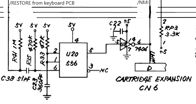

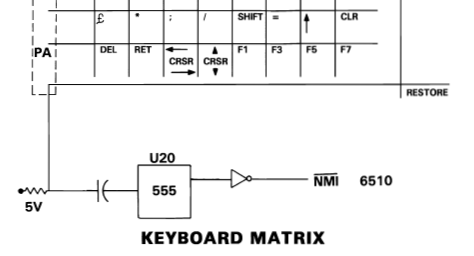

Actually, I think I misspoke. My intention was to only have one true /NMI and the idea was to tie it to a keyboard. But the more I think about that, the more it doesn't really make sense. I was thinking you could press some keyboard sequence (much like the RESTORE key on C64) to interrupt just about anything and return to BASIC. I think it does make more sense to tie it to a "monitor" button. So pressing it would load a system monitor or something similar.
That is, in fact, exactly how the RESTORE key on the C64 works. That "key" is not part of the regular key matrix (and not scanned) but is a momentary switch with its own separate output that is debounced before being fed directly to the NMI line. (The NMI routine does something along the lines of reinitializing the I/O and then checking to see if the STOP key is also currently pressed, indicating it should restart BASIC at the input routine as well.)
I've attached below the diagrams from the C64 service manual showing the keyboard matrix side and block diagram (the vertical line at "RESTORE" is connected to ground above) and the circuit on the motherboard that debounces the switch (the /NMI line has a 3k3 pullup on it that's not on this fragment of the schematic). You might be able to get away with something simpler from Garth's reset circuits page, but at least some of the Commodore designers—Bil Herd for certain—were firm believers that a 555 or similar one-shot was absolutely necessary for reliable resets and NMIs. (If you're uncertain about your choice of circuit, you could use their technique of producing ten thousand machines and testing each one.)
Using NMI as a "soft reset" to recover from programming errors or similar seems to be a fairly common technique. As well as being used on Commodore machines and BDD's boards, it's also used in my (6800-based) National/Panasonic JR-200: the "BREAK" key on that keyboard is part of the regular keyboard matrix, but that matrix is scanned by a microcontroller that generates a separate NMI output when that key is pressed, rather than putting the key code into a register as it does with all the other keys. I seem to recall that the KIM also had NMI on a debounced switch.
The Apple II used RESET instead for this, freeing NMI for other purposes. To determine whether a reset was a cold or warm start it had a checksum for a vector in the zero page, using that if the checksum was ok or doing a complete machine initialization if it was not. The downside of this technique is that unlike an NMI you don't get the previous program counter and flags pushed on to the stack, which you might want if you're interrupting running code in order to debug it.

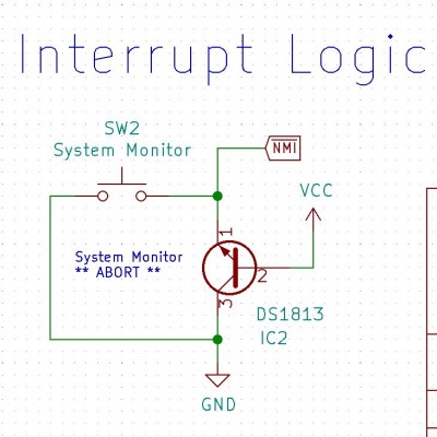

Thanks everyone for the suggestions. I've convinced myself to use /NMI for a "hardware abort" or debug switch. But instead of using a 555, I thought I would use a DS1813 instead. Which are a little pricey but saves board space.

I see DS1813 being mentioned several times and looked it up. Far as I can tell, it is same as the 50-cent MCP130 that I use in about every board design except it is 5 times more expensive. So why DS1813?
PostPosted: Sat Aug 07, 2021 5:16 pm
Posts: 1385
Well, for what it's worth, the DS1813 also provides for a manual reset switch. It's simply wired from the reset output to ground. When pressed and released, the DS1813 performs the hold time again, same as power on.
According to the MCP130 datasheet, this is not the case. Perhaps it also provides a reset timer when using a switch the same way, but I don't know.
PostPosted: Sat Aug 07, 2021 6:21 pm
Posts: 1120
Ah, that is a difference between mcp130 and ds1813. It is possible to add reset push botton to mcp130's reset (it is open drain with internal 5k pull up), but the reset is not stretched for the nominal 250ms, it is not debounced, in fact. To generate manual reset that stretches for the nominal 250ms, the reset button should connect to the VCC terminal of mcp130 and the VCC terminal should connect to 5V supply through a 1K or so current limiting resistor.
PostPosted: Sat Aug 07, 2021 9:40 pm
Posts: 8514
In other words, two parts are required to do the work of one. :D
