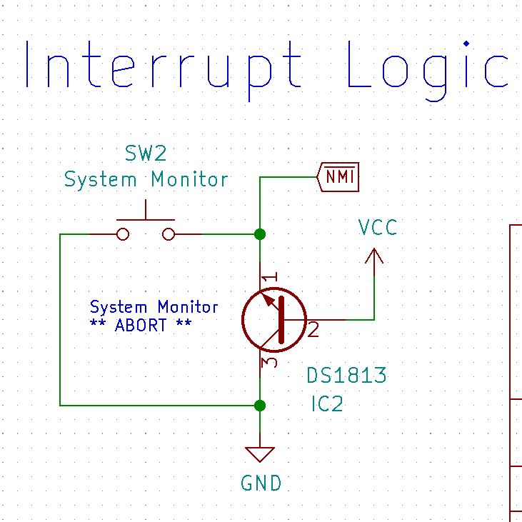

Thanks everyone for the suggestions. I've convinced myself to use /NMI for a "hardware abort" or debug switch. But instead of using a 555, I thought I would use a DS1813 instead. Which are a little pricey but saves board space.

I see DS1813 being mentioned several times and looked it up. Far as I can tell, it is same as the 50-cent MCP130 that I use in about every board design except it is 5 times more expensive. So why DS1813?
Well, for what it's worth, the DS1813 also provides for a manual reset switch. It's simply wired from the reset output to ground. When pressed and released, the DS1813 performs the hold time again, same as power on.
According to the MCP130 datasheet, this is not the case. Perhaps it also provides a reset timer when using a switch the same way, but I don't know.

Ah, that is a difference between mcp130 and ds1813. It is possible to add reset push botton to mcp130's reset (it is open drain with internal 5k pull up), but the reset is not stretched for the nominal 250ms, it is not debounced, in fact. To generate manual reset that stretches for the nominal 250ms, the reset button should connect to the VCC terminal of mcp130 and the VCC terminal should connect to 5V supply through a 1K or so current limiting resistor.
In other words, two parts are required to do the work of one. :D
