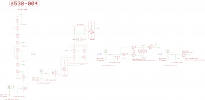

0) cheat sheet
A very simplified schematic to give an overview about what came out during the dissection.
Note:
Latches labeled FSTL are fully static transparent latches (built around a RS flipflop).
Latches not labeled FSTL are dynamic transparent latches (just a FET switch plus some trace capacitance).

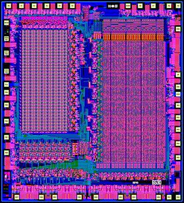

A picture of the 6530 silicon, with the interesting areas marked according to the cheat sheet.
Don't worry because the RAM and the ROM lack any details in the cheat sheet and in this picture,
we are getting there later.
Just as a reference, another picture of the 6530 silicon without the markings.

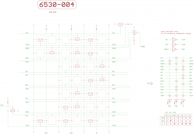

3) RS0
RS0 is an address decoder input signal.
The high_active RS0 input is sampled with PHI1 into a fully static transparent latch,
which gives out the low_active RS0i# signal that goes to the address decoder PLA.
//'i' like in 'Input'.

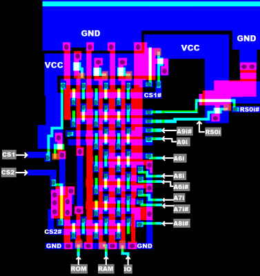

6) CS1 latch
The CS1 latch is a fully static transparent latch, which samples PB6 at PHI1,
and gives out the high_active CS1 signal to the address decoder PLA.
Similar to the CS1 latch,
the CS2 latch also is a fully static transparent latch, which samples PB5 at PHI1,
and gives out the high_active CS2 signal to the address decoder PLA.
Both latches are located between the RES# pad and the RAM block.

12) PLA
(mask) programmed logic array (PLA), also known as "the address decoder".
Mask programmed as in "customer specific".
It decides, where ROM, RAM and IO (including Timer) show up in the 6502 address space.
Located high up North, between A5 pad and R/W# pad.
Basically, we have three NOR gates:
One for selecting ROM: fed by CS1, CS2, RS0i. //CS1#, CS2#, RS0i# respectively.
One for selecting RAM: fed by CS1, CS2, RS0i, A6..9i. //CS1#, CS2#, RS0i#, A6..9i# respectively.
One for selecting IO: fed by CS1, CS2, RS0i, A6..9i. //CS1#, CS2#, RS0i#, A6..9i# respectively.
Where CS2 is supposed to be A12, CS1 is supposed to be A11, and RS0 is supposed to be A10.
//The A0..9 input buffers emit A0..9i (high_active) and A0..9i# (low_active).
We have three inverters, generating CS1# from CS1, CS2# from CS2, and RS0i from RS0i#.
For those who are new to the game:
In the polygonized chip picture, red is diffusion layer, green is PolySi layer, blue is metal layer.
Where ever green crosses red, that's the active region of a FET, and green is the Gate of that FET.
So the PLA was mask programmed by changes in the diffusion layer.
