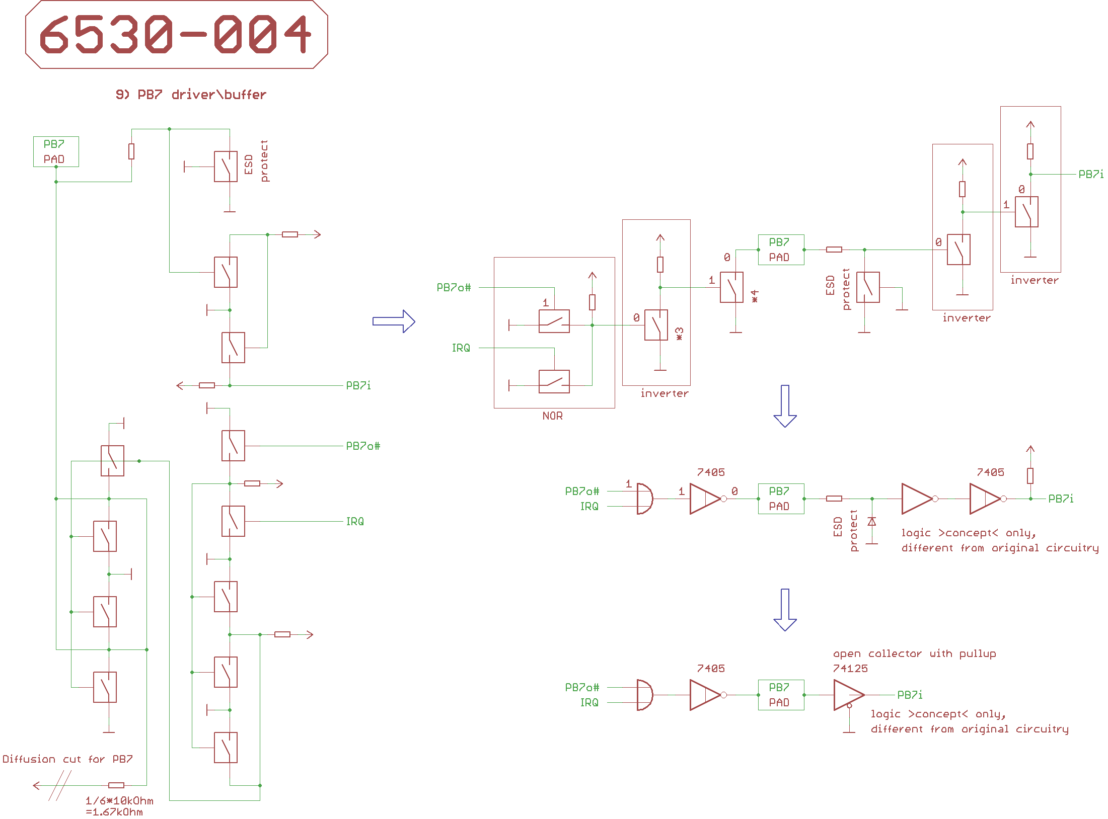

PA0 and PB0 have push/pull outputs for driving darlington transistors etc.
PA1..PA7 and PB1..PB7 have open_drain outputs with integrated pullup resistors.
However, there is a mask programmed option to disable the PB5 and PB6 output drivers
and to use PB5 and PB6 as inputs for the address decoder.
PB7 is supposed to be used as a Timer underflow IRQ# output, and it lacks the pullup resistor.

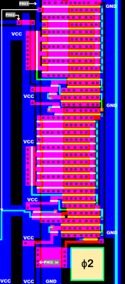

1) clock generation
Nothing special in there.
However, it should be noted that PHI2_in also directly and unbuffered drives quite some circuitry on the chip.
6530 PHI2_in has 30pF typ. input capacitance, for a NMOS 6522 20pF typ. would be normal.
When using multiple 6530 (or 6532) chips in a system,
it probably would be a good idea to keep an eye on the total capacitive load of the 6502 PHI2 output driver
(and on the 6502 propagation delay PHI0_in to PHI2 output, which might be different for rising and falling edge of the clock).

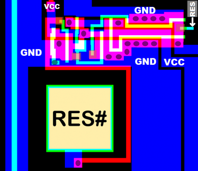

2) RESET
The low_active RES# signal from the pad goes through an inverter, then through a non_inverting super buffer,
and becomes the high_active RES signal (which puts the chip into a RESET).
Note, that the 6530 RESET is fully asynchronous, and not sampled with the clock.
Means, a glitch on RES# to logic low level at any time most likely will cause a RESET.
RES clears the PRA and PRB IO port data registers.
RES clears the DDRA and DDRB IO port data direction registers, configurating the PA0..7 and PB0..7 IO port pins as inputs.
But be aware: RES does not affect the timer, the Timer Interrupt flag, the prescaler, and the prescaler factor.
RES makes sure that PB7 is not pulled low while RES is active.
RES also sets the latch for the PB7 interrupt generation to "disabled".
But if there is something like an accidental Timer read during the RESET sequence of a 6502,
A3i could enable PB7 interrupt generation, and then there might be a falling edge on PB7 in the wrong moment...
For more details, please see "16) Timer control".

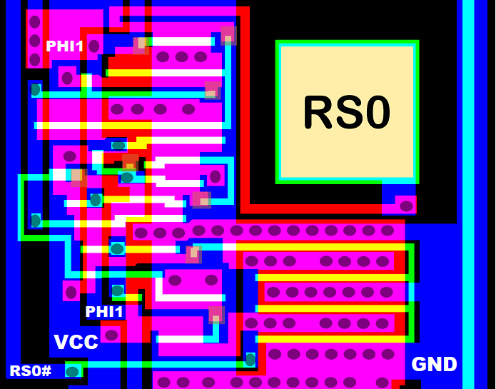

3) RS0
RS0 is an address decoder input signal.
The high_active RS0 input is sampled with PHI1 into a fully static transparent latch,
which gives out the low_active RS0i# signal that goes to the address decoder PLA.
//'i' like in 'Input'.

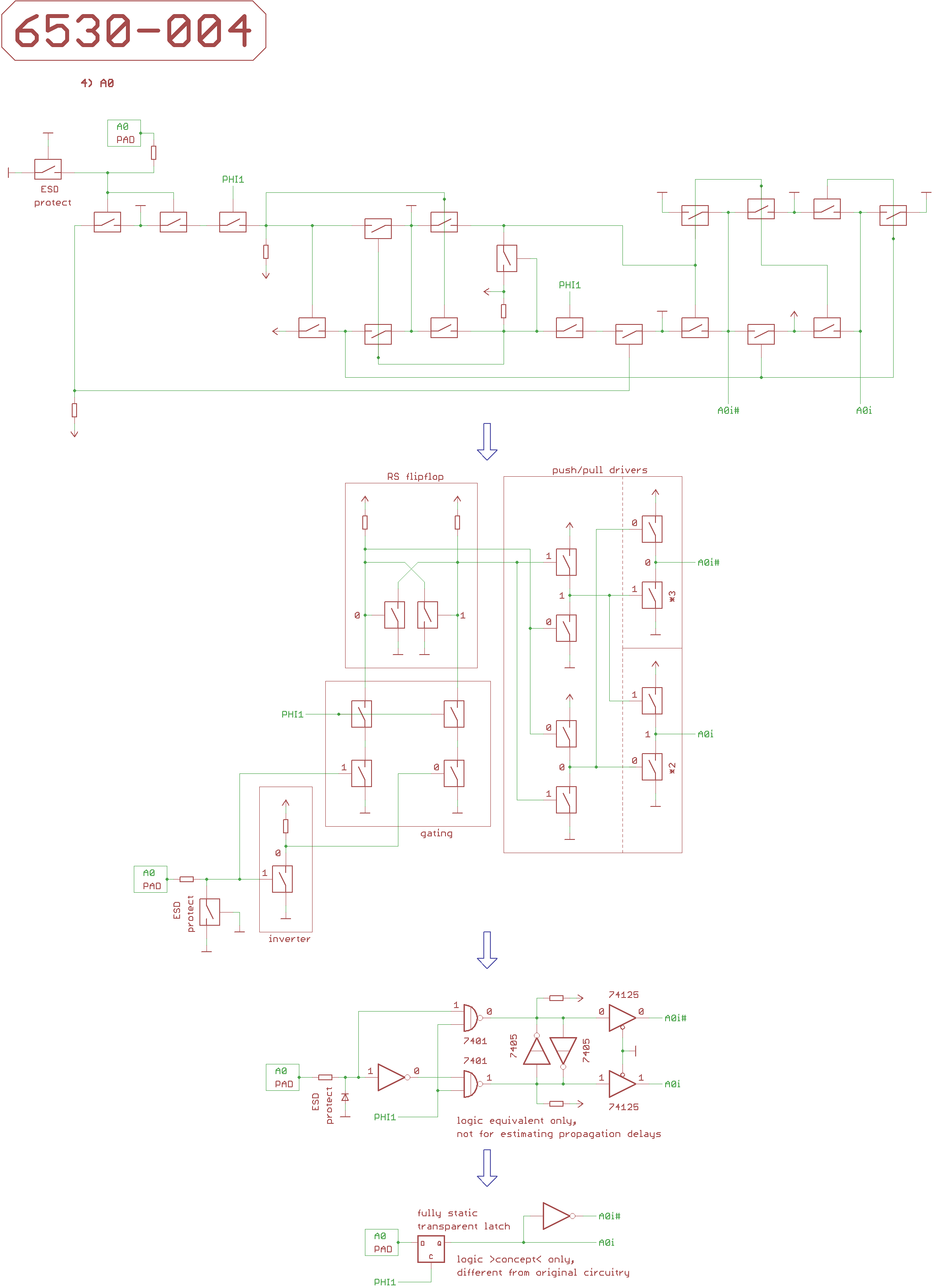

4) A0
Like RS0, high_active A0 from the pad is sampled with PHI1 into a fully static transparent latch.
A special thing is, that the latch feeds push/pull output drivers which generate
the low_active A0i# and the high_active A0i.
When taking a look at the chip layout, it appears that big transistors are located between the address pads.
They somehow look like output drivers (for external signals) to be found in other chips,
but they are driving the internal address lines inside the chip instead.
I think it's a good/clever idea to re_use an output driver structure/topology for driving internal address lines
to deal with the capacitances build up by the RAM and ROM address decoders.

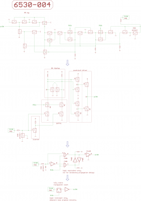

7) R/W#
R/W# (high=read, low=write) is sampled with PHI1 into a fully static transparent latch,
which feeds a push/pull driver generating W/R# (high=write, low=read).

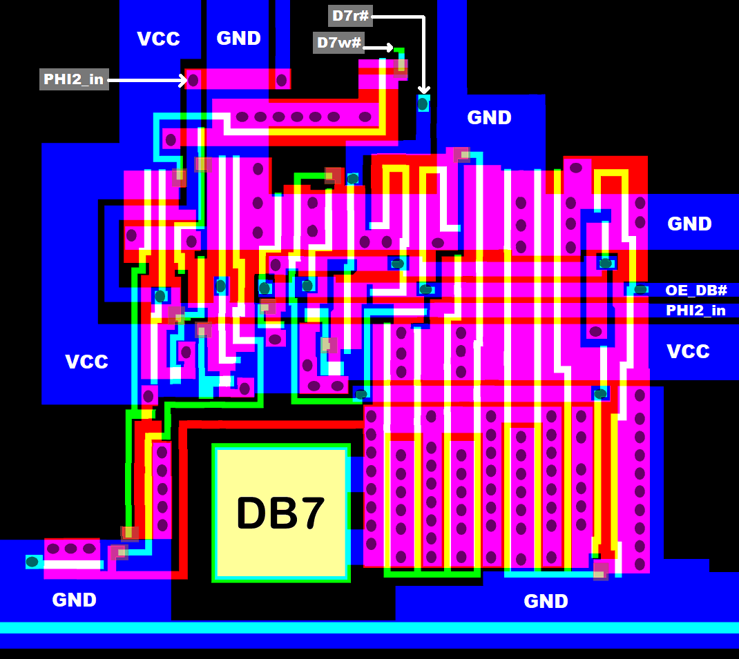

8) DB7
Overview:
DB0..7 external data bus pads (high_active).
Internal write data bus D0..7w# (low_active) when writing registers.
//Internal write data bus D0..7w (high_active) is generated by super buffers located South in the IO logic block.
Internal read data bus D7r# (low_active) when reading registers.
//The read data bus is precharged during PHI1 with FETs located South in the Timer block.
Layout for the DB0..6 circuitry is pretty similar to DB7, so we only take a look at DB7.
On the input side, the high_active DB7 pad is sampled with PHI2_in into a fully static transparent latch,
which feeds a push/pull driver generating the low_active D7w# signal for the write data bus.
//Note, that the PHI2_in signal controlling the DB0..7 latches comes directly and unbuffered from the PHI2_in pad.
On the output side, the low_active OE_DB# control signal enables the inverting DB7 push/pull driver
which takes the low_active D7r# signal from the read data bus and emits it in high_active form
on the external DB7 data bus pad.

9) PB7
PB7 is an open drain IO port signal, which lacks a pullup resistor.
In addition to being an IO port signal,
it also works as a (low_active) Timer overflow interrupt output,
supposed to be tied to the IRQ# pin of a 6502.
The PB7 pullup resistor (FET) is present in the chip layout,
but the diffusion layer between the pullup and VCC is cut.
I think that's because if the PB7 pads of multiple 6530 chips are tied to IRQ#,
and every 6530 would have a PB7 pullup resistor,
the resulting impedance of all the PB7 pullup resistors in parallel on the IRQ# line
would be too low for a 6530 PB7 output driver to pull down IRQ# to a logic low level.
Not much to say on the output side:
if PB7o# is high OR IRQ is high, the output driver pulls PB7 low.
//For logic high level, you need to add an external pullup resistor between PB7 and VCC.
In the IO logic block, PB7o# is the output of a NOR gate fed by data bit PRB7 and data direction Bit DDRB7#.
If PRB7=0 (data Bit low) and DDRB7=1 (PB7 is output), PB7o# is high, and PB7 is pulled to GND.
The high_active IRQ signal is generated in the Timer control block.
//IRQ can be enabled/disabled with A3 during Timer reads/writes.
If it's enabled AND if the Timer Interrupt flag is set, IRQ is high, and PB7 is pulled to GND...
...by ignoring the PRB7 and DDRB7 Bits.
On the input side, the PB7 pad signal goes through two inverters, becomes PB7i and goes to the IO port logic,
IO port logic places it in inverted form on the D7r# read data bus when reading data register PRB,
we are getting there later.
Note, that the PA0..7 and PB0..PB7 input signals are not latched at PHI1, the CPU reads them directly,
we are getting there later, too.

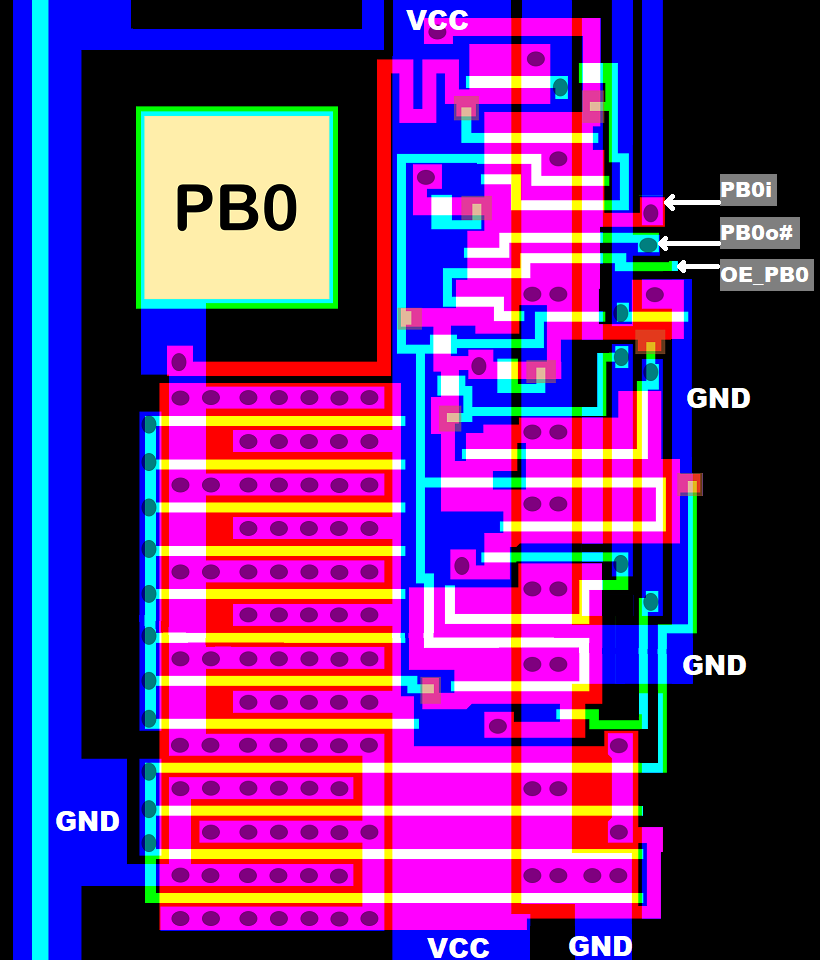

11) PB0
PA0 and PB0 have a pullup resistor (FET),
but unlike PA1..7 and PB1..7, PA0 and PB0 have true push/pull output drivers.
PA0 and PB0 are meant to source 3mA for driving darlington transistors and such.
PA0 and PB0 circuitry layout is different to make better use of chip space,
but electrically they are identical, I checked.
So we now focus on PB0.
On the output side:
PB0 output driver is enabled by DDRB0=1 (when PB0 is configurated as an output).
PRB0# which goes into the output driver is the low_active output signal of the PRB0 data register Bit.
When DDRB0=1:
If DDRB=1 and PRB0=0 (PRB0#=1), the output driver pulls PB0 low.
If DDRB=1 and PRB0=1 (PRB0#=0), the output driver pulls PB0 high.
And that's all there is to it.
The input side is more complicated:
There is a danger that the voltage at PB0 doesn't reach logic high level
when the PB0 driver has to source a lot of current.
That's why we have sort of a 2:1 multiplexer controlled by DDRB0 (data direction register Port B).
The multiplexer generates PB0i, which goes to the IO port logic,
IO port logic places it in inverted form on the D0r# read data bus when reading data register PRB,
If PB0 is configurated as an input, PB0i is generated from the PB0 pad.
If PB0 is configurated as an output, PB0i is generated from the data register Bit PRB0.
//I'm simplifying things a bit here.
Note, that the PA0..7 and PB0..7 input signals are not latched at PHI1, the CPU reads them directly,
