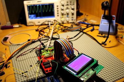

Haven't done much with this in a little bit, but finally felt like chipping away at it today. Refined things a little this afternoon.
I came to the realisation that I make my connections 'semi loosely' standard, so I was able to ditch the cabling between the RAM board (which also acts as the systems ROM) and dump the board directly on top of my CPU board. Guarantees no bad connections and should have a much cleaner signal.
The ribbon cable you do see there is just going to my homebrew logic analyser. Later on I can just unplug that part of it entirely.
I'm still not qualifying my writes here, so that's next. A lot less visual noise to mess with now, so I'll be in a better mindset for it. :D
ThePhysicist
Posts: 60
Joined: 17 Jun 2020
Re: The J64C (version 0)
Post by ThePhysicist »
Is that a lego baseplate?
J64C
Posts: 239
Joined: 11 Jul 2021
Post by J64C »
Haha! Yes it is. Best prototyping gear there is! :lol:
