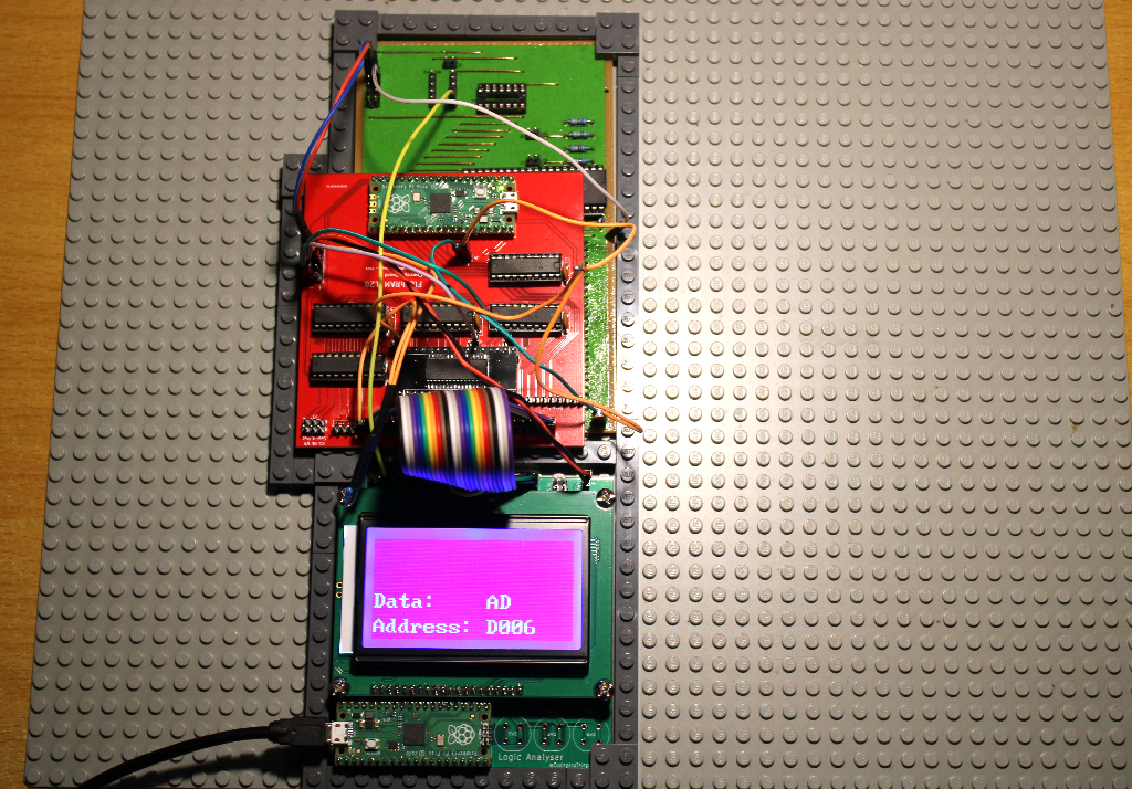

Haven't done much with this in a little bit, but finally felt like chipping away at it today. Refined things a little this afternoon.
I came to the realisation that I make my connections 'semi loosely' standard, so I was able to ditch the cabling between the RAM board (which also acts as the systems ROM) and dump the board directly on top of my CPU board. Guarantees no bad connections and should have a much cleaner signal.
The ribbon cable you do see there is just going to my homebrew logic analyser. Later on I can just unplug that part of it entirely.
I'm still not qualifying my writes here, so that's next. A lot less visual noise to mess with now, so I'll be in a better mindset for it. :D

Is that a lego baseplate?
 Post subject: Re: The J64C (version 0)
PostPosted: Wed Jul 28, 2021 8:12 am
Posts: 155
Haha! Yes it is. Best prototyping gear there is! :lol:

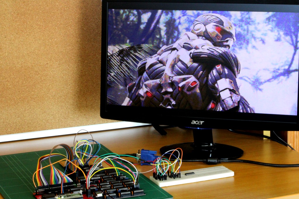

Started re-attaching my video card boards bit by bit to this project today. It has a 25.175 oscillator can, which I have going through a clock divider which allows easy access to clocks down to 1.5MHz. So did a bit of testing.
1.5 MHz - Works! Cool.
3.125 MHz - Still works. Nice!
6.25 MHz - Yep! Great!
12.5 MHz - Which is my target clock rate. Stable! Awesome!
Hmmm. Do I dare 25 MHz? Of course! Haha! :lol:
25 MHz - Running stable for the past hour! Freaking awesome!!! 8)
Still wring the video card up bit by bit, testing as I go. But I am super happy with the progress going on here.

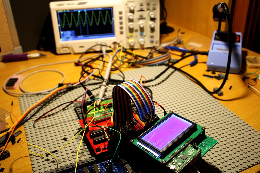

Been a while since I worked on this. So I started getting my head around where I was at.
Did some fine tuning on the graphics board today and am very pleased with the progress. Still as of yet to get to the point where my CPU talks to it though. One step at a time!
I'm probably going to move straight on to using a W65C816 as memory requirements of my graphics board is an issue (unless I crush the resolution, which I don't really want to do).
