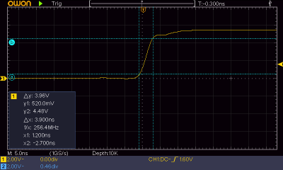

Cool thanks!
When you say 10% to 90%, do you mean 0.5v to 4.5v in this case? Just to get a better understanding on standard terms.
 Post subject: Re: The J64C (version 0)
PostPosted: Thu Jul 15, 2021 2:01 am
Posts: 155
So more like this?
I almost feel like I'm not at the level I need to be to participate in this particular forum. :oops:
PostPosted: Thu Jul 15, 2021 2:13 am
Online
Posts: 8544
J64C wrote:
So more like this?
Yes.
