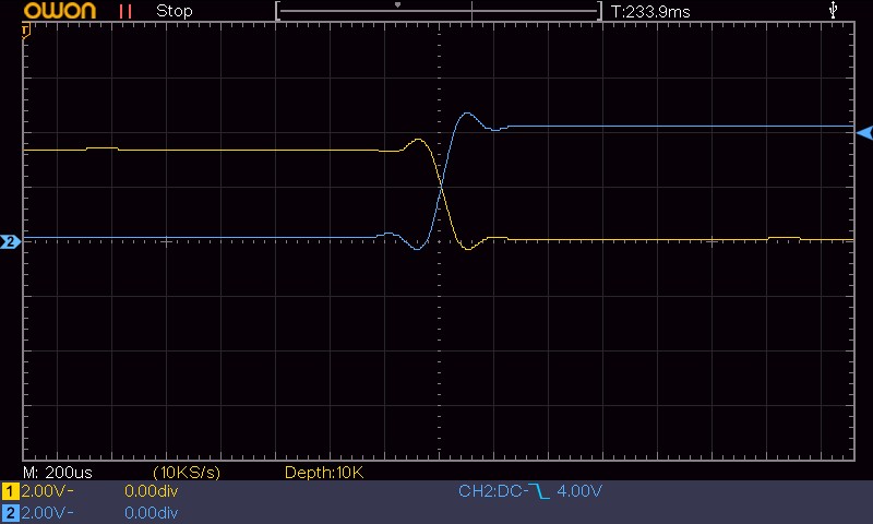

I keep seeing posts about making sure that write operations are 'qualified' against PHI2. With examples of how to do so, like below.
Is this a 'do in all circumstances' thing or are there just certain situations where this should be done. Because when I monitor the write operation on the scope, it seems that the write terminates at the same time PHI2 goes low, which seems valid (to my uninitiated mind) to me.
So I am wondering what the purpose is of qualifying the write operation?

This is from about 70% of the way down the 6502 primer's address-decoding page:
    You must have a way to make sure RAM cannot be written when Φ2 is low! [...] Looking at the 6502's timing diagrams in the data sheet, you will see that the address lines are not guaranteed to be valid and stable before the R/W goes low; so it is possible to write to unintended addresses. With an extremely simple program that you might use to see if the computer is working at all, the other addresses it writes to might not be ones you're using yet; but soon they will be, and you'll start writing garbage over your variables, or your stack space, or even your program, when you still need those areas to remain intact. The result will likely be a crash.
To further clarify: The problem is not at the end of the write cycle, but at the beginning. The address seen by the RAM may not be correct yet and with enough setup time when the R/W line goes down. It may also be very hard to figure it out, because the data are not out yet, and even if they were, the glitch may only be long enough to corrupt something and not long enough to get a full write to the wrong address.

PostPosted: Tue Jul 13, 2021 6:21 am
Posts: 155
I see what you mean, the write pin gets enabled immediately on the clock going low. Which is not too healthy if addresses aren't stable yet.
PostPosted: Tue Jul 13, 2021 6:29 am
Posts: 8546
Thanks for the picture. It's even more extreme than I thought. [Edit: I should have looked at the sweep speed. I was forgetting you were at only a Hz or two.] Also, it will take a little time for the effective address to propagate through the initial row and column logic in a RAM. Whether or not that gets through before the R/W logic propagates through, becomes a race condition, I suppose. We are not told what goes on inside it.

Probably looks exaggerated in that pic as it’s only clocked at 1Hz there.
I’ve had to step out from home for a few hours, but before I left I did a test at 1.5MHz and the write signal trailed the down going PHI2 signal by 16nS.
A quick look at the data sheet says that the address setup time at that clock speed could take as long as 150nS. So that leaves a hell of a lot of room for data corruption on the RAM. I can see now why qualifying the write signal is so important.

Back home now. Here's the relationship between PHI2 and the Write signal (at 1.5 MHz and 5V supply on the W65C02), for those that might be interested. :D
Ignore the bounciness as it was a quick test with a long wire feeding the clock. Not lab conditions by any stretch. :lol:
