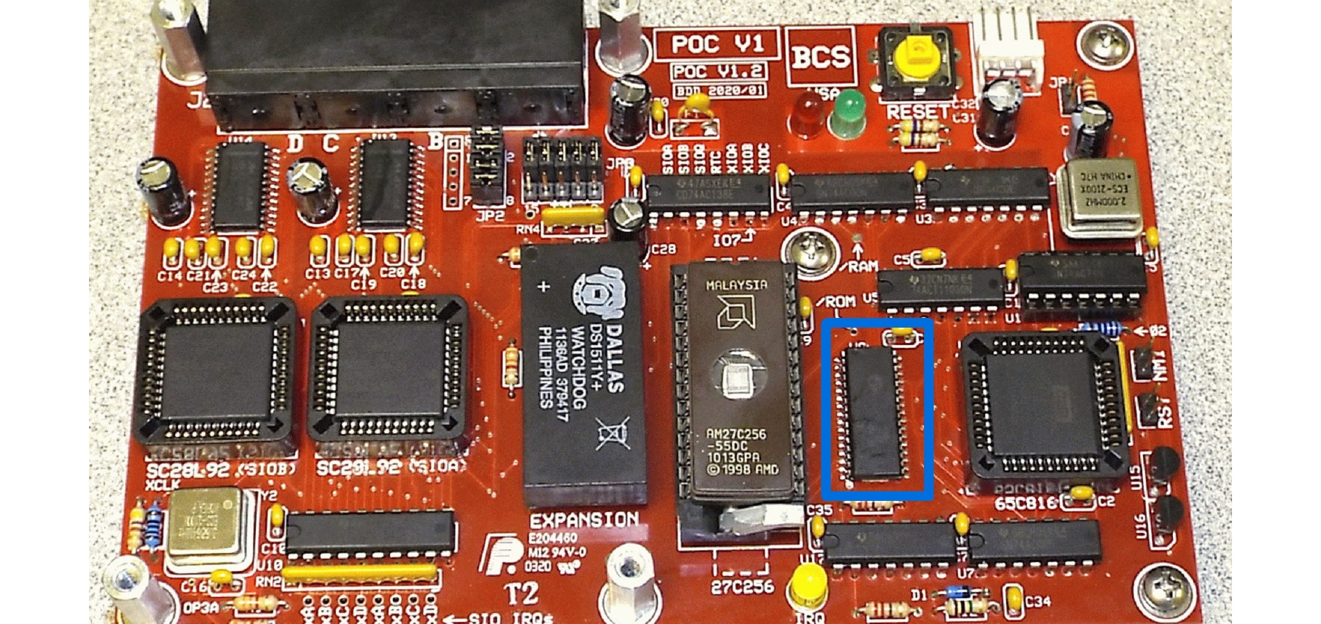

No sir. I quote:
    The IS61C1024AL/IS64C1024AL is available in 32-pin 300-mil SOJ, 32-pin 400-mil SOJ, 32-pin TSOP (Type I, 8x20), and 32-pin sTSOP (Type I, 8 x 13.4) packages.
None of my ISSI data sheets has ever indicated their SRAMs are available in a skinny DIP. The "skinny" package is likely an SOJ32 × 300 mil, same as I use in my POC V1 units. See attached—SRAM is highlighted in a bluish (I think—I'm blue-green colorblind) rectangle.
File comment: SOJ32 × 300 mil ISSI SRAM

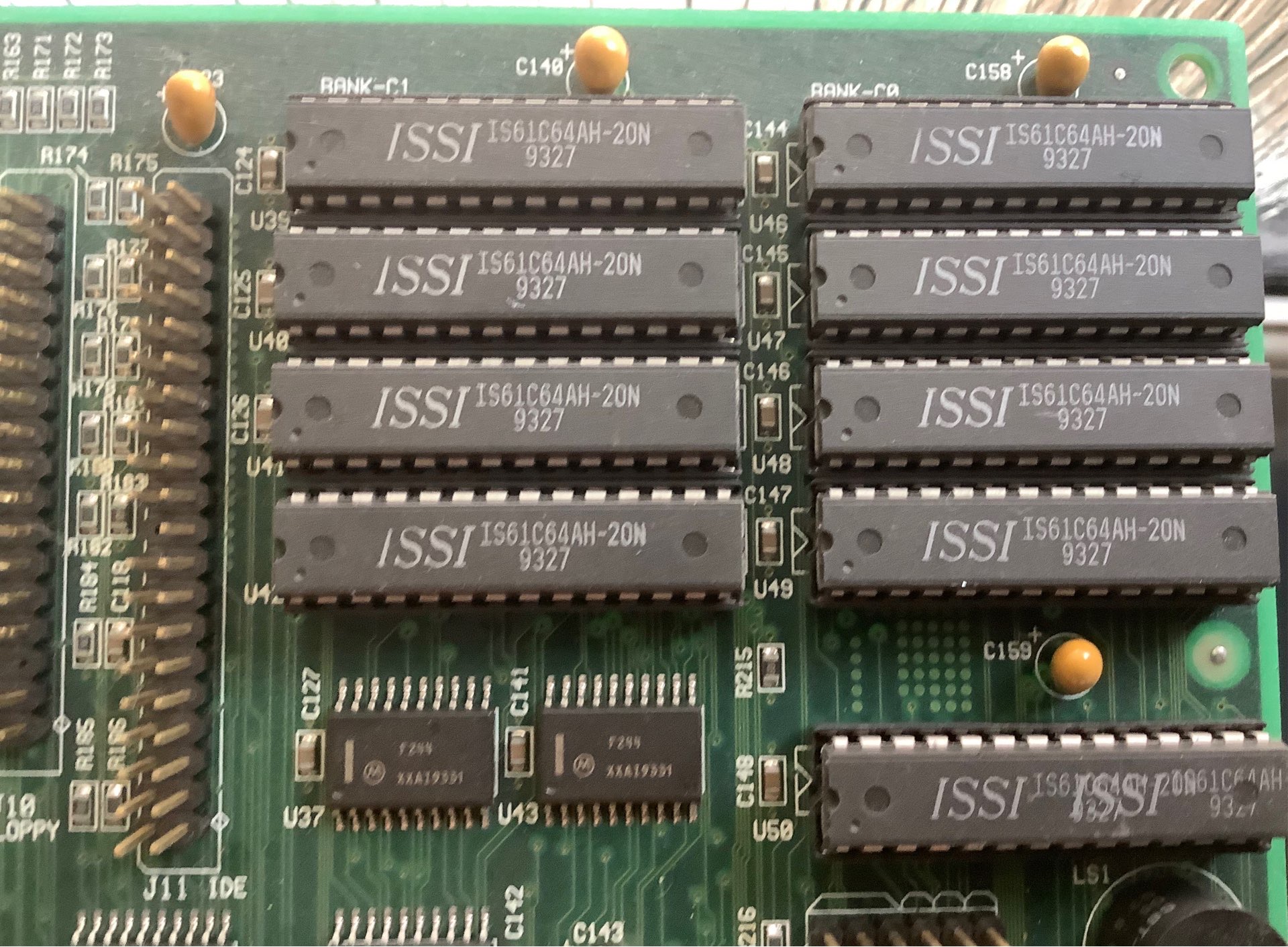

ISSI definitely did produce 32K byte SRAM in 28 pin skinny DIP/DIL form. I have an old PC motherboard with bunch of them on. See photo…
File comment: ISSI IS61C64AH-20N SRAM with a date code of 9327
ISSI may be like some other semiconductor companies, in that they only keep datasheets of their current range online. So if they have stopped manufacturing DIP/DIL (very likely) for some of their products, they will either have removed the datasheet from being online (assuming it was ever online in the first place) or will have revised it to remove all details of discontinued packages.

BDD, you are no doubt correct about current ISSI chips. I was saying that in the past, I've seen ISSI caches with narrow DIP packages. The photo confirms my somewhat unreliable memory...

Yes, I am referring to "current" (the last 15 years) production. DIP caches had their day in the early-to-mid-1990s.

The 1996 and 1998 versions of the IS61C1024 datasheet include the 300 mil DIP package (1996 lists a 400-mil DIP as well). It was removed in the 1999 version.
