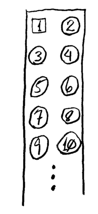

Yes; standard is to have the male on the board, so you can plug IDCs onto it. IDCs (insulation-displacement connectors) are super easy to mount onto ribbon cable. You just put the IDC over the cable and mash it on with a vise, resulting in this:
Silkscreen around the IO Ports (including standardizing on IO(X)P(Y) where X is the VIA's number (1 or 2) and Y is the port on the VIA (A or B). Will also switch to clockwise pinout instead of odd-even.
The standard pinout, looking down into the pins on the board is like this
so the numbers go in order of the conductors in a ribbon cable that plugs onto it, and pin 2 is always at the top right, regardless of how many pins there are.
Yep, that's the plan. I have a large handful of 2x8 IDC sockets, assembled cables, as well as breakouts to DIP size (breadboard friendly). I have a much smaller handful of 2x7 shrouded male sockets (and none of the supporting gear). For board 2 I will just use the shrouded male socket and dupont connector jumpers to connect things. Then I guess I'll make a decision of if I want to build/acquire the rest of the 2x7 (i.e. 14pin IDC) gear, or if for RevB I want to switch to an 16pin connector (which could carry ... more power? clock? reset might actually be useful).
That's really good to know. I was looking at your schematic while doing schematic capture but I ended up picking the wrong footprint when laying out the board. I got it wrong on the Y axis, my pin 1 is top right, pin 2 is top left and so on. I will NOT switch to clockwise, I will just follow your diagram.
