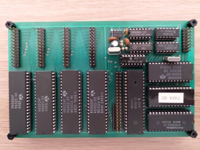

Hello all ... back in 1989 I bought a J.P. Designs Parallel 65 SBC (*) for a model railway project. I still have the receipt, purchase price back then was £127.02! The project never went anywhere but I still have the SBC. The board has R6502A, 6264 8kx8 static RAM, 2764 8kx8 EPROM, R6551 ACIA, 4xR6522 VIA, and the following for glue logic: 74HC74, 74HC04, and 74LS138. Finally a 1488 and 1489 provide RS-232. The 138 decodes A13/A14/A15 to give 8 8k blocks, phi1 (yes phi1) being used as input to the 138 to qualify the /CE outputs. On the 6264 and 2764 /OE and /CE are connected together. The 6502 runs at 1Mhz.
Finding a bit of free time recently whilst other projects are on hold I decided to get the SBC out for a bit of fun. I removed the 1488 and 1489, fitted a couple of jumpers, connected a 5V RS232 to USB adapter, and applied power. It worked :D
Now thinking I'd like to get back into playing with the 6502 family - I had an Acorn Atom back in the late 70s and a loaner BBC micro in the early 80s. I'm contemplating upgrading to a WDC65c816, 32kx8 CMOS static RAM, and using a 8kx8 NVRAM (STMicroelectronics M48Z08-100PC1?) in place of the EPROM. Glue logic would be updated to decode 32k+(8*4k) and would use phi2 to qualify R/W to generate /OE and /WE. I'd also like to use the existing PCB as much as possible cutting a few tracks and rewiring where necessary. For the 65816 and new glue logic I'm thinking of a small point to point wired daughterboard connected to the 40 pin header conveniently provided on the original board which breaks out the original 6502.

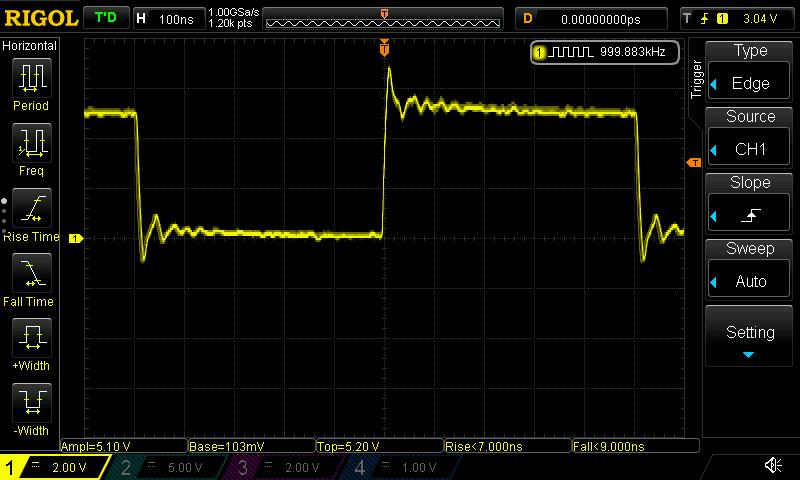

My only caution is that you examine the Ø2 clock on a 'scope to verify that it swings rail-to-rail and that the rise/fall times are very short, ideally under 5ns.
See below for what the clock output from the 74HC74 looks like - rail to rail pretty much with some ringing, but not quite <5ns rise and fall. Adds more to the potential troubles!

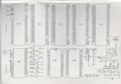

The user manual includes a 'circuit diagram' as shown below. Not quite sufficient in itself, for example not showing that the output enables and chip enables are tied together on the ROM and RAM.

In addition to another Welcome... that appears to be a pretty nice board... hacking it up (slicing land patterns, etc.) seems like a pity. Another member recently hacked up a Commodore 1581 drive to get a CPU and couple other parts. Those drives fetch some pretty good money, but it was pretty hacked up. Then again, no idea what the board you have might be worth... probably not much, but still.
So, perhaps a different approach. I would look at making a daughter board that can plug into some of the existing sockets for the logic chips and RAM/ROM chips. That single board could then hold a 32KB RAM, 32KB EEPROM and either some logic chips for glue, or just replace all of them with a single ATF22V10. The one chip can yield qualified read and write signals, RAM and ROM chip enables and up to 5- 32-byte wide I/O selects. Also, just add a single half-size can oscillator and a DS1813 reset chip and momentary switch and you will have a nice little hardware board for doing some fun stuff.

I tend to agree - it would be a bit of a shame to hack the board about. If you can use existing connectors and sockets to make the enhancements you're thinking of, that would be nice. Although of course it's your board.

1. Still try to use the existing PCB - it is only double sided so should be easy enough to cut tracks and rewire as needed
Like the others, I'd be reluctant to butcher the board. As with the early KIMs, what you have may have collectors value. It would be unfortunate to destroy that value.
Yes, I'd expect rail-to-rail with a 74HC device—didn't know that was the clock source. The rise/fall time is not a problem with a Rockwell 65C02, but might be with a WDC 65C02. You'd have to test to be sure. Worse comes to worse, you can replace the 74HC74 with a 74AC74, which will easily meet the 5ns requirement, albeit with a little more ringing.
Speaking of ringing, what I see on your 'scope capture doesn't appear to be anything about which to worry.

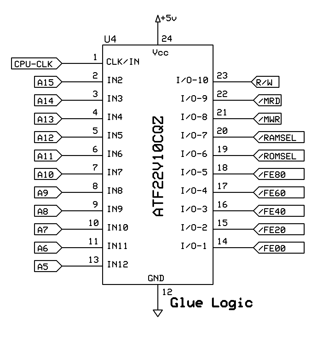

Here's a pic that shows the glue logic from my C02 Pocket SBC. You can see what actual signals from the CPU are required and what you get for outputs. Between the RAM/ROM sockets, the 74LS138 socket and the 555 timer socket, you can likely get all of those signals and then drive the rest of the PCB from there.
A shown, you'll need the clock signal that drives the CPU, the top 11 address lines and the R/W line. The /MRD and /MWR are the memory read and write lines, RAM and ROM obvious... and then of course the 5- I/O selects. What's shown as the signal name are the actual hex starting addresses for each.
Also note that using an EEPROM might be advantageous... as you can use some code to program it insitu... of course you need to be careful to ensure you don't load bad code... otherwise it may not boot up ;-)

Here's a pic that shows the glue logic from my C02 Pocket SBC...the top 11 address lines and the R/W line.
That is awfully dense address decoding, and is eating up scarce GAL inputs. I would not have made the I/O "windows" so small, nor would I have placed them smack in the middle of the $Fxxx block. I prefer to maintain contiguous ROM in the high pages to maximize code space.

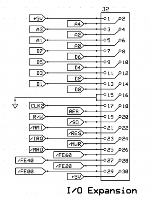

Well, there is a method to the madness... I prefer the I/O block (or even a page) at $FE00. My logic is simple: Pages 0 and 1 are special with the 6502... Page Zero and the Stack. The top page ($FF) contains the hardware vectors for Reset, NMI and IRQ/BRK. Logically, this is always going to ROM (or RAM loaded with some code before the CPU comes out of Reset). In between these four pages is all memory... so you can obtain a contiguous 63KB of memory, which could be all RAM as well.
As for the smaller I/O blocks (windows), I've found that a 32-byte wide I/O select can do a fair amount. The 6522 is only 16-bytes wide, so two can be selected with a single I/O select. Also, my recent RTC/CF Card adapter uses a single I/O select and can access the full register set for the DS1511, the full set of registers and chip selects for the Compact Flash card and the upper 8-bit latch for 16-bit data transfers.
Granted, my memory map may not satisfy everyone.... but it works perfect for the confines of the C02 Pocket and it's expansion connector as show below:
