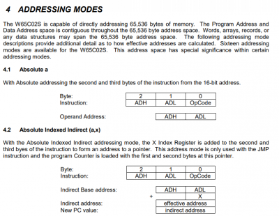

I may have not explained what i wanted to say well
I mean in addressing modes as for the instructions themselves, not how the CPU addresses the memory
Here are some examples, which i still dont understand, of addressing modes

What's that image you posted, Radiant? Something from WDC doc? I can see how you might be disappointed in that.
So, I guess you need some material that explains the subject in a different way, and/or simply does a better job -- and there's nothing wrong with that. But ask yourself this. Do you think I or some other poster is going to be a better resource for you than a professional author (other than the WDC folk, I mean)? Again I refer you to the MOS Programmning Manual (which is where I learned about address modes, so I know the info is in there).
Another excellent reference is Programming the 65816 Including the 6502, 65C02 and 65802 -- a pdf which I believe is available on the WDC web site.
I see Ed has posted while I was typing, and my message echoes what he said: "If you want us to do some work, you will need first to show that you have done some work."
If you still have a few specific questions after you've done your homework then c'mon back here and we'll try to help.
