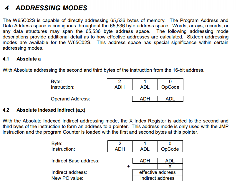

Hi i am working on remaking 65c02
https://eater.net/datasheets/w65c02s.pdf
And i cant understand the addressing modes and what they do
Can anyone please explain them to me?

I may have not explained what i wanted to say well
I mean in addressing modes as for the instructions themselves, not how the CPU addresses the memory
Here are some examples, which i still dont understand, of addressing modes

What's that image you posted, Radiant? Something from WDC doc? I can see how you might be disappointed in that.
So, I guess you need some material that explains the subject in a different way, and/or simply does a better job -- and there's nothing wrong with that. But ask yourself this. Do you think I or some other poster is going to be a better resource for you than a professional author (other than the WDC folk, I mean)? Again I refer you to the MOS Programmning Manual (which is where I learned about address modes, so I know the info is in there).
Another excellent reference is Programming the 65816 Including the 6502, 65C02 and 65802 -- a pdf which I believe is available on the WDC web site.
I see Ed has posted while I was typing, and my message echoes what he said: "If you want us to do some work, you will need first to show that you have done some work."
If you still have a few specific questions after you've done your homework then c'mon back here and we'll try to help. :)

About addressing modes:
  • Think of immediate like "Here, take this," and the person hands it to you. Example: LDA #$41
  • Think of direct as "Go ask Bill for the file." IOW, it tells you where to get it. Example: LDA $43A (with no "#")
  • Think of indirect ask "Go ask Bill where to find that resource." IOW, Bill doesn't have it, but he can tell you where to get it. Example: LDA ($6B)
  • Think of indexing like adding to an address, either with or without indirection, to get the final effective address. If with indirection, it can be before or after the indirection. Imagine you're a new employee, and you've met some of the others but don't know all of them yet. Let's say you know where Bill's cubicle is, and someone tells you, "Take this to Lori. She's in the third cubicle after Bill's." The specified address is "Bill's cubicle," and the index register contains a 3, so now you know where to go. Example: LDA $3A60,X
  • Implied just means the location or target doesn't need to be specified (like SEI, which is the SEt Interrupt-disable bit instruction), or the mnemonic itself tells (like DEX, the DEcrement X), or the processor can get the information off the stack (like RTS, the ReTurn-from-Subroutine instruction), or from the stack pointer (like PLA, the PulL Accumulator instruction which knows where from the stack-pointer register)
  • Absolute means the supplied address is 16-bit. It does not necessarily mean there won't be indirection involved.
  • Instructions referring to ZP (zero page, ie, addresses from 0000 to $00FF) save memory and execution time by not having to specify or load an address high byte, because it is assumed to be 00. ZP instructions offer indirect indexed and indexed indirect combinations that are not available in absolute addressing. Examples: LDA ($4E),Y and LDA ($4E,X)
It's possible to do doubly and triply indirect addressing, but we'll leave it for later as it's more advanced. Hopefully I remembered all the main ones.
Most addresses in the code should be given names that are meaningful to humans. The assembler will substitute-in the numerical addresses. This is true for many constants, too. There should be very few numbers showing up in your programming. I just put number above to emphasize that they are actual addresses, even though in most cases I would have names for them in my code, since "$4E" for example doesn't tell you what $4E is used for.
