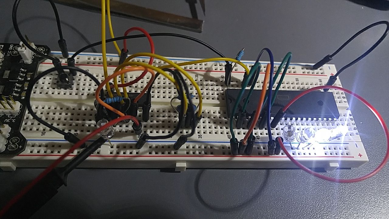

Well I tested the 74HC14 clock circuit, with a capacitor in series with the input and a resistor in the input in parallel with the output as shown in the left, ticking more or less at the amazing speed of ~1 (one) hertz. I put some LEDs in the address lines, Ben Eater's stytle, to be sure the CPU was doing something.
And the '816 will take it. It's of course a non reliable method to get the CPU kicking at higher speeds.
In the center there is a ceramic resonator I pulled out from a Denon music amplifier, that used a MCU to manage the sound inputs and outputs. It runs at 4 mhz and of course will also make the '816 run.
Well... let's see what I can do from here...
Why, at the blazing speed of 1 Hz, POC V1.3 should be able to complete all three POST stages in about 22 hours. :D
The 816 has a fully static code, hence the lowest clock rate at which it can maintain state is 0 Hz.
BTW, for a real-world application, use of a CMOS can oscillator is the preferred clock source. WDC specs say the rise/fall time of the Ø2 signal should not exceed 5ns. Once Ø2 gets into double-digits, it's a good idea to run the oscillator through a flip-flop (74AC74 or 74AHC74 recommended) to ensure clock symmetry and avoid potential timing gotchas. The 74A(H)C74 can be used in conjunction with a 74AC109 to create a clock source that can be stretched to accommodate slow hardware—the illustrated method would be used if extended RAM is present. A simpler, one-chip solution, suitable for an 816 system without extended RAM, or a 65C02 system, is documented here
