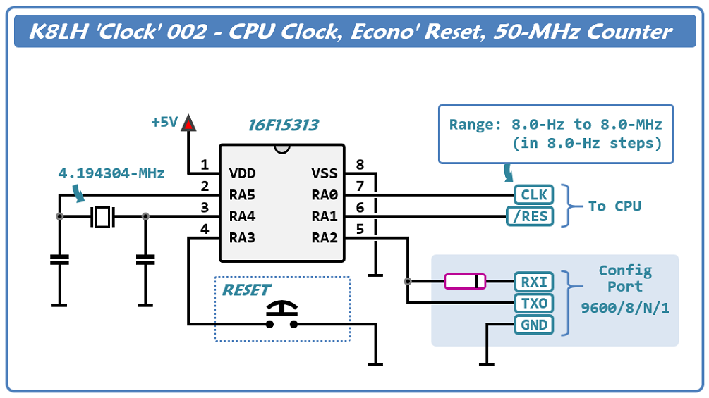

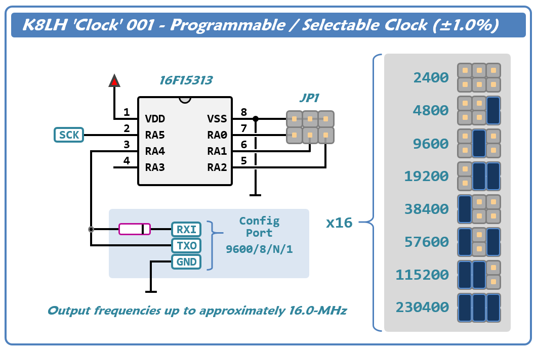

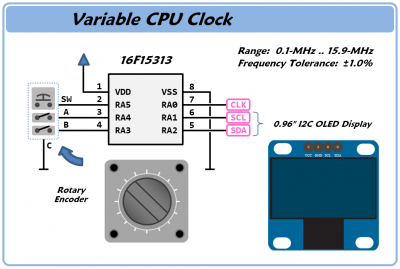

Have you considered using a microcontroller? Many PIC microcontrollers include a 20-bit NCO (with 20-bit increment register) for frequency generation. Here are a few concepts I've thought about;

I do like the idea of these PIC clock generators! Configuring by serial input is nice, as it's both input and display, and ideal for debugging. Three cases spring to mind: pushing the speed up or down by small increments to troubleshoot the max speed of something; setting one of a small number of preferred operating frequencies; and running a board at +10% or +5% to gain confidence that there's some margin.
At present in the beeb816 project Dave and Rich are swapping crystals and selecting small divisors to explore frequencies in the range 8 or 12MHz to 16MHz. Being able to set the speed from a serial line sounds like an improvement.

Just to check something, Michael, about the PIC and the NCO and the clock that it can make. It is, presumably, the case that every edge on the output clock - the one whose frequency we aim to have in tight control - is placed on an active edge of some internal high speed clock, running perhaps at 40MHz.
In which case, we can place edges on a 25ns granularity, and so adjust the high and low clock phases on a 25ns granularity. That gives us certain natural output frequencies which will have no jitter, and if we set the NCO to produce any other frequency, we'll get the right average but we will have jitter from one phase to the next.
Is that the right picture?
PostPosted: Wed May 05, 2021 9:03 am
Posts: 588
That's correct, BigEd.
A 4.194304-MHz crystal (4xPLL) provides 8-Hz increments (up to approx. ~8-MHz).
An 8.388608-MHz crystal (4xPLL) provides 16-Hz increments (up to approx. ~16-MHz).
If you use the PIC 32-MHz Internal Oscillator you get 15.2587890625-Hz increments. For the case of generating a CPU clock, may I suggest using frequencies that are multiples of 15.625-kHz which will produce integer increment register values? For example;

Hmm, I need to do a little arithmetic. While this idea has its uses, I'm not sure it's suitable for what I was thinking of...
8.000000 MHz is a 125ns period
8.125000 MHz is a 123ns period
But, I think, we don't have a 2ns granularity of control on the placement of edges.
Let's suppose a 32MHz master clock, which has a period of 31.25ns. So four cycles of the master clock produces an exact 125ns period, which would be 8MHz exactly. (*) But the next even increment is to 3 cycles in one direction or 5 cycles in the other, which would be frequencies of approx 10.67MHz and exactly 6.40MHz.
I understand that the NCO produces a long-term average frequency that's pretty well controlled, and that might be very useful for radio or audio purposes, perhaps with filtering, but I'm struggling with the implications of clocking a computer this way: if one clock phase is 4 ticks long and the next is 3 ticks long, the computer will need to be fast enough to run at the 3 tick speed. We are adjusting the average speed of the computer, but we can't use this technique to explore the limits of speed.
Edit: in fact, perhaps, if we have a computer which can run at some speed which is an exact number of ticks per phase, then we can happily use the NCO technique to run at various lower average speeds. There might well be uses for that.
Am I still understanding correctly?

Oh my goodness. I'm embarrassed. I've had an incorrect understanding all this time and I should have known better.
My apologies, BigEd. This scheme really isn't very useful except perhaps for generating ACIA clock frequencies which are usually divided by 16 or 64 in the ACIA chip.
