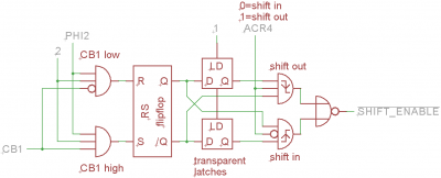

I don't know much about the 6522. No of the systems that I specialize uses a VIA. But I recently found out about the SHIFT external clock bug, that happens to be almost exactly the same as a chip that I do am familiar. So I was very curious and reverse engineered the VIA 6522 external clock logic.
Below is a link to the SHIFT external clock logic, reverse eginereed from die shots. You can see that synchronization is far from being foolproof:
https://github.com/ijor/VIA6522/blob/ma ... tector.png
One interesting point. The output of this edge detector enables the shifting. There is no clock mux that selects between the external and the internal clocks depending on the settings of the ACR registers. That was initially a surprise, and it might be non obvious how it could work like that at all. But after some though you realize that a clock mux is not really needed and the expected, documented behaviour works perfectly fine like this.

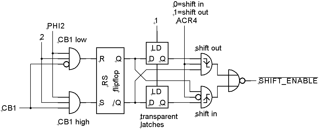

Ijor, nice work.
CB1 is sampled when the non_overlapping clock 2 is high (during PHI2=high),
to synchronize the external CB1 clock signal with PHI2.
This sure can cause problems if the external clock signal at CB1 is from a different clock domain
(not generated by something running with the same PHI2 clock than the 6522).
IMHO it would have been better to generate the shift register clock directly from CB1 to get around such problems,
but this would have created another problem: synchronizing the parallel shift register outputs with PHI2
(what would have taken more transistors and more chip space).
Felt a need to re_draw your schematics, and I'm adding a monochrome picture for those who happen to be color blind:
Sure. I actually appreciate it because, as it might be obvious, I'm not very good at drawing schematics.
A small comment though. The gates you draw as transparent latches are actually dynamic delays, or dynamic latches if you want. They retain the state only by capacitance and they will discharge eventually if not refreshed. Of course, this chip has plenty of those dynamic cells and obviously it is not fully static. I realize you already knew that, but I think it should be somehow noted in the schematics.

I'm aware of the dynamic latches, already had that game when dissecting the 8701 clock generator chip.
I think that the schematic is more easy to understand when drawing transparent latches instead of dynamic latches.
Also, I think it simplifies things for those who might want to try simulating the circuitry.
Well, might be a matter of personal preferences. But be aware that a dynamic cell can't always be modeled and replaced with a transparent latch. Sometimes the capacitive feature is important, such as when you have multiple of those transistors in parallel. In such a case, multiple transparent latches that constantly drive their outputs would create contention and would not work.

It actually is a matter of personal preferences.
I think that I'm aware of the importance of the capacitive features.
Thanks for pointing that out, not all of the readers might be aware of it.
