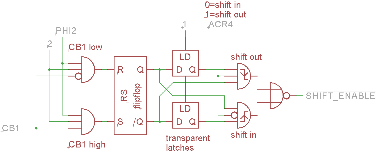

Ijor, nice work.
CB1 is sampled when the non_overlapping clock 2 is high (during PHI2=high),
to synchronize the external CB1 clock signal with PHI2.
This sure can cause problems if the external clock signal at CB1 is from a different clock domain
(not generated by something running with the same PHI2 clock than the 6522).
IMHO it would have been better to generate the shift register clock directly from CB1 to get around such problems,
but this would have created another problem: synchronizing the parallel shift register outputs with PHI2
(what would have taken more transistors and more chip space).
Felt a need to re_draw your schematics, and I'm adding a monochrome picture for those who happen to be color blind:

A small comment though. The gates you draw as transparent latches are actually dynamic delays, or dynamic latches if you want. They retain the state only by capacitance and they will discharge eventually if not refreshed. Of course, this chip has plenty of those dynamic cells and obviously it is not fully static. I realize you already knew that, but I think it should be somehow noted in the schematics.

I'm aware of the dynamic latches, already had that game when dissecting the 8701 clock generator chip.
I think that the schematic is more easy to understand when drawing transparent latches instead of dynamic latches.
Also, I think it simplifies things for those who might want to try simulating the circuitry.
Ijor, any plans to go for the rest of the 6522 silicon ?
Unfortunately, there don't seem to be polygonized pictures of the 6522 silicon in the internet.
Polygonized pictures would be very helpful for reverse engineering the chip.

It actually is a matter of personal preferences.
I think that I'm aware of the importance of the capacitive features.
Thanks for pointing that out, not all of the readers might be aware of it.
If you would be trying to analyze the chip,
I would be trying to help if my spare time permits this.
I already had helped with the dissection of the SID chip,
and some years ago I did an experimental TTL implementation of the 6522.
