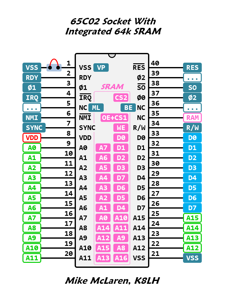

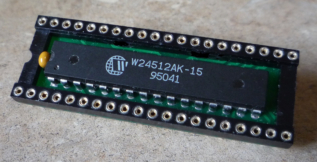

Yes, that 128K RAM chip should work fine. Also, 'skinny' 64K RAM chips like W24512AK, UM61512AK, and IS61C512 are available from Chinese sources at quite reasonable prices but at the expense of long shipping times.
Cheerful regards, Mike, K8LH

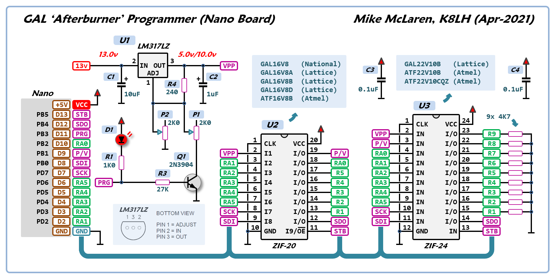

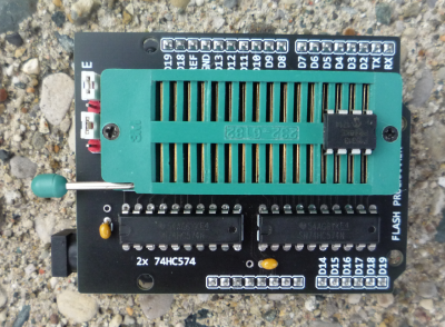

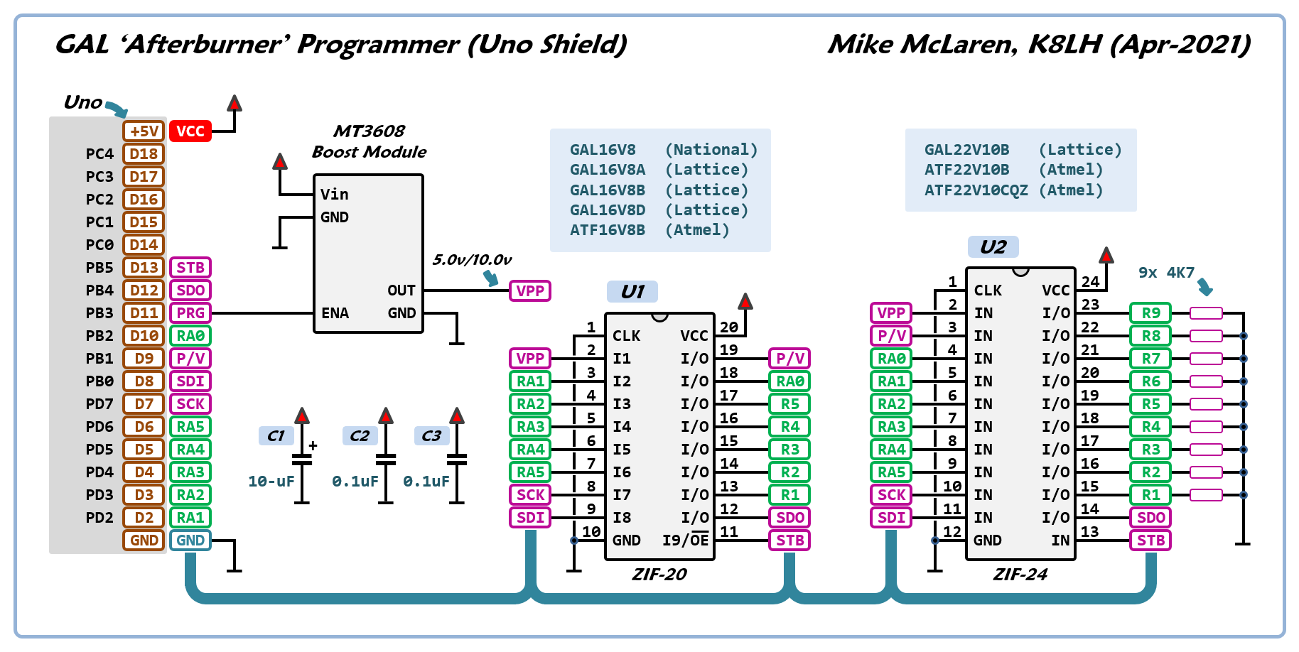

I wonder if anyone has worked out the GAL logic necessary to boot from ROM in order to copy a monitor and OS image into RAM and then switch out the ROM for a 64K RAM system?
BTW/FYI... I'm building a programmer for the Atmel 16V8B and 22V10CQZ GAL devices based on this Afterburner programmer project.
