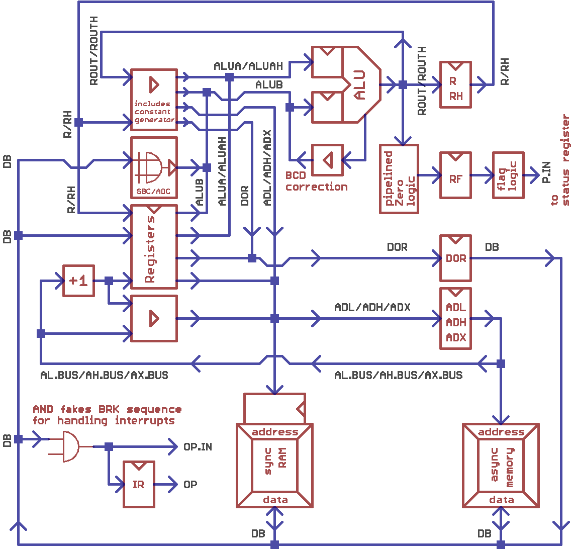

Just as a "sanity check", I felt a need for drawing a block diagram showing the data paths of Drass's LogiSim model:
Due to the complexity (Igo isn't a small beast), it may contain some errors.

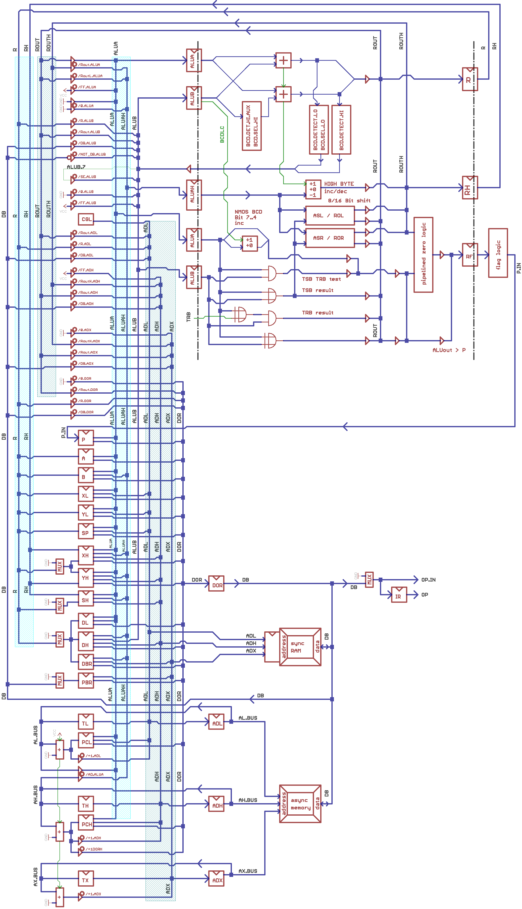

PostPosted: Thu Apr 01, 2021 5:51 am
Posts: 1431
Arrangement of the bus systems becomes a bit more clear when "zooming out" by one level:
Edit: registers are supposed to feed the ALU inputs, fixed this error.
PostPosted: Thu Apr 01, 2021 8:12 am
That's a very nice diagram!
PostPosted: Thu Apr 01, 2021 9:01 am
Posts: 1431
Thanks for the kind words.
I wasn't involved in creating the LogiSim model of the CPU,
and since Drass currently seems to be busy with the verification,
I felt a need to draw some block diagrams for better understanding what's in his big LogiSim schematic.
When making the documentation for the CPU later, we would be going to need block diagrams anyway.
My Eagle 6.4 block diagrams, just in case somebody needs them:
c74_100_blockdiagrams.zip [26.71 KiB]
Downloaded 83 times
Edit: fixed an error.
