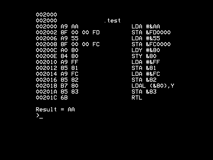

LDA [80],Y really does only take 6 cycles, even when crossing bank boundaries.
The 65815 must be handling the increment of the bank address "on the fly" in the data setup time window at the end of cycle 5.
Dave
PostPosted: Wed Dec 30, 2020 12:03 pm
Posts: 337
Here's the same test, in BBC Basic 816, which has a full 65816 Assembler built in and runs in native mode:
Same result:

Dave

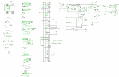

PostPosted: Tue Mar 02, 2021 12:51 am
Posts: 428
Location: Toronto, ON
It took while, but I now have a first pass of the 65816 in Logisim! (pic below)
It's a beast, that's for sure, but it looks like it will still make 100MHz! :shock: At least that's the theory -- the reality of laying all this out on impedance-controlled PCBs is sobering to say the least. But be that as it may, I'll just press on for now and we’ll see how it all works out in time.
To recap, the new architecture required the following additions:
  • A 16-bit adder/incrementer in the ALU (this is an 8-bit adder followed by an 8-bit carry-select incrementer for the high-byte),
  • A 24-bit carry-select incrementer on the address bus,
  • 16-bit WriteBack and flag evaluation stages (Z flag evaluation is pipelined across two-stages),
  • 16-bit C, X, Y, S, and D registers,
  • Selectable 16 and 8-bit busing and muxing to shuttle values around,
  • Mode-dependent register-widths and interrupt vectors,
  • Initialization of various registers to appropriate values on reset,
  • A "Loop-on-Carry" function to support the MVP and MVN opcodes,
  • Tighter encoding of microinstructions to control all this (with associated decode logic).
With that, I'm happy to report that the CPU now supports cycle-accurate 65816 operation with just a few exceptions:
  • The (dir,x) and dir,x addressing modes take an extra cycle if DH is non-zero,
  • The long,x and [dir],y addressing modes take an extra cycle if a bank boundary is crossed or if a write is performed,
  • Decimal Mode takes and extra cycle.
The extra indexing cycles could be overcome with a true 16-bit adder, but at the expense of more hardware and a longer cycle. The same is true for Decimal Mode, where a longer cycle could accommodate a separate decimal adjust circuit in series with the binary adder. In both cases the extra cycles occur relatively infrequently, so it makes more sense instead to forgo compatibility and keep to the faster clock-rate. The CPU will both perform better and require less hardware as a result.
Overall, I'm quite happy with the where this design is at the moment. I have completed "unit testing" on the current model (by which I mean that every instruction has tested correctly at least once). The next step is to run more comprehensive testing using some sort of suite. I'm not planning anything like the Dormann suite, but investing a little time on some test code is sure to pay dividends down the line. If anyone has some 65816 code that can be reasonably adapted to run as part of such a test, that would be very helpful. Complete programs with lots of I/O are probably not great candidates for this. But a compute-intensive code fragment whose result can be tested against a pre-computed value would work very well.
Many thanks to Dr Jefyll, ttlworks, BigEd and Hoglet for their help in getting to this point. As always, all suggestions welcome.
Cheers for now,
Drass
P.S. I thought it might be interesting to mention a few words about the MVP/MVN opcodes. As one might guess, these opcodes move one-byte when executed, and are then "re-executed" for each remaining byte to be moved. This is can done efficiently by inhibiting FetchOpcode for as long as the move is in progress. Meanwhile, the X and Y registers are incremented (or decremented for MVN) and the C accumulator is decremented on every pass. The end of the loop is triggered when C wraps from "0" to "FF", which conveniently fails the “loop on carry” test. The final subtlety here is that PC must be restored on every iteration so the operand bytes can be re-read as normal. (Yes, this is done redundantly even though the operands don't change. The FetchOpcode cycle too is executed redundantly, even when the operation is inhibited. The net result is that the opcode executes it's full contingent of seven cycles for every byte moved). The rationale for this rather awkward implementation is simple: it requires a minimum of specialized hardware. I briefly contemplated an enhancement to skip the re-reading of operands and save two cycles per byte. However, that’s quite messy for the pipeline, so I decided to leave well enough alone and stick with the stock implementation. :)

PostPosted: Tue Mar 02, 2021 9:07 am
Posts: 10838
Excellent and marvellous! (But possibly worth a new thread?)
Very interesting that you landed in the same place as the original, with MVN and MVP.
PostPosted: Tue Mar 02, 2021 10:52 pm
Posts: 428
Thanks BigEd!
This is the same 100MHz TTL CPU project as before, with the same pipeline and general architecture; it just happens to have a 65816 under the hood! :twisted: :)
Yes, I was surprised at how easily that solution fell into place. I think it shows a clear bias on the part of WDC toward a "simple as possible" solution for MVP and MVN.
I found it interesting that the implementiton of the TRB and TSB instructions leaned in the opposite direction. These two opcodes use the same number of cycles as any other RMW instruction despite carrying an extra bit of processing. The portion that sets and resets bits in the operand is handled in the usual way: read the operand, OR with Accumulator to set the appropriate bits (or AND with the inverse of the Accumnulator to reset bits), and write the result back to memory. The "test" portion of the instructions, on the other hand, does not use the result of the RMW operation as normal. Instead, the status flags are updated by ANDing the operand with the Accumulator (much like the BIT instruction does). To accomplish both in one cycle requires a dedicated "test" circuit and a separate path through the ALU. The same could have been accomplished without additional hardware with one more cycle. But in this case, WDC opted for the faster solution. (Perhaps there was an expectation that TRB and TSB would be used in timing sensitive I/O operations and needed to be fast?).

Thanks Andy. I’m fast becoming a fan of the 65816 myself. Picking up a 16-bit value in the accumulator and shifting it left will make a convert out of anyone; or how about indexing across 64k with a single register. I have a sentimental attachment to the NMOS 6502, but I have to say that programming the 65816 is a pleasure.
PostPosted: Sat Mar 13, 2021 3:52 pm
Posts: 428
Did I really say this? Hmmm ... based on the bugs my test suite is uncovering, I can categorically say this was NOT accurate.
On the other hand, the kinds of bugs I'm running into are far from surprising:
1) Incorrect encoding of microinstructions (assembly of microinstructions is partially a manual process),
2) Incorrect decoding of microinstructions (done with 74LVC138 1-of-8 decoders followed by error-prone PAL-like gate logic),
3) Unforeseen side-effects of decoded control signals (mostly due to tricky encoding required to pack more functions into fewer control bits).
The good news is that the overall pipeline and busing architecture is holding up well. The test harness now includes opcodes up to $3F, which means the model runs through various addressing modes with OR, AND, ASL and ROL, as well as exercising BRK, COP, RTI, JSR, JSL, RTS, RTL, TSB, TRB. I have also been careful to include page and bank crossings as we go. For example:
; 17 ORA [dir],Y (Crossing banks)
   LDY !#$ffff
   LDA !#$2187   ; long pointer address
   STA dpage
   LDA !#$00   ; long pointer bank
   STA dpage+2
   LDA !#$0018   ; place marker in bank 1
   STA $002187+$ffff
   LDA !#$ff00
   REP #$CB   ; clear the flags
   ORA [$00],Y
   PHP
   PHP
   CMP !#$ff18
l17.5   BNE l17.5
   PLA
   CMP !#$8484   ; NV00 DIZC = 1000 0100
l17.6   BNE l17.6
I continue to find bugs at a good rate so it's important to keep going. (I should also mention that current testing assumes the E, M and X flags area all zero and that both DL and DH are non-zero; additional testing will be required to cover off other combinations. The notion of exhaustively testing this CPU is probably too ambitious, but every bit of validation counts! :)).
Cheers for now,
Drass
