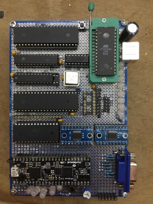

Hi all,
I would like to be able to interface a WDC65C02 to an FPGA, specifically write to the FPGA block ram from the 6502.
The FPGA is presented to the 6502 as an IO device at address $FF80 (for example). One chip select line, 3 address lines, the 8 data lines, the PHI2 line and the RWB line are all inputs to the FPGA.
I am trying to make the FPGA save the data received in it's block ram when I am writing to it from the 6502. I have tried at least 5 different ways, and I always get unreliable data. I have looked at many timing diagrams for the 6502 write cycles and it seems that my verilog code conforms to that. The address is latched on a clock positive edge, and the data on the clock negative edge.
The 6502 test code is very simple:
    ldx #0
loop:
    stx $FF80
    inx
    ldy #$10
    jsr delay
    bra loop
or something to that effect.
I have tried delays between 0 and about 2000 cycles, but I don't think that should affect anything.
One of the possible issues is with the level converters. I have tried both TXS0108 and 74LVC4245 with the same results.
Here is some of the current verilog code:
    // CLK_100M is a 100Mhz clock generated by the on chip PLL
    always @(posedge CLK_100M) begin
        // This sets the command registerfrom the address lines when the chip is enabled and the 6502 is writing
        // (the enabled and write signals are inverted ENB and RWB)
        if ((PHI2 == 1'b1) && (enabled == 1'b1) && (write == 1'b1)) begin
            command_reg <= REG;
        end
    end
        // this saves the data from the 6502 during the whole of PHI2 high and stops when it goes low
        if ((PHI2 == 1'b1) && (enabled == 1'b1) && (write == 1'b1) && (save_data == 1'b0)) begin
            command_data <= DATA;
        end
        else if (PHI2 == 1'b0) begin
            // Here I do something like this :
            bram[command_reg] <= command_data;
        end
    end
I have tried many different ways, including something like this :
always @(posedge PHI2)
    command_reg <= REG;
always @(negedge PHI2)
but always with mostly garbage results.
I have tried with the 6502 running at 12, 10, and 1.8 Mhz (only 3 oscillator values I have).
Does anybody have any idea what I'm doing wrong ? I'm a complete newb with FPGA (I'm using an ice40 by the way) so any pointers will be more than welcome.
Thanks

I have a few suggestions:
- post a minimal - but complete - example of the Verilog that shows the issue, rather than just selected fragments
- give some more information about the hardware, including the FPGA part and/or development board being used, and whether any level shifters are being used.
- post some photos of your hardware setup
Yes will do! I'm a bit short on times these days but I realize this information will be essential in debugging this issue.
FPGA dev board is an Ipduino 3 (ice40up5k based)
Level shifters: I have mostly tested with TXS0108.
Hardware is all on perfboard. Will post pics soon.
Regarding the code, I will roll back to something that was mostly working and post it here.
Jonathan Foucher

PostPosted: Thu Feb 18, 2021 9:50 am
Posts: 336
Life is much easier if you only use one edge of one clock, so you're doing the right thing with your always @(posedge CLK_100M). Feed the same clock into every FF, and use their clock enable inputs to decide which cycles to act on. Mixing clocks can be done, but it adds a lot of pain that probably isn't necessary.
You do still have a mixed clock design though. Since you're sampling at 100MHz, you're adding 10ns to the worst-case hold time on address and data. And the 65C02 datasheet informs me that the minimum hold time is 10ns. I'd add sampledAddress, sampledData, and so on, latching them on the appropriate edge of PHI2.
Also sample PHI2 at 100MHz, and use the sampled version internally. You don't want some parts of your design thinking it's 1 while other parts, further from the pin, still think it's 0. If you want things to happen on an edge of PHI2, keep the previous value and use PHI2 = 0 and PHI2 != prevPHI2 as your condition.
So something like this (I've never used Verilog; this is almost guaranteed to be wrong):
always @(negedge PHI2) begin
   sampledAddress <= externalAddress;
   sampledData <= externalData;
   sampledRWB <= externalRWB;
   sampledEnableB <= externalEnableB;
end
   prevPHI2 <= delayedPHI2;
   delayedPHI2 <= sampledPHI2;
   sampledPHI2 <= externalPHI2;
   if (delayedPHI2 == 0) && (delayedPHI2 != prevPHI2) && (sampledEnableB == 0) && (sampledRWB == 0) begin
      bram[sampledAddress] <= sampledData;
   end
end
The delay on PHI2 is to ensure that you aren't trying to read the other signals too soon after they're sampled. Since the two clocks are unrelated, the outputs of their FFs can change at any time during the 100MHz cycle. Wait a whole cycle before looking at them, and they're much more likely to be stable. The FPGA documentation might have something to say about metastability somewhere, and it would be worth reading that.

Hi!
jfoucher wrote:
Hi all,
            command_reg <= REG;
        end
    end
        end
        end
    end
Do you have a synchronizer on all the CPU signals? As you are transitioning clock domains, you will get metastable states if you don't.
In theory, you only need a syncronizer on PHI2, as all the other signals will latch on PHI2sync, but you need to be careful with the bus timings.
Then, the output of the syncronizer should be the transitions detected on PHI2, not the actual PHI2 value. This will make the rest of the code easier, you just do your logic under "if( PHI2syncUP )" or "if (PHI2syncDOWN)" depending on your needs.
Have Fun!

Ok, that sounds that like a workable idea. Since i'd rather have the computer not be relying on the FPGA, I am going to look in the direction of having the FPGA takes it's clock input from the cpu phi2 clock.
I am not sure what a synchroniser is, would you mind explaining ?
Ok so I sample the address, data and RW on PHI2 negative edge. Then I wait one cycle until I use them. I think my code already does this (or did at some point) but I'll have to check.
As requested in a previous post, I have attached some pictures of my hardware setup.
The FPGA is at the bottom left, VGA output at the bottom and juste above we have the serial chip and 2 level shifters(from left to right)
I have also posted the current non-working code here: https://gist.github.com/jfoucher/7915b8f64bdc7e66668144c67ccfdd85
I think there might also be an issue with reading and writing to the block ram at the same time (the ice40 bram is not dual port AFAIK) To mitigate this I have tried using a FIFO as well as double buffering, none of which I could get to work reliably.

Hi!
jfoucher wrote:
It is a fundamental part of digital circuit design when you have two clock domains interacting. This is fairly common - any signal coming to the FPGA from an outside circuit with it's own clock will require proper synchronization - even a simple UART needs this.
This is needed because FPGA logic needs a stable signal on the inputs before a clock pulse, if the signal changes just at the clock, the output of the flip-flop will be on an undefined state - a metastable state.
See: https://www.intel.com/content/dam/www/p ... bility.pdf
The most common synchronizer is a two flip-flop cascade, implemented in your FPGA logic, that should be enough for your design. You should read about metastability and clock synchronization before attempting any FPGA design that interacts with any signal outside the FPGA. Here are more example of different synchronizer circuits: https://www.edn.com/synchronizer-techni ... ocs-fpgas/
Have Fun!

I managed to make it work by bringing the CPU clock (12.5MHz) into the FPGA and drive the PLL from that. This seems to solve most issues when the CPU is writing to the FPGA. However I have not yet been able to read data from the FPGA... But at least that's half of it done.
unclouded, thanks for the code, I will take a look at it, but my situation is different in that I prefer the CPU clock to be provided outside of the FPGA so that the computer can still run without it.
