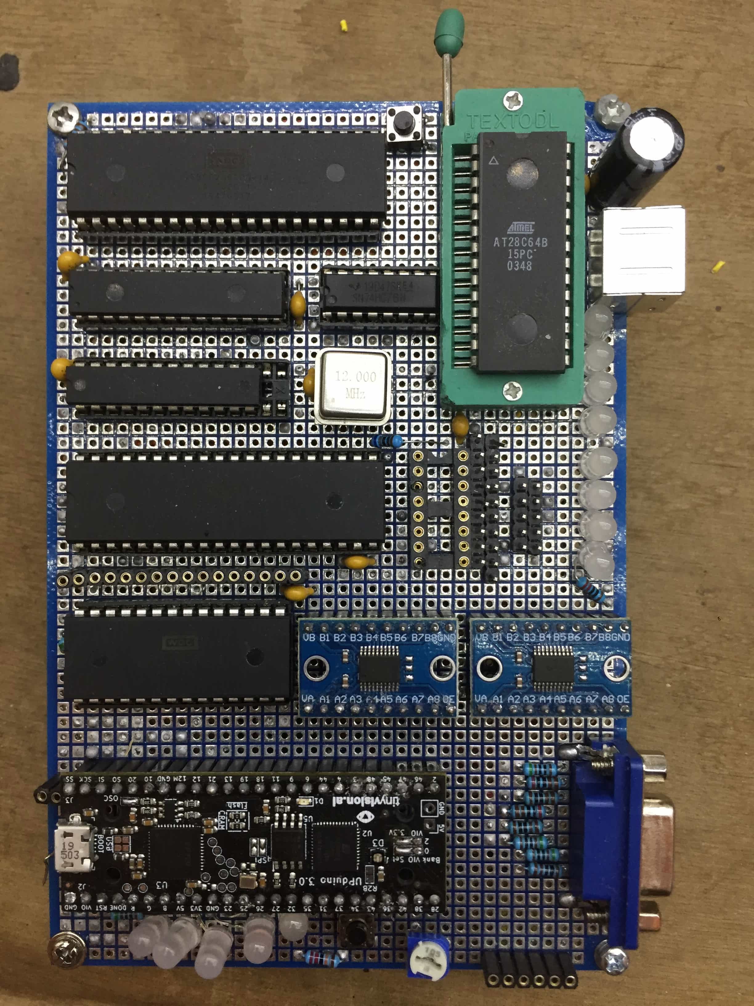

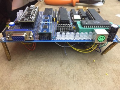

As requested in a previous post, I have attached some pictures of my hardware setup.
The FPGA is at the bottom left, VGA output at the bottom and juste above we have the serial chip and 2 level shifters(from left to right)
I have also posted the current non-working code here: https://gist.github.com/jfoucher/7915b8f64bdc7e66668144c67ccfdd85
I think there might also be an issue with reading and writing to the block ram at the same time (the ice40 bram is not dual port AFAIK) To mitigate this I have tried using a FIFO as well as double buffering, none of which I could get to work reliably.
