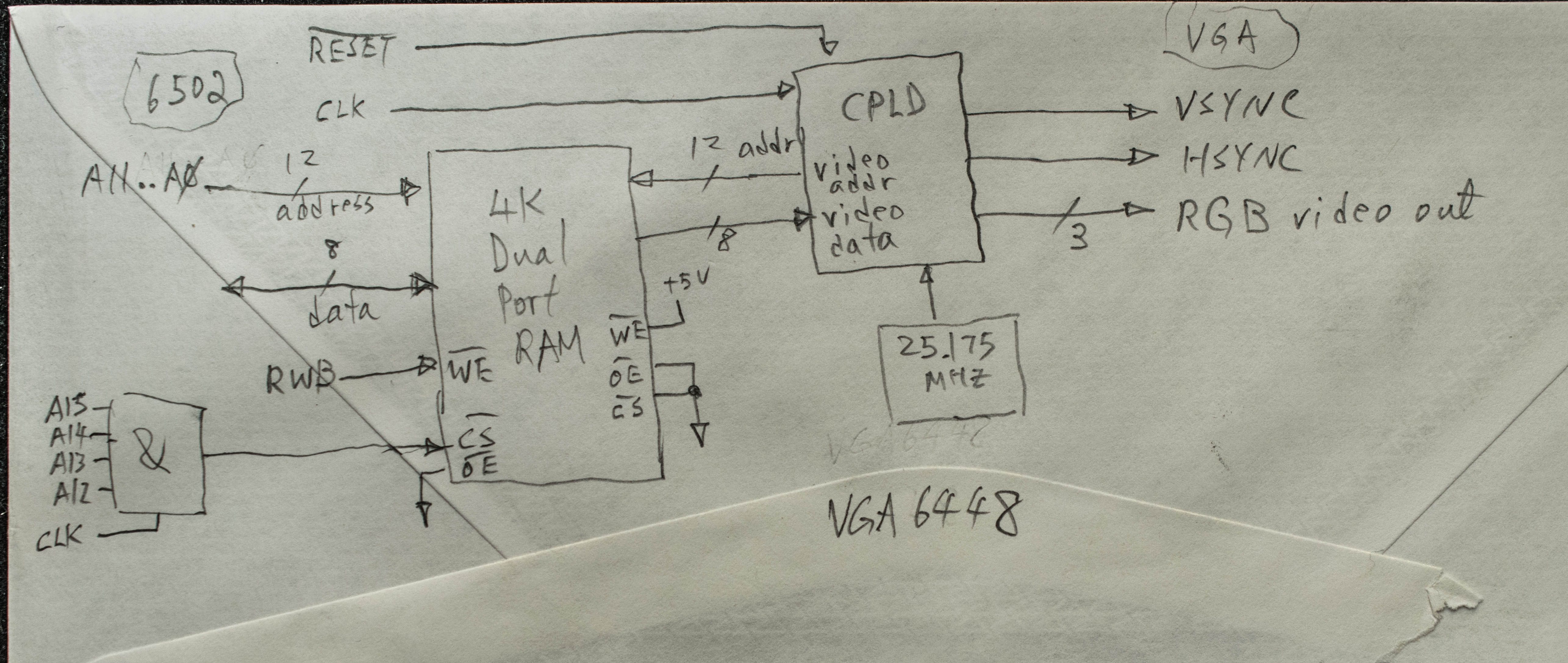

A light bulb went on half way into the design of proto65 v0.3; the text-based monochrome VGA logic is simple, really simple, so that it should fit in an ATF1504AS CPLD. With the help of a 4K dual port RAM, monochrome VGA with 64 columns x 48 lines of text should be possible.
Here is a back-of-envelope (literally) sketch. 6502 side of the dual port RAM is 4K read/write memory as decoded by address A15-A12 and clock. The video side of DPRAM is read-only and always enabled; it provides the font lookup table (1K-byte) and character memory (3K-byte) to the CPLD. CPLD has two cascaded counters, modulo-800 for horizontal line and modulo-525 for vertical. Horizontal sync is generated from modulo-800 counter and vertical sync is generated from modulo-525 counter.
The organization of character memory is 64 characters per line and 48 lines per frame for total of 64x48=3072 bytes. Address 0x0 corresponds to the first character of the first line (upper left corner of the display); address 0x40 is beginning of the second line, so on up until address 0xBFF as the last character of the 48th line (lower right corner of the display). Font table starts from address 0xC00 such that 0xC00-0xC07 are lookup tables for character value 0x0 and 0xFF8-0xFFF are lookup tables for character value 0x7F. Each character is represented by 8 bytes of font table.
A state machine in CPLD generates the addresses for dual port RAM starting from address 0x0; the value fetched is used to generate a font table address to lookup the font correspond to the fetch value. The font value is stuffed into a register and shifted out at 25.175MHz. The state machine generates addresses 0x0 to 0xBFF then inhibits video, generates the vertical sync then starts all over again.
This is a simple circuit, no hardware cursor, no hardware scroll, and monochrome. The prototype board contains 3 chips, 25.175MHz clock, IDT7134 dual port RAM, and ATF1504AS CPLD. $10 parts.

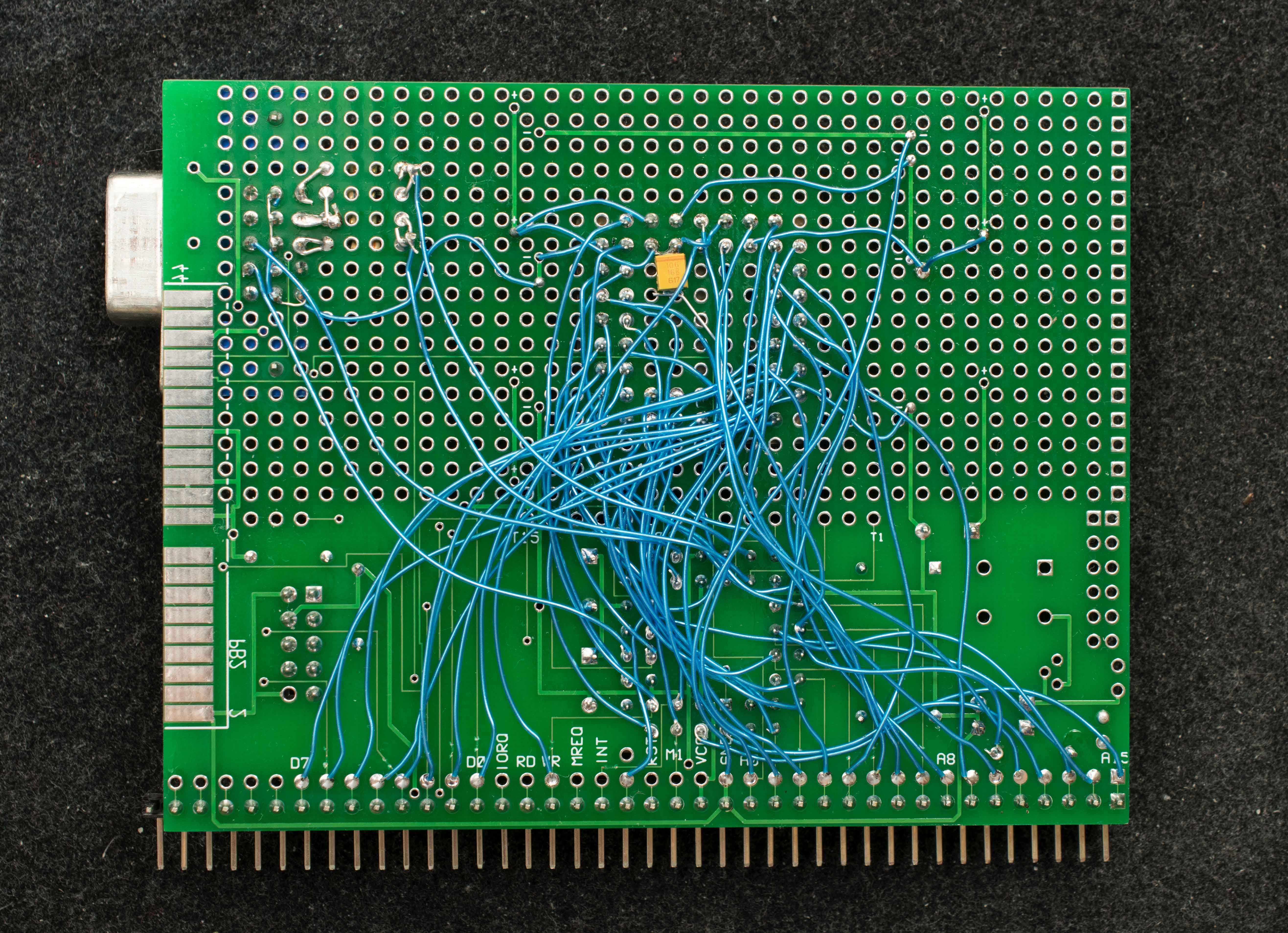

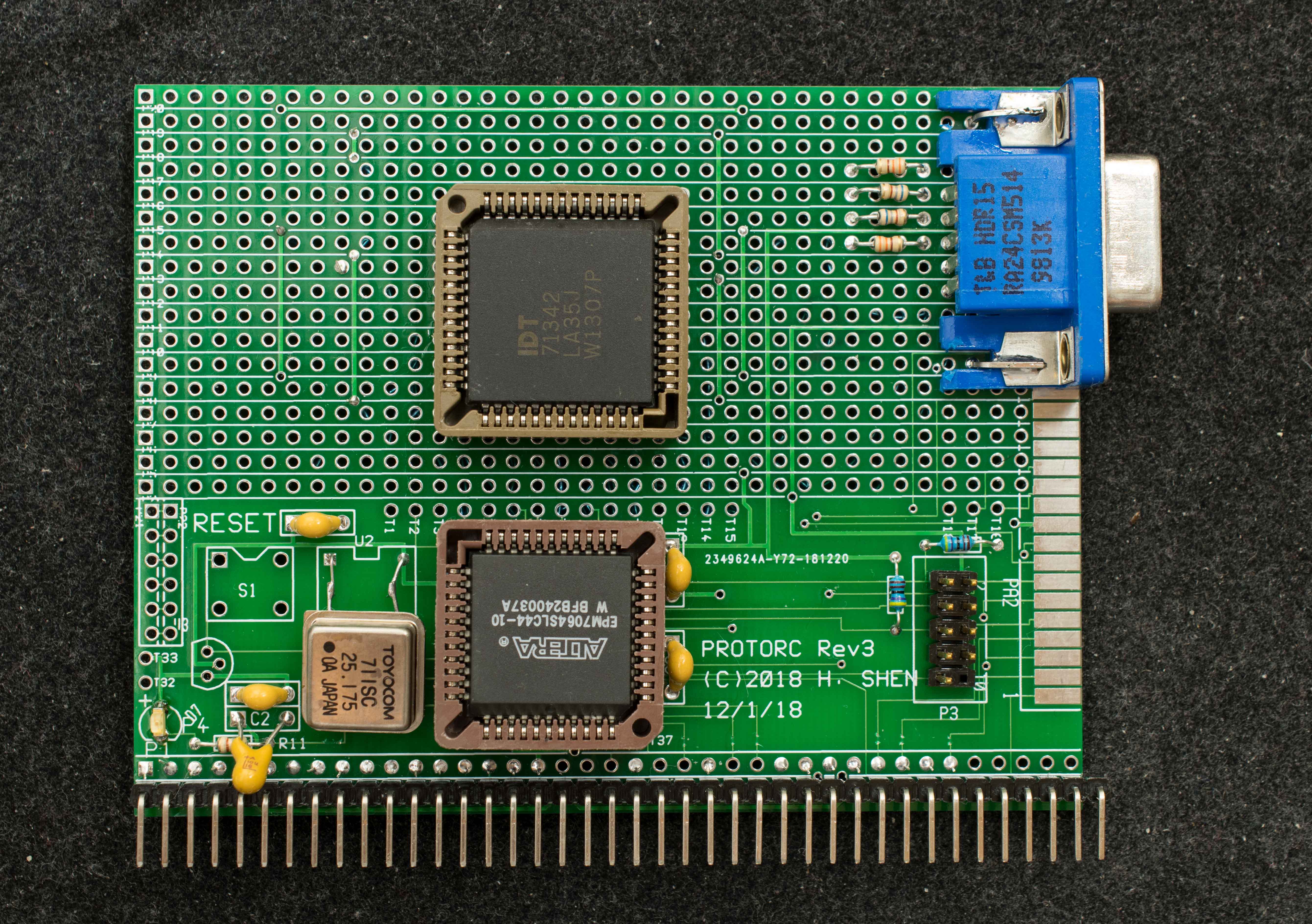

Here is the VGA6448 prototype board, all wired up and even smoke tested. So far so good. I only have 3 ATF1504AS but have plenty of EPM7064S, so for hardware development I will use EPM7064S; afterward I can convert .POF file to .JED file to program ATF1504AS.

great job. Just wondering how much work to support standard fast sram (10ns) instread of dualport sram.
PostPosted: Thu Feb 25, 2021 9:28 am
Posts: 197
Quite a bit.
The data and address busses need to be switched, and possibly latched depending on the relative speeds of the CPU and VGA clocks. Those external components need controlling by the CPLD, and that requires both pins and logic resources.
