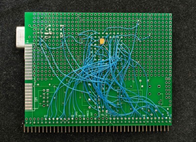

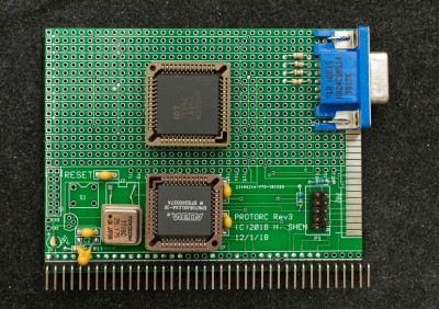

Here is the VGA6448 prototype board, all wired up and even smoke tested. So far so good. I only have 3 ATF1504AS but have plenty of EPM7064S, so for hardware development I will use EPM7064S; afterward I can convert .POF file to .JED file to program ATF1504AS.

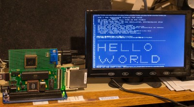

This is first cut of the VGA output from VGA6448. The CPLD design is not optimal, but it still fits within the 64-macrocell EPM7064S. PS2 keyboard function is not in the design because all CPLD I/O pins are in use. An external 74138 decode may free up sufficient pins to do PS2 keyboard function. VGA6448 design is fairly generic so can be easily adopted for other 8-bit microprocessors.
The left of the picture shows a 5-slot RC2014 backplane with CRC65 (6502 SBC) in the front and VGA6448 behind.
This is a 24-second YouTube video shows the "Matrix" screensaver running on CRC65+VGA6448. The ability to read/write video RAM directly at anytime simplifies the software significantly. The "Matrix" animation code is lesser than 256 bytes.
https://youtu.be/rQiBJkjPg44

PostPosted: Tue Feb 23, 2021 3:36 pm
Posts: 104
Location: Kelowna Canada
Looks good Bill, it would be nice to be able to add the PS2 keyboard interface for a standalone.

great job. Just wondering how much work to support standard fast sram (10ns) instread of dualport sram.
PostPosted: Thu Feb 25, 2021 9:28 am
Posts: 197
Quite a bit.
The data and address busses need to be switched, and possibly latched depending on the relative speeds of the CPU and VGA clocks. Those external components need controlling by the CPLD, and that requires both pins and logic resources.
