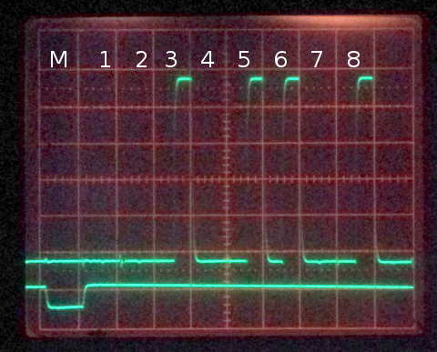

A new MPU has arrived and the JSR (ABS,X) problem has departed. Everything looks fine at the scope, the JSR "lands" spot on the intended target. The instruction is re-inserted where it was ment to be when all this trouble started and everything works perfectly!
Hopefully the computer will be OK now. Even if the JSR (ABS,X) is a very expendable instruction, having the problem present gave an iffy feeling. The hardware must be absolutely trustworthy when programming and magic effects pops up. Not a shadow of a doubt that it's the software that is in error.
I'm still very curious if the old MCU really is bad. I will do one more test with it. Hardwire the $FC opcode by eight resistors on a breadboard and see what happens. Will try to have that done in the next week, but no promises.
Any comments are highly appreciated.

Relatively surprising, but I think a conclusive result!

Your previous test was quite persuasive, but somehow I'm mildly surprised anyway by this latest result. You certainly seem to have proven there's a problem, but yes -- when you get time, please do the "$FC opcode with resistors" test and report back. (Ideally you should test *both* chips, just to "test the test".)
Also I wonder, is this a random error in the wafer that became your chip, or was there a design flaw that affected one or more entire batches of chips? Probably the former, but we'll never know... unless we can find an Erratum report, or a sibling Sanyo chip which can be tested.
Re: AIM-65 homebuilt semi-replica
(I would suspect a 'test escape' - a chip with a flaw, not picked up by the production test. One bad via, one leaky transistor, might be enough. There's also the possibility of a field failure, caused by contamination, metal migration, hot carrier injection, even crystal lattice defect...)

I will see if I can do the test ASAP and also test with a higher clock.
Did the old 800nm Sanyo contain dynamic circuitry?
I have searched quite a lot for errata, but turned out negative. The faulty chip has an uncommon(?) date stamp of 9906, but is bought directly from WDC around 2003 so it's 100% genuine.
