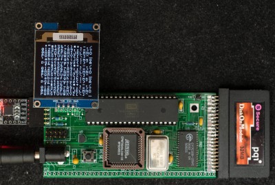

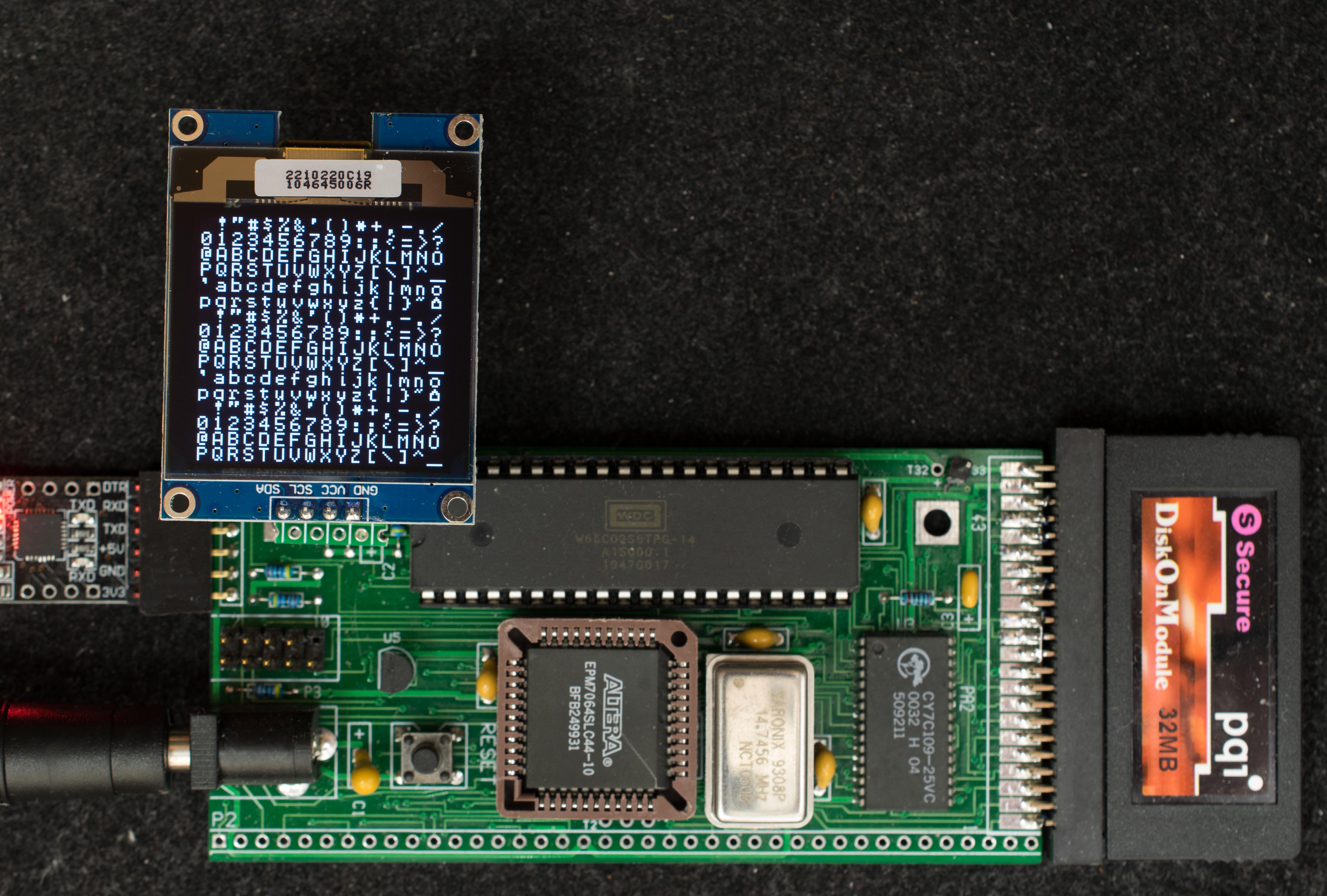

Bought few I2C 128x128 OLED with 16 grey levels to experiment with.
https://www.ebay.com/itm/3pcs-1-5inch-I ... 3696175425
It is a nice looking display that's 1.3 inch wide instead of 1" wide of the 128x64 OLED display. Unfortunately the pin assignments are different than the 128x64 OLED, so I have to build an adapter board to swap VCC and GND pins.
The display initialization routines are different than 128x64 OLED; after plowing through the SSD1327 datasheet and becoming frustrated with the large list of options, half of which I don't understand, I skipped all that and used the reset default values. It worked fine just with a command to turn on the display.
The display data format is also different; instead of 8 pixels per data byte, it is now 2 pixels per byte with 16 grey levels per pixel. The amount of data to fill a screen goes up by a factor of 8 (twice the screen resolution, and 4 times the data per pixel), so instead of 50mS to fill a 128x64 screen it now takes about 400mS to fill the screen. The screen fill is noticeable now.
The biggest hurdle I encountered was the interleaving of the screen; no where in the data sheet mentioned that. Once I've figured out that it fills every other lines when writing to the screen, everything works just fine.
