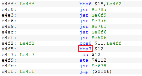

Hello, I think I may have found a small bug. I was disassembling this code, which is "65C02 with bit operations":
Address: $E4DD
6F 15 12 20 8A E7 20 F9 E6 20 AB E7 20 61 E7 20 F6 E0 20 06 E5 0F 11 0A F7 12 A5 12 8D 12 41 20 78 E6 6C 06 01
I get a BBS7 opcode where there should be an SMB7.
bbs7 should be smb7.png (9.96 KiB) Viewed 5782 times
$E4DD | 6F 15 12 | bbs6 $15,$E4F2
$E4E0 | 20 8A E7 | jsr $E78A
$E4E3 | 20 F9 E6 | jsr $E6F9
$E4E6 | 20 AB E7 | jsr $E7AB
$E4E9 | 20 61 E7 | jsr $E761
$E4EC | 20 F6 E0 | jsr $E0F6
$E4EF | 20 06 E5 | jsr $E506
$E4F2 | 0F 11 0A | bbs0 $11,$E4FF
$E4F5 | F7 12    | smb7 $12     ; <-- this one disassembled wrong
$E4F7 | A5 12    | lda $12
$E4F9 | 8D 12 41 | sta $4112
$E4FC | 20 78 E6 | jsr $E678
$E4FF | 6C 06 01 | jmp ($0106)
Also, when I load a saved file that using "65C02 with bit operations", it seems to always revert to normal 6502. I just wanted to let you know these things I found; I have worked around them no problem. Thanks for the cool disassembler.

Also, should the BBS instructions not be BBR instructions?
In my instruction tables, the msb of the Rockwell instructions indicates the polarity of the test or the set operation. I checked my tables against those in the Rockwell R65F1x processor family data sheet.
Michael A.

Referring to Eyes/Lichty:
0F to 7F is BBR0 to BBR7.
8F to FF is BBS0 to BBS7.
07 to 77 is RMB0 to RMB7.
87 to F7 is SMB0 to SMB7.
Posts: 3525
Re: WFDis - 6502/65C02 interactive disassembler
I have a Rockwell 'C02 datasheet that agrees with Eyes/Lichty as cited by Chromatix.
Oof, I had fixed the display of the bit operations above, but hadn't uploaded it because of other work also being done back then. They all ended up with a BBS name before. It's fixed in this new version.
HuC6280 CPU support added now, which is the 6502 derivative from the PC Engine/TurboGrafx-16. Besides a number of new instructions, it also maps zeropage to $20xx and stack to $21xx, necessitating some more flexibility in the CPU definitions.
