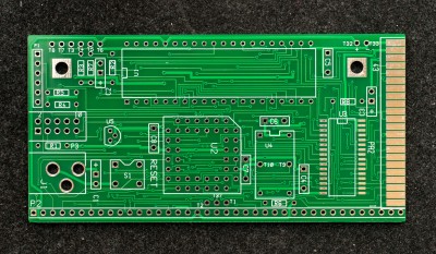

Finally received the pc board last evening. The pc boards are well made. It is a 2-layer 2"x4" board; the design rule is 7 mil trace and 7 mil space and 7 mil annular ring for via. JLCPCB pretty much hit the bull's eye as shown in the first picture.

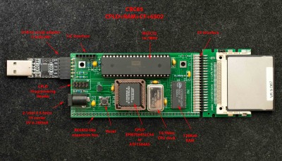

Build up two boards so I can experimenting. As built there are 223 solder joints so a board can easily be assembled under an hour. 2nd picture shows the finished board with major components annotated. The board in the picture is 8" long from tip of USB-serial adapter to end of CF disk.
They both work!
I'll update & finalize the CRC65 homepage. I'll be doing overclock experiments this weekend to find out its upper frequency limit.

very nice and clean pcb. I also use JLCPCB for my boards, they are really good and cheap.

Built up 5 CRC65 to make sure the design is producible. I'll need several for experimentation anyway. One is set aside as the reference design at the nominal 14.7MHz; another is for overclock experiment; another as tester for whatever 6502 acquired on eBay; and one for general experimentation.
All 5 boards have been tested to 22MHz and passed. The CPLD design is completely full so in order to run at 22MHz I need to remove the I2C functionality. Even with that, I believe the CF write access is marginal. It will intermittently failed the write test but CF read is working fine. The important point of 22MHz operation is to prove sufficient design margin of which I'm satisfied. Nevertheless, I believe it is possible to simplify the boot ROM and apply the freed resources to restore I2C functionality and fix the CF write issue. Something to work on...
The CPLD is Altera's EPM7064SLC44 which is obsoleted part. Atmel has a Altera-to-Atmel converter, POF2JED, which should convert the Altera programming file to program Atmel's equivalent (ATF1504AS) I will put out an order to Mouser for few ATF1504AS and an Atmel programmer so I can check out the file conversion.

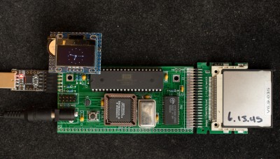

One of the boards will be the clock. I'll also find out how long a CRC65 can run continuously. The hand-wired RTC is not particularly accurate; it has gained about a minute since 9 days ago.
