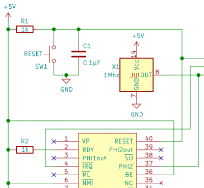

Make this to work is not rocket science. The fact that it sometimes works tells that it's likely correctly wired, but someting is marginal. The single display line with dark squares is typical for a non initialized 44780 and tells that the display module likely works. The need for power cycling to make it work also suggests it has to do with display initialization, as that's the only way to restart that process.
Those displays needs a power up sequence with some critical timing. Put back a little capacitor at the reset. Hold reset button closed when connecting power and then release it. Any result?
The processor must have ALL inputs. connected. Floating inputs gives unpredictable and variable results. If You don't knows how to connect them, then ask.
What oscillator frequency does You use? Do You have any slower available to try with, or f.ex. a 74??74 to bring it down?
Those Chinese LCD's on-chip oscillators has huge tolerances. Do You have any other display available to try with? Preferrably from a different manufacturer.
Do You have a logic pen? if not, get one. The E input of the display shall receive a pulse burst after every reset. Set the pen in pule stretch mode so it can indicate short events. Test PHI2 and random pins on the processor with the pen, are there activity?
Measuring f.ex. the address bus with a DMM will give different readings depending on the lines on/off ratio if rhe processor is running. A steady 0/5V on everything means something is bad.
Is the power good enough? That means not looking like a barb wire on a scope, 5.087454V on a DMM only tells the ADC is sensing that mean voltage.

Don't let this very minor problem drift away. Here in Sweden we hava a saying "to make a hen out of a feather"...
You most likely have a bad reset. to be good it must be one clean transition and not came too early.
The reasons for that are the display's intermal reset functions that take some time (a few tenths of milliseconds) and must be completed before Your computer starts to send it commands. Those commands also need to be consistent and not cut off at arbitrary times and repeated by a bouncy reset. That meshes up command and data the display receives. The processor itself also requires a couple of clean clocks before release of the reset.
Have You yet tried to hold reset button down whilest power is applied? Capacitor on reset is required.
Did You buy the display from Mr Eater so it's approved to work reliable with the software? I know nothing about him, is it a cut-and-try guy, or a proper designer reading datasheets and accounts for worst case conditions? There are, as said before, huge tolerances in the display's internal timing.
Do You have a W65C22S VIA? If its a ..22N or any NOS chip the IRQ line must have a pull-up resistor.
At least order a logic pen ASAP, it's an indispensible tool when experimenting with microprocessors like tha 65*. It's much more useful than a toy $29 single card "scope".

I have tried to hold the button, but still no change. Installed a pull-up resistor on the IRQ pin - no change. Measured all voltages - all OK.
Is this oscilloscopehttps://www.aliexpress.com/item/32973233356.html Going to help?.
I also noticed Ben doesn't have a capacitor on the reset switch or a resistor on the IRQ pin.

That is a toy, not a scope. Not recommended. With it's low sampling rate it will just show interferences between that and the signal You try to measure. In short, 100% pure crap.
Ali has locic probes, I have no idea about performance or build quality. F.ex. the one below. Just search logic probe. Unfortunately there comes up lots of cables and other "noise", but look it through and You will find.
https://www.aliexpress.com/item/3299019 ... web201603_
The schematic at the Ben Eater site has the reset capacitor.
The IRQ pull-up is not needed on WDC's 6522S VIA's as it has CMOS IRQ output. Their 6522N. or any old chip, has an open drain output that only can sink current and threfore needs the pull-up. Advantage is, many devices can be just paralleled, but don't let such stuff distract right now.
Have You tried to start the power supply first and close the +5V commection after the mains voltage has been applied? If the voltage ramps up too slow it might affect the display's power on reset circuits.
What is the software intended to do? I saw there are some buttons connected in the schematics. Are everyting around the pin's intended for those in order? Otherwise strange and unexpected things may happen, depending on the flash software. The shematic shows pull-ups. Are the floating and used by the program, there will be an issue.
