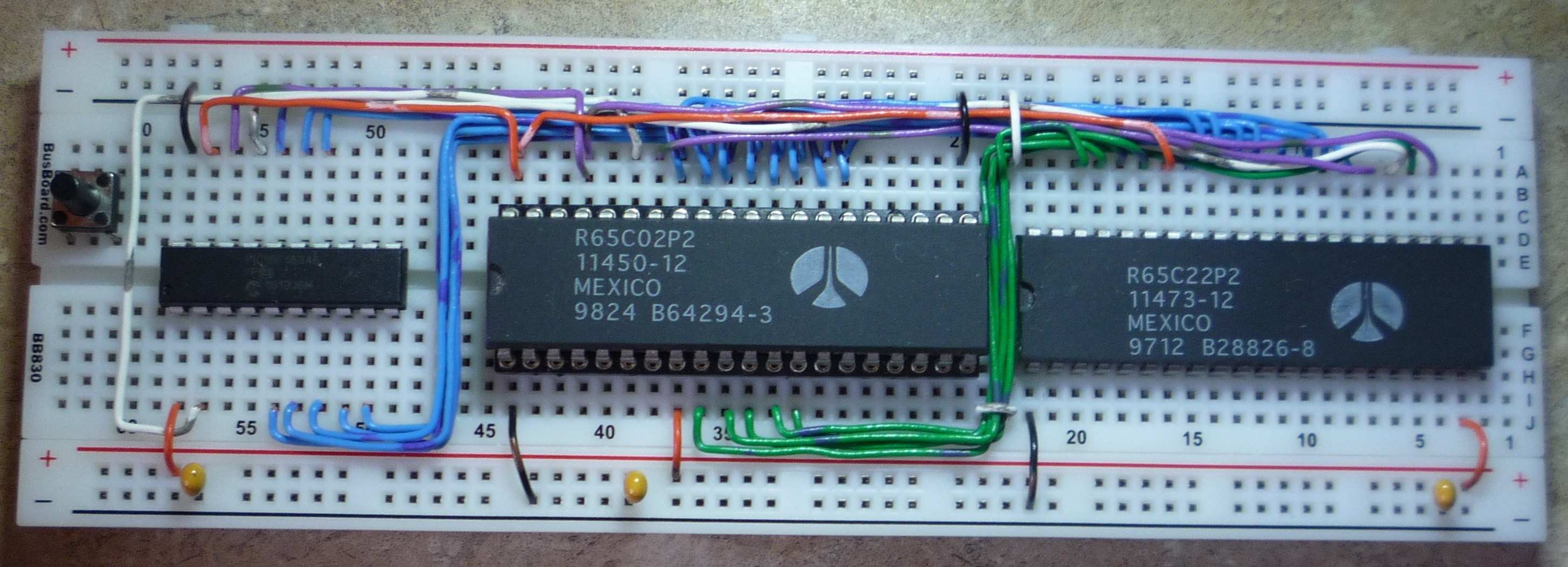

The wire from inside 50-pair telephone cable works very well on solderless breadboards...
Good luck and cheerful regards. Mike

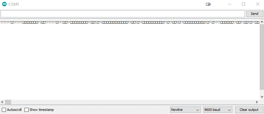

Ok, so while I'm working on the NOP with one chip (the old one,) I used the spare one I purchased to see if I could get any information from it via an Arduino (connected to the address pins,) once again following Ben Eater's video, I checked over my code 3 or 4 times, it compiled and when I turned on the serial monitor I got garbage instead of random binary numbers like he did.
There wasn't anything connected to his data pins, and if I remember the video right, he said it was performing a "No Operation" opcode.

...I used the spare one I purchased to see if I could get any information from it via an Arduino (connected to the address pins,) once again following Ben Eater's video, I checked over my code 3 or 4 times, it compiled and when I turned on the serial monitor I got garbage instead of random binary numbers like he did.
That looks suspiciously like what you get when your serial rate is incorrect; are you sure the program runs the Arduino side at 9600 bps?

Yes, the baud rate was wrong, stupid of me, the program even defines the rate I'm to use (57600,) I'll get a pic of the NOP of soon.
