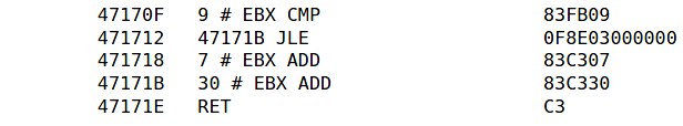

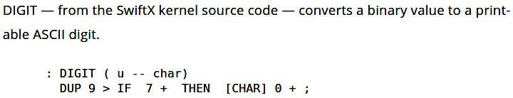

I am mostly writing from a standpoint of indirect-threaded code (ITC) or direct-threaded code (DTC) Forth. I have not worked with subroutine-threaded code (STC) Forth which is where basically everything is converted to machine language, and can be a really hot performer, especially if the compiler's optimizer is intelligent enough to understand your goal and rework the approach to the way that's best suited for how the particular microprocessor works. In that case, for highly complex processors, there's almost no point in doing your own sections of assembly language, because there'd nothing to be gained. I took the following from Forth Inc.'s website. Their SwiftForth optimizer takes the following Forth source code for the common Forth word DIGIT
and turns out this assembly language:
with fewer instructions in machine language than in the Forth version! No one has written this kind of thing for the 6502 or '816 though, probably because there's just not the market to justify the number of programming man-hours to make such a product for 65xx, and also because 65xx (especially '816) assembly language is simple enough to write by hand. My '816 version is hardly any longer.
