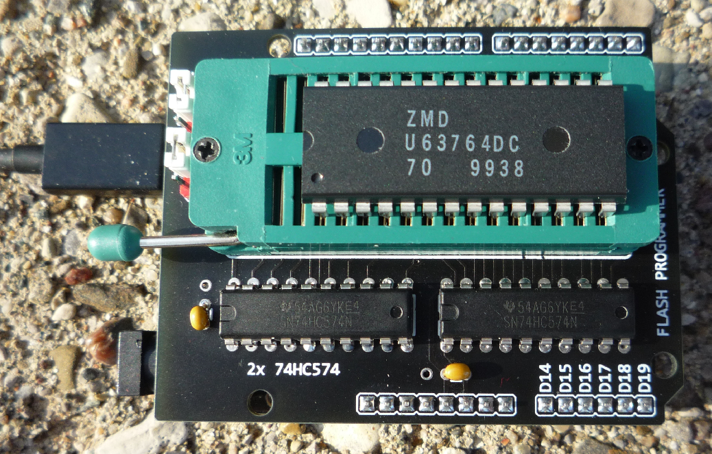

I ran across a small cache of "new old stock" 8Kx8 nvRAM chips that I thought were interesting in that they support unlimited reads and writes to RAM and they 'recall' and 'store' data to and from the RAM and EEPROM cells during power-up and power-down.
Stay safe. Happy Holidays and cheerful regards, Mike
