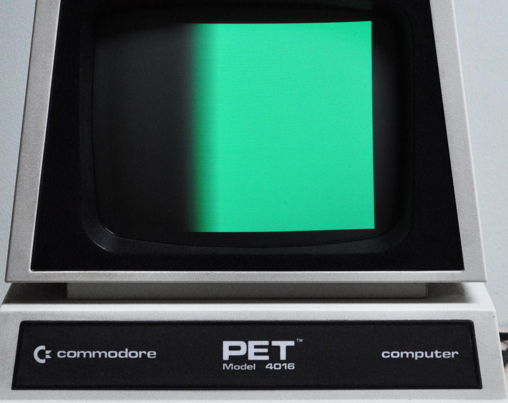

After some testing with various DAC amplifiers, I have determined that analog input into the PET Monitor is not very good.
The pattern should fade from black to full green, but instead transitions quickly at about 40 percent.
Fixing this would require changing the actual video drive circuitry, and I won't go that far.
So I guess if I do any kind of GFX board, it will be like the others... high resolution and single shade (digital).
I did test a 720 pixel dot map though, and this Monitor is certainly capable of displaying crisp pixels.
Might try a horizontal resolution of 1024 next, but for that I need a faster microcontroller!
One interesting thing I noted though is if I feed the original PET pixel stream back into the tapped point shown in the last photo, the resulting video is just as good, possibly a little sharper.
Knowing how Commodore would shave every single part from a board, I am surprised that they left 2 extra transistors and a bunch of other passives that seem to do nothing!

I think I can discern about seven different shades there, which is better than two, but might not have a favorable cost/benefit ratio.
PostPosted: Mon Aug 03, 2020 3:41 pm
Online
Posts: 10834
Indeed, I was thinking a suitable circuit could produce values in the sensitive range. Or indeed a suitable look up table ahead of a DAC with enough output levels.
I had the same thought, and I don't think you'd need anything fancy. Unless I'm missing something you could do the trick with just a resistor or two (or a trimpot) to attenuate the signal coming out of your DAC, then another resistor/trimpot to apply a suitable fixed, DC offset. Admittedly, you probably won't get 256 discernable shades. But, as Mike noted, you'd be better off than with just two.

You could add an analog gamma adjustment circuit after your DAC output, that may smooth out your gradients enough.
You could also use an op amp to change the output range of the DAC output so that the low and high map into the middle useful portion of the full voltage range you're using now
EDIT - the fuzzy edge part is going to be capacitance at the point you're injecting the signal right? So if you can put out a low impedance signal (a DAC probably won't do that, but an op amp would, but you'd need to be wary of oscillation driving a capacitive load) you should get crisper edges
