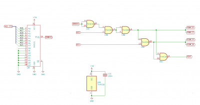

Currently I have RW qualified as
RW_PH2 = !(PH2 & !(RW))
I included it in the screenshots below.
Forgive me if you've already taken care of this; but I can't find the glue-logic info in the github pages (which is usual—I can never find what I want in github!).
Ah, yeah sorry my schematic needs a bit of tidying up. I've attached images of the bank logic, address decoding, and RW qualification below.
On the image in my first post, the board on the right is my working 65C02 computer and the left is the working-but-unstable 65C816 which matches the schematics currently in the GitHub.
schematic.pdf [293.56 KiB]
Downloaded 65 times

What's the total gate delay from A16...23 to the RAM and IO chip enables? It looks awfully long; but if you're really running only 2.28MHz, the processor's maximum tADS of 30ns plus the VIA's tACR of 10ns should leave you with 180ns for that long chain of glue logic, which should be totally fine.
Yeah, that is something I should probably check going forward. With my particular setup, the computer needs to run synchronously to the Arduino. 2.28MHz is as fast as I can make the Arduino go without losing any of the auxiliary functionality (serial, RNG, etc).
So far I've only tested the computer in emulation mode, which if my understanding is right, should leave BANK0 low permanently as the 65C816 should just send out 0 as the bank address. But, the 74HC573 briefly latches an invalid value which causes the 74F521 to briefly switch BANK0 to high.
Do you think there's an issue tying the #CE and #OE pins together like I've done? Or should I try and qualify it like WDC did? I suppose I'm not understanding why WDC is qualifying #OE against PHI2, but their schematic is a bit hard to follow.

You have Phi1 (to the bank address latch) delayed one gate from Phi2, and the latch itself takes about another gate delay to actually close its inputs. One gate in 74HC is about 15ns, which is actually longer than the W65C816S' bank address hold time after the Phi2 rising edge (10ns) - and you have two gate delays in series to worry about here.
So you have approximately 20ns of timing violation during write cycles, and possibly at other times. That could easily explain the latch getting the wrong value occasionally. See my glue logic examples above for a better way to handle this.
Huh... well shoot. That gating was actually something I tried to copy from WDC's SBC exactly as-is. I figured it would work without looking much into it.

Alas, WDC documentation is known to contain random errors, and one of their commercially sold reference SBCs was recently found to use a CD4000-series chip that didn't have a hope of meeting timing at the stock clock speed, but worked okay as long as you never left Bank 0.
After deciding that the logic shown in the '816 datasheet was worthless for novice SBC builders, I worked out the above from first principles. I really should get some parts and try it out for real…
