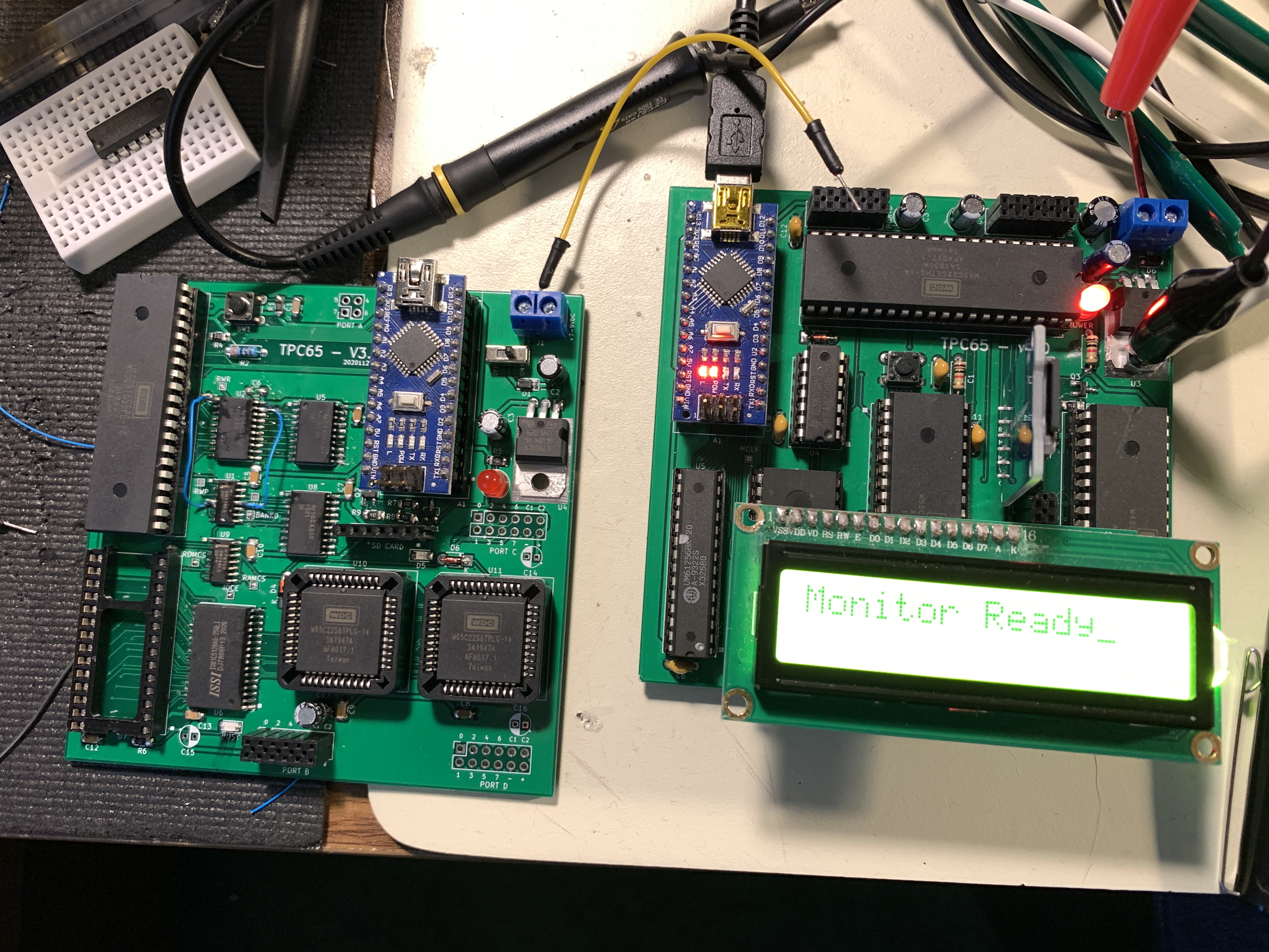

Hi everyone. Long time lurker, first time poster here.
I've been trying to design a 65C816 computer for a while now and I'm running into some issues that I think go beyond a mistaken connection. I've sent two versions of this computer in for fabrication. The first board didn't work at all. The second board does work, but is unstable under certain conditions. Anyways, I'm starting to think my ideas on the glue logic and address decoding is flawed. For example, if I upload a program to RAM that will never use the EEPROM, it will still activate the EEPROM (briefly). So, running programs within the RAM tends to be unstable.
Here's the link to the full KiCAD project: https://github.com/halfburnttoast/TPC65_V3
For the most part, I'm taking it right from the 65C816's datasheet, using a HC573 and HC245 to latch the bank address. One mistake I did make was to use two 74ALS00's instead of 74HC00's. I don't remember why I went with ALS chips, but I know now that the ALS->HC interface is incompatible and could be a source of the instability.

To detect BANK0, I'm using a 74F521. But, I'm noticing on the oscilloscope that BANK0 is toggling even when running in emulation mode, which shouldn't happen. The HC573 is briefly latching an invalid value from the databus which, I'm suspecting, is related to it being driven by a ALS00. But, I'm not sure where the primary source of instability is coming from or if it's a constellation of instability.
So, rather than continue burning money on non-working boards, I'd like to see if there are glaring problems with my glue logic. From what I can tell, a lot of people who use the 65C816 use CPLDs as glue logic, but there aren't as many examples of jellybean logic gates, so I've mostly been taking notes from WDC's board. The clock source and serial interface is an Arduino Nano, which I've optimized to put out about a 2.28MHz clock signal. Any help would be appreciated! I can provide more details if needed.
File comment: On right, my working 65C02 design. On left, working but unstable 65C816 board.

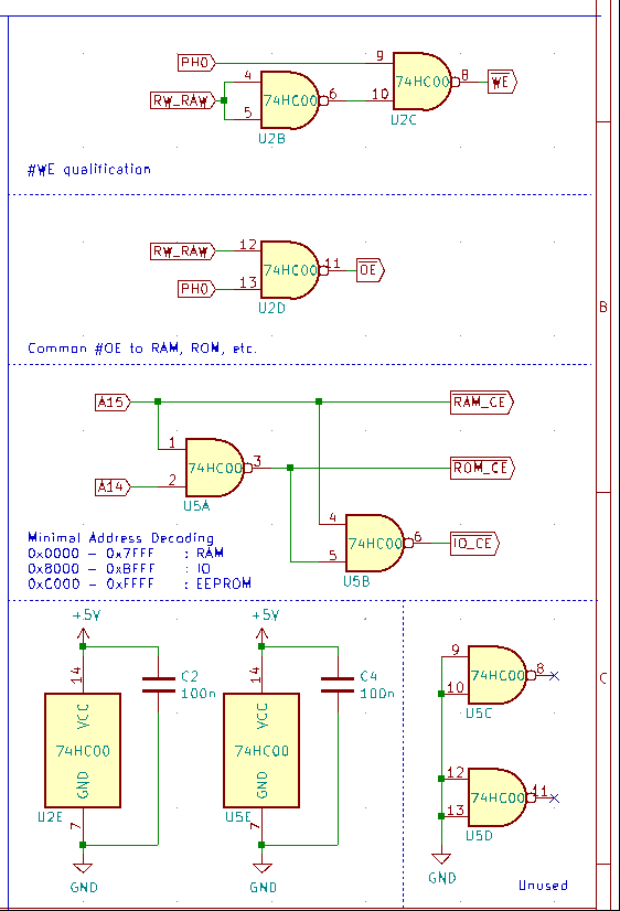

Make sure there is no way to write to RAM when phase 2 is low. Looking at the timing diagrams in the data sheet, you will see that the address lines are not guaranteed to be valid and stable before the R/W goes low; so it is possible to write to unintended addresses. This information is in the 6502 primer which is about building your own 6502 computer but has a lot of pages that apply equally as well to computers using other processors.
Forgive me if you've already taken care of this; but I can't find the glue-logic info in the github pages (which is usual—I can never find what I want in github!).
Currently I have RW qualified as
RW_PH2 = !(PH2 & !(RW))
I included it in the screenshots below.
Ah, yeah sorry my schematic needs a bit of tidying up. I've attached images of the bank logic, address decoding, and RW qualification below.

What's the total gate delay from A16...23 to the RAM and IO chip enables? It looks awfully long; but if you're really running only 2.28MHz, the processor's maximum tADS of 30ns plus the VIA's tACR of 10ns should leave you with 180ns for that long chain of glue logic, which should be totally fine.
The only apparent schematics I found were some kind of text files which I guess is how KiCAD stores schematics, and I don't have KiCAD, so I never saw any images.
Thanks. That helps.

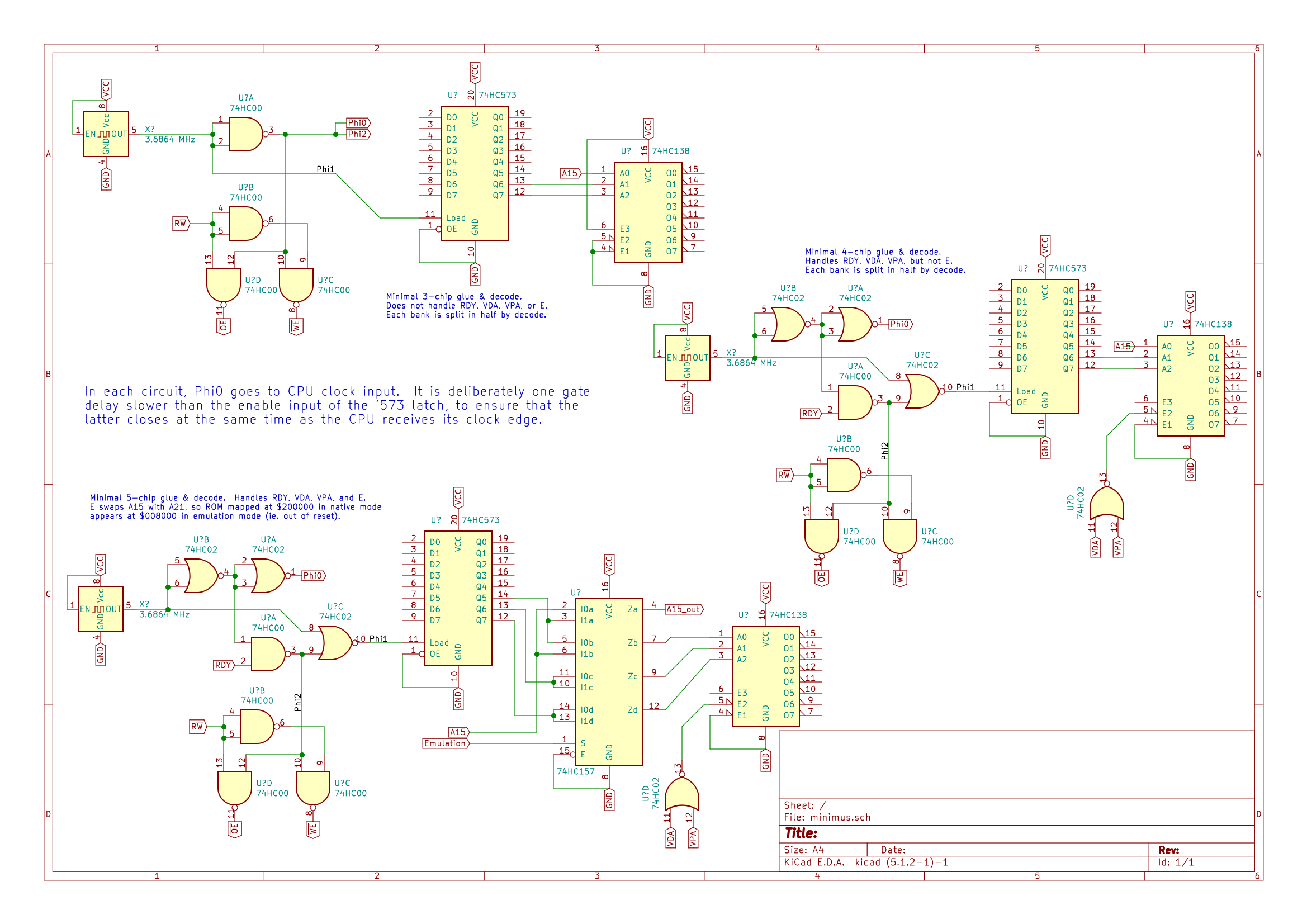

I'll repost here my 3, 4, and 5-chip glue logic examples for '816 systems. They haven't been battle tested, but they do follow sound principles and should work, at least at modest clock speeds (and probably faster ones too, if 74HC is substituted for a faster family). Feel free to substitute your own address decoding, but pay attention to the principles embodied.
The 3-chip design is really minimal, incorporating only the bank address latch additionally to a minimal 65C02 glue logic. A quad 2-NAND generates /OE, /WE, Phi0+2, and the bank latch trigger (Phi1) from the master oscillator. Note carefully that Phi0 (input to the CPU) and Phi2 (to qualify the R/W signals) are one gate delayed from Phi1 - this matches the reaction time delay of the latch itself, so the latter closes its input before the CPU has time to change them (on write cycles, where address integrity is of greatest importance). The third chip is the simplest decoding that puts both ROM and RAM in the appropriate parts of Bank 0; I/O devices are expected to be mapped to a high bank.
The 4-chip design adds a quad 2-NOR to handle RDY, VDA and VPA correctly. Note that Phi0 and Phi2 are now distinct signals, the latter (and Phi1) being qualified by RDY. VDA and VPA are simply used to gate the address decoder, which is otherwise identical to the above. Memory and I/O devices normally ignore /OE and /WE (and adopt their lowest power mode) when their /CE is deasserted.
The 5-chip design changes the decoder so that Bank 0 becomes entirely RAM when the CPU switches to Native mode (ie. the E signal output goes low) but is still half ROM when in Emulation mode, which the '816 boots up in. The glue logic remains the same.
Note that none of the above include a bus transceiver. You only need one of those to isolate the bank address (driven from the CPU during Phi1) from devices that use Phi1 for DMA on the same bus (eg. the traditional CRTC setup). DMA is an advanced topic that you probably shouldn't tackle until you have a basic non-DMA system running reliably.
I strongly prefer to put I/O in a high bank rather than Bank 0. This greatly reduces the need to treat Bank 0 specially on decode, and also reduces address space pressure on the only bank that can contain Direct Page, the CPU stack, and the interrupt vectors. Bank $FF can be identified using a 74HC30 (8-NAND), or any single bank can be identified using a 74HC688 (8-bit equality comparator) - so you don't have to resort to old TTL devices from the 74F family, which may have compatibility problems with devices expecting CMOS input levels.
Yeah, that is something I should probably check going forward. With my particular setup, the computer needs to run synchronously to the Arduino. 2.28MHz is as fast as I can make the Arduino go without losing any of the auxiliary functionality (serial, RNG, etc).
So far I've only tested the computer in emulation mode, which if my understanding is right, should leave BANK0 low permanently as the 65C816 should just send out 0 as the bank address. But, the 74HC573 briefly latches an invalid value which causes the 74F521 to briefly switch BANK0 to high.
Do you think there's an issue tying the #CE and #OE pins together like I've done? Or should I try and qualify it like WDC did? I suppose I'm not understanding why WDC is qualifying #OE against PHI2, but their schematic is a bit hard to follow.

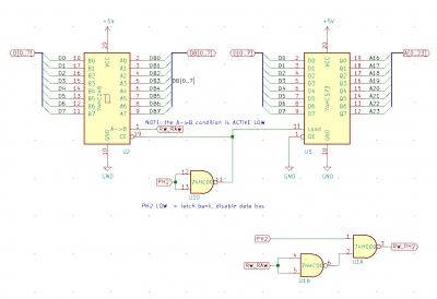

PostPosted: Sat Dec 05, 2020 1:36 am
You have Phi1 (to the bank address latch) delayed one gate from Phi2, and the latch itself takes about another gate delay to actually close its inputs. One gate in 74HC is about 15ns, which is actually longer than the W65C816S' bank address hold time after the Phi2 rising edge (10ns) - and you have two gate delays in series to worry about here.
So you have approximately 20ns of timing violation during write cycles, and possibly at other times. That could easily explain the latch getting the wrong value occasionally. See my glue logic examples above for a better way to handle this.
Wow, thanks for posting that. I'll need to study it when I'm not so tired :mrgreen: .
Pretty much, I was following WDC's design straight out of the datasheet. Now that you mention it, the bus transceiver makes more sense now (and possibly WDC's #OE qualification). Guess DMA never crossed my mind, I was more interested in getting a working system.
The main reason I'm keeping the memory map like that is it's the same as the 65C02 computer I made. I wanted it to be fully backwards compatible with the computer next to it. To the point where I was just literally taking the ROM chip out of one and putting it into the 816's socket and running it. It does run, it just has this latent instability that's a real thorn to track down.
Huh... well shoot. That gating was actually something I tried to copy from WDC's SBC exactly as-is. I figured it would work without looking much into it.
But, I've read on here that design isn't the greatest either.
PostPosted: Sat Dec 05, 2020 1:52 am
Alas, WDC documentation is known to contain random errors, and one of their commercially sold reference SBCs was recently found to use a CD4000-series chip that didn't have a hope of meeting timing at the stock clock speed, but worked okay as long as you never left Bank 0.
After deciding that the logic shown in the '816 datasheet was worthless for novice SBC builders, I worked out the above from first principles. I really should get some parts and try it out for real…
