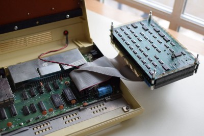

Re: 100MHz TTL 6502: Here we go!
Drass wrote:
It will be much too big! The CPU might as well have it’s own carrying case.
Drass wrote:
It will connect to the host through a ribbon cable as shown in the pic of the C74-6502 below.
Drass wrote:
Yeah, I know! It’s hard to fathom just how deliriously impractical this is!
