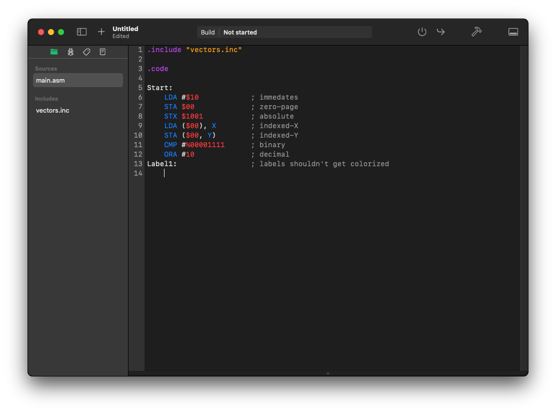

I know this post is pretty ancient but I've been building a full 65C02 IDE for macOS and recently tackled this very problem. Numbers were the most annoying so I thought I'd share my solution (though my stylistic choices might bother some or all of you) but you can tailor it a bit to your liking. I've included a screenshot that illustrates most of the relevant numerical situations that have arisen for me with comments describing them.
Here are the regexes I use for the various types of numbers in Swift.
        // bc i know i will forget this, the following use look-behind `(?<=[asdf])` and look-ahead `(?=[asdf])`
        let hexNumberGenerator = regexGenerator("(?<=[\\s(#])\\$[[:xdigit:]]+(?=[\\s),])", tokenType: .number)
        let binNumberGenerator = regexGenerator("(?<=[\\s(#])\\%[01_]*(?=[\\s),])", tokenType: .number)
        let decNumberGenerator = regexGenerator("(?<=[\\s(#])[[:digit:]]+(?=[\\s),])", tokenType: .number)
Hope this help someone tidy up their IDE of choice.
I don't see any mnemonics in that source code display.
PostPosted: Mon Nov 30, 2020 6:32 pm
Seems like you and I are both grumpy today BDD. Allow me to translate: BDD has vision problems, and prefers that people post high contrast monochrome images.
Edit: I do apologise for this outburst. There is indeed a potential accessibility problem with low contrast images, and a polite request to post a higher contrast version would not be out of place.
