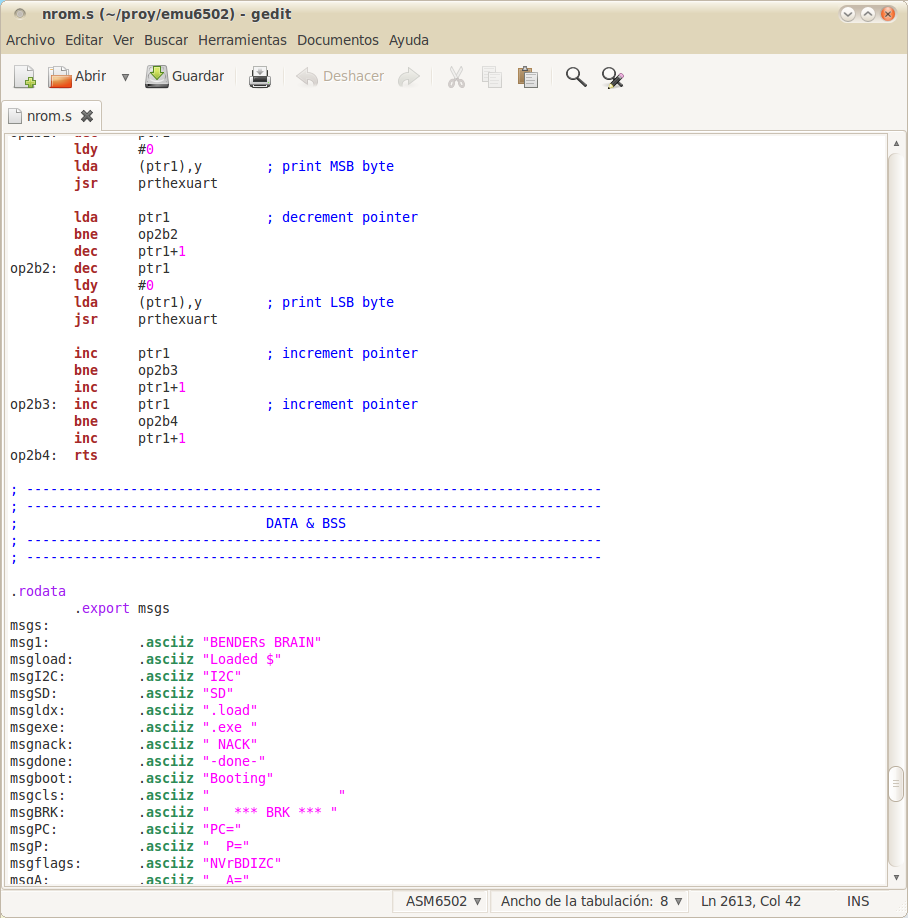

Hi,
Does anobody here know a syntax highlighting editor for the 6502 assembler? I'm trying to use gedit with the following language-specs file:
http://www.ele.uva.es/~jesus/6502/asm6502.lang
I modiffied this file from another example, but the results aren't satisfactory yet. The main problem is the rule set for hex. and binary numbers. It would be also interesting to have a different style for labels, directives and immediate operands. But, I must admit I don´t know much about regex...
This file has to be copied to the following directory:
/usr/share/gtksourceview-2.0/language-specs
Then select: "View -> Syntax Highlight -> Other -> ASM6502" on the gedit menus (english names for menus can be different. I got them in spanish). Here is how it looks:

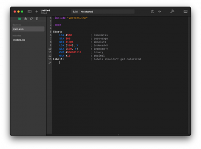

I know this post is pretty ancient but I've been building a full 65C02 IDE for macOS and recently tackled this very problem. Numbers were the most annoying so I thought I'd share my solution (though my stylistic choices might bother some or all of you) but you can tailor it a bit to your liking. I've included a screenshot that illustrates most of the relevant numerical situations that have arisen for me with comments describing them.
Here are the regexes I use for the various types of numbers in Swift.
Hope this help someone tidy up their IDE of choice.
// bc i know i will forget this, the following use look-behind `(?<=[asdf])` and look-ahead `(?=[asdf])`
let hexNumberGenerator = regexGenerator("(?<=[\\s(#])\\$[[:xdigit:]]+(?=[\\s),])", tokenType: .number)
let binNumberGenerator = regexGenerator("(?<=[\\s(#])\\%[01_]*(?=[\\s),])", tokenType: .number)
let decNumberGenerator = regexGenerator("(?<=[\\s(#])[[:digit:]]+(?=[\\s),])", tokenType: .number)
